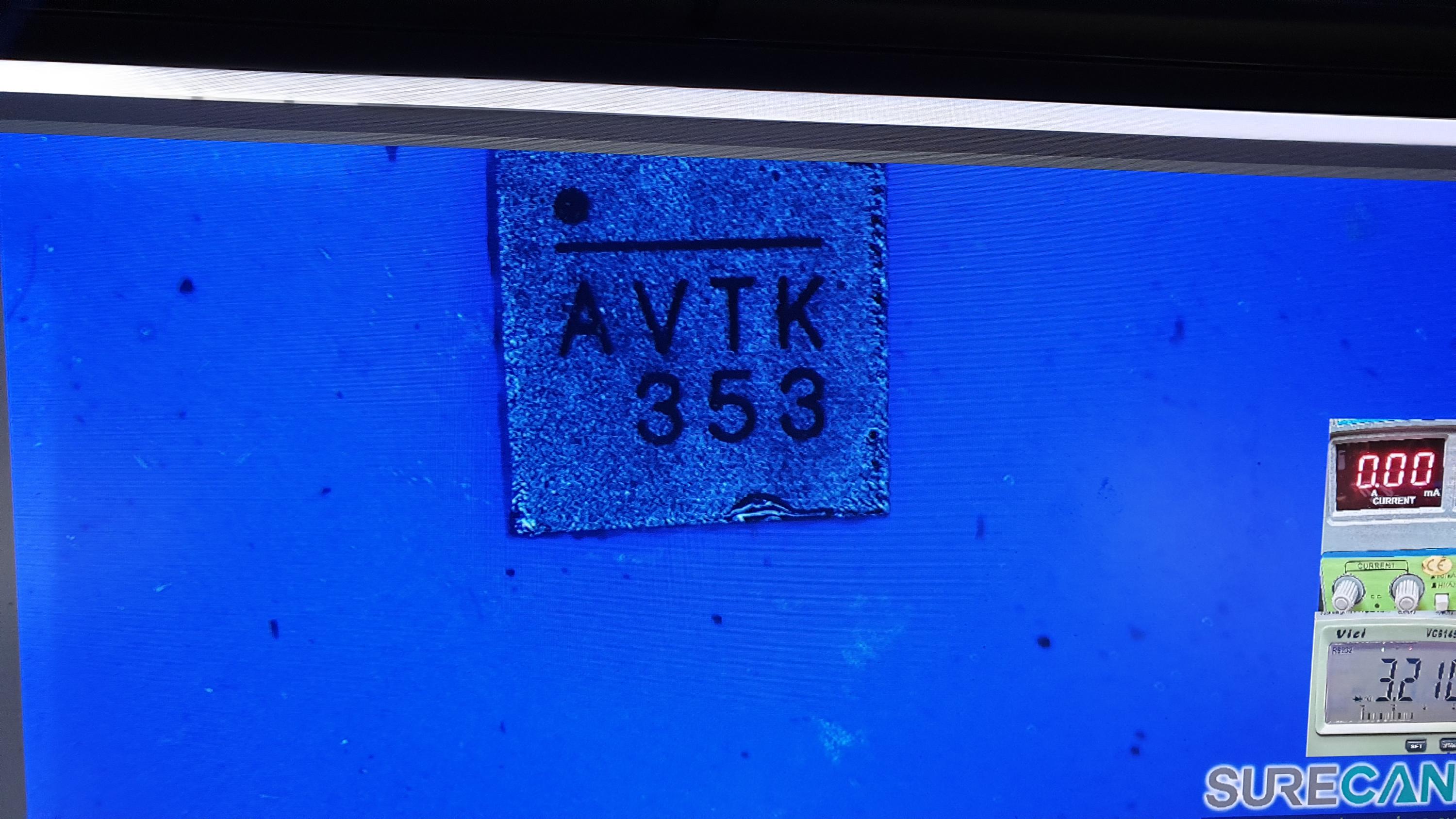

Identify Component AVTK 353 RAM Power

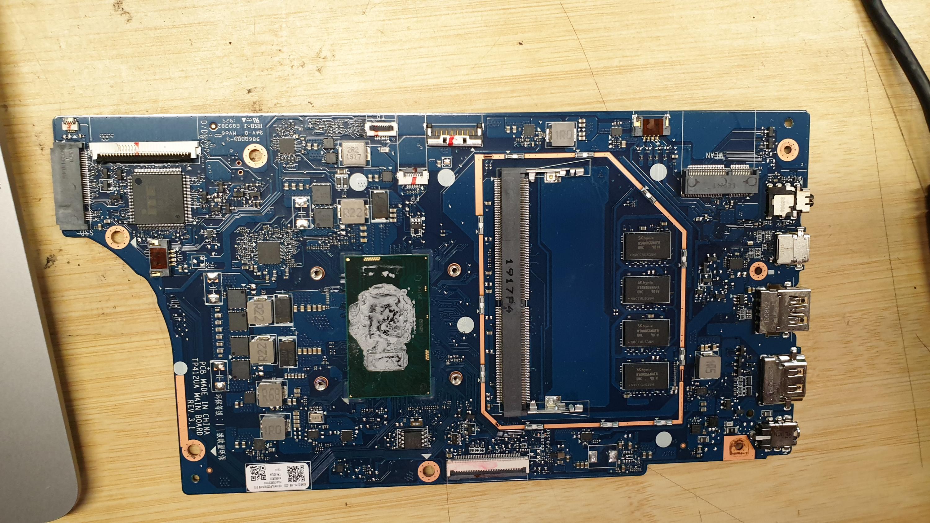

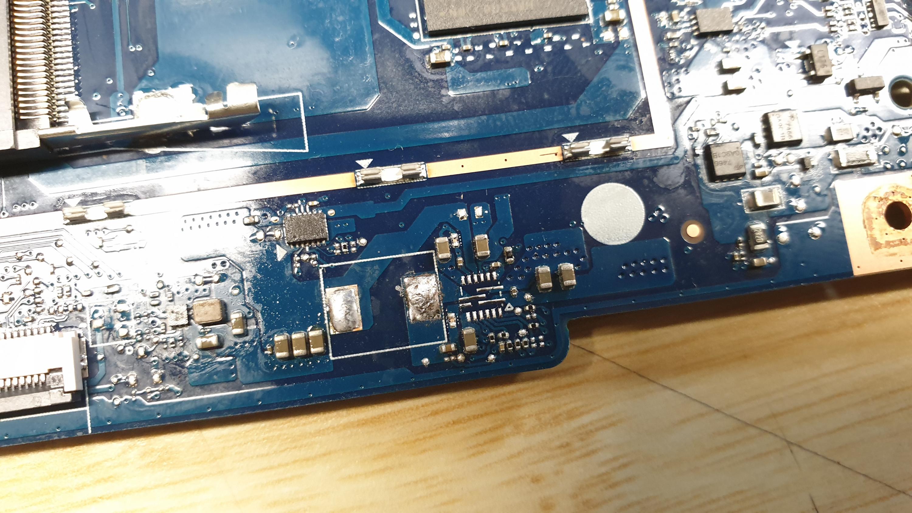

    Laptop Model TP412UA Rev 3.1

    Re: Identify Component AVTK 353 RAM Power
    Another user was looking for the same component his one identified as:
    ALTJ 368
      This is the closest I got so far
      nb671gq
        Found it
        PowerIC, MPS NB685GQ
