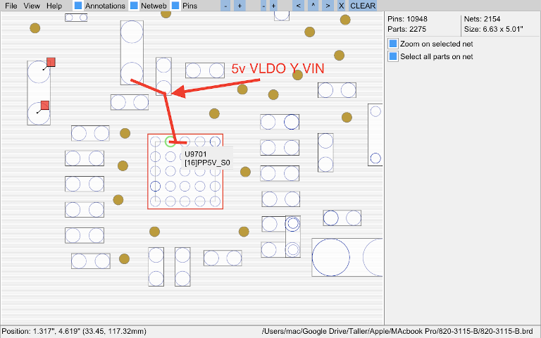

Macbook pro A1278 Reparando Backlight
  • V1ctorJ1menez
    • Apr 2020
    • 3
    • México
    Macbook pro A1278 Reparando Backlight
    I found a backlight problem, look at the screen of the A1278 model 2012, the motherboard is 820-3115-B and notice that if there was a background image without light, I always find these problems sometimes cause me a lot of problem, but today I have solved it with simple measurements that I want to share, the first thing to check is that the Diode D9701 It will work normally with a high voltage that must be close to 25v well here I found 20v, with that I assumed that the PPVOUT_SW_LCDBKLT line was correct, now I went to IC U9701 and I asked myself a question, what is the reason that the circuit does not send the signal to turn on the backlight, I measured the voltage input VLDO and VIN and there was the power , Take a good look at the iC and proceeded to measure the activation BKL_EN and in this there is a voltage divider , He checked at the input of the divider and there was no voltage that feeds the divider, the voltage must be 12v for it to work and the IC U9701 is activated, this line comes from a Q9706 mosfet, this mosfet does the job of feeding the divider BKL_EN and notice that the voltage oscillates, there I was already sure that the culprit was nearby, Probe on the other side of the mosfet where it is fed and there was the voltage that is 12v, but the activation of this mosfet makes it the same as a divider of R9789 and R9788 voltage but in R9789 it was at zero when the equipment was turned on, and that tells me that the divider is activated correctly, but that one of the resistances is varying or has a resistance with a different value, well we measure the divider and change the resistors for more exact ones, the problem persists, it cannot be the Q9707 mosfet that activates this divider because the activation signal of the divider must be zero and this is how they are measured in the pr Check in zeros, well I leave it and go to the Q9706 mosfet and assume the following, the gate must be less than the source for it to activate, because the divider that activates it is working correctly, I fully assume that The mosfet is shorted and it passes the 12v from source to door and that is why it never activates since the mosfet is short, good to clarify doubts I remove the Q9706 mosfet and try again the divider that activates it without the Q9706 mosfet and yes It is like this the divider is working in a normal way and with that the Q9706 mosfet is damaged, simply replaced it and the equipment turns on again normally. Other cases have happened to me in this circuit, I would like you to share it with me to continue learning new things. The only tools I used were the multimeter and a heat station.
    Last edited by SMDFlea; 05-07-2021, 01:48 AM.
  • Jane
    How do you test MOSFET in laptops ?
    by Jane
    I tried to use this method:
    Testing an N-channel MOSFET:
    Step 1: Discharge the Gate (turn off the MOSFET)
    Place the black probe (COM) on the Source (S) and the red probe on the Drain (D). The multimeter should show no continuity (high resistance or "OL" – open line).
    Then, touch the black probe to the Source (S) and the red probe to the Gate (G). This discharges any stored charge in the Gate, turning the MOSFET off.
    Step 2: Charge the Gate (turn on the MOSFET)
    Now, place the red probe on the Gate (G) and the black probe on the
    09-27-2024, 03:31 AM
  • Nooy
    VGA MOSfet permanently shorted and loss of MOSfet pad
    by Nooy
    Hello everyone, I recently found this badcaps site and super Learn Electronics Repair youtube channel. And I wanted to learn how to troubleshoot power supplies and VGA cards and how to practice soldering, since I already have a properly defective piece of them. I am currently trying to solve two problems:
    I have a Gigabyte GV-RX460WF2OC-4GD type card. I managed to find the faulty MOSfet (AON6414A) on it, which I replaced. The card starts up, but after about half a minute, the MOSfet in the same position will be shorted again. Is it possible that the PWM controller driving the MOSfet...
    02-14-2024, 02:26 AM
  • AppleLover123
    Asus X712EA 3 volts after the first mosfet
    by AppleLover123
    Hey guys,
    i have a asus motherboard here and as the title says after the first mosfet (in the picture) there is nothing more than 3.15v.
    I injected 19v and max. 1 amp at the charging port and there is not voltage drop or smth. It's just taking 19v and 1 milliamp.
    Then i tried to inject 19v and max 1amp after the current sensor and there it first takes 19v and 4 milliamps and after 2 seconds it is taking nothing (no current).
    I measured on the coils on board everything seems fine. Also the main power rail is not shorted (infinite resistance).
    Now i thought something...
    12-15-2024, 07:49 AM
  • MicroSMD Lab
    ASUS ROG Zephyrus GPU Mosfet repeat failure
    by MicroSMD Lab
    The board number is GU502DU. I repaired this a couple weeks ago and it came back with the same issue, same mosfet failed (PQH9201). I'm hoping that the GPU was spared this time.
    I used the same replacement part (purchased from Mouser) and I'm certain the soldering was done properly since it took just as much effort to remove as before. What could cause this same mosfet to fail? I'm thinking if it was unsuitable then the others would fail too. I looked for similar failures on YTube and the mosfet was replaced with AOE6930 in one instance and AOE6932 in the other but it's possible that the...
    01-10-2024, 06:36 AM
  • Scotchmist
    Asus GA502D keeps blowing mosfet
    by Scotchmist
    I have an Asus GA502D, it had a blown mosfet which I replaced and the laptop booted into windows, a few mins later it shut off, the same mosfet was blown. I thought maybe just a bad mosfet but same thing happened again, a few mins in windows and shuts off.
    I have removed the mosfet and can run the laptop no problem
    The MOSFET is FDPC5018SG
    Can anyone point me in the direction of what could be the cause of this, could it be the controller rt3663bc?
    08-24-2024, 02:23 PM
