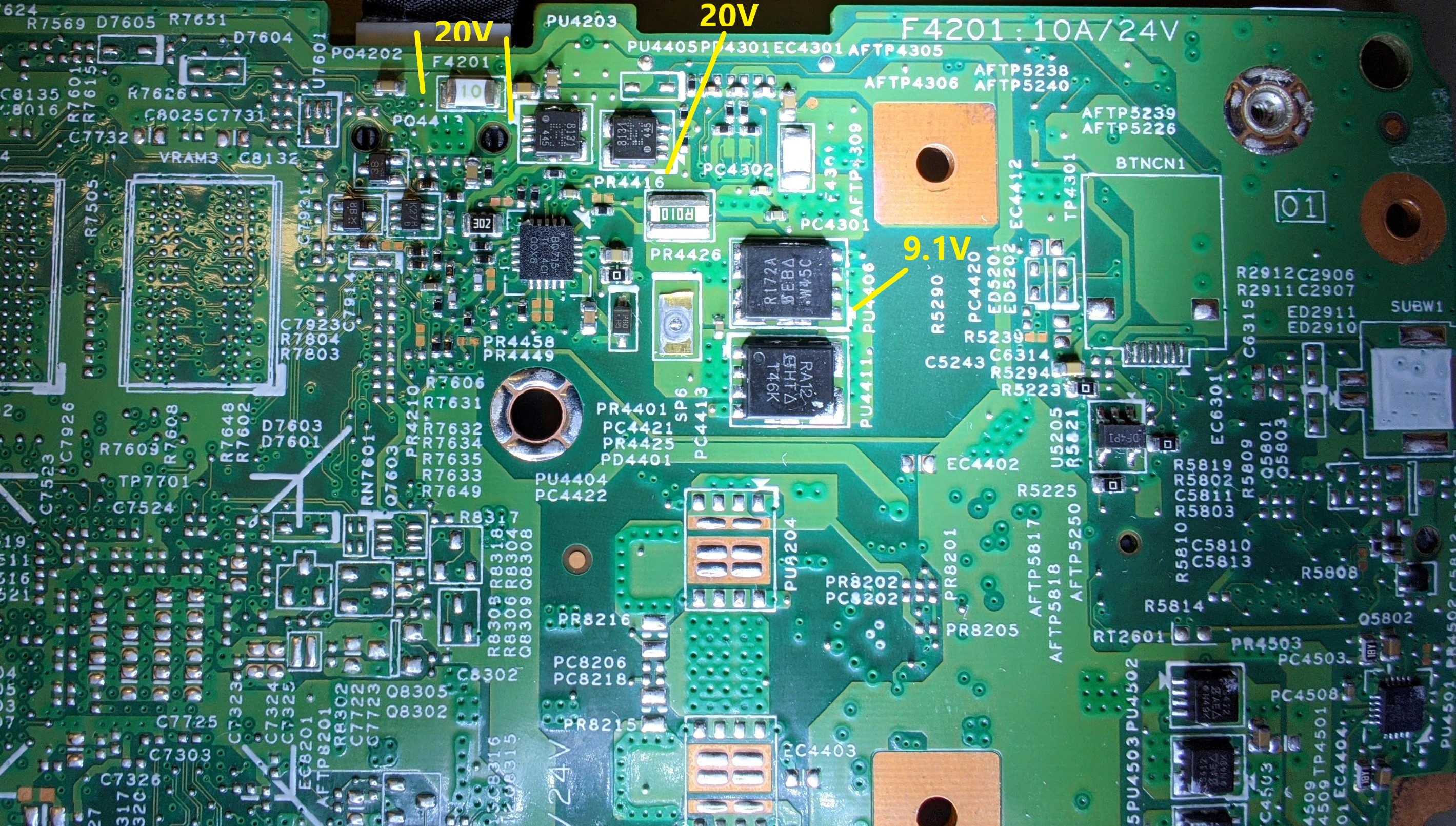

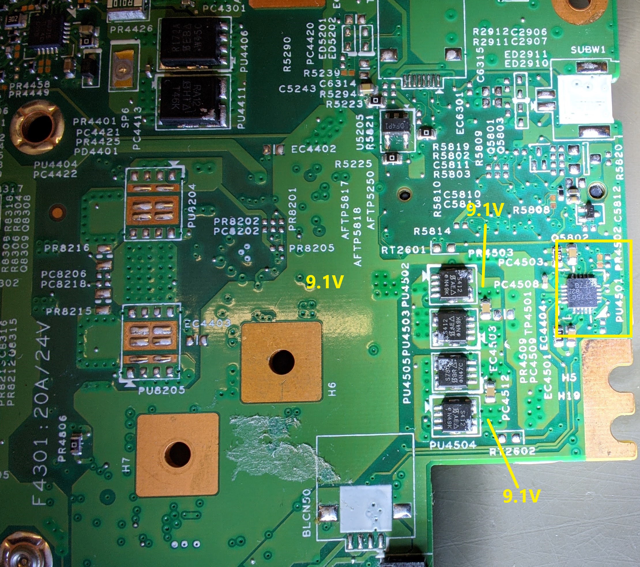

    Hi there..
    Lenovo flex 14"
    LF14M
    13281-1
    I've got a problem with this laptop, wich is not power on. When i plug adapter i can hear some buzzing sound(charger) and the PU4501 it will be hot. I replaced it with new one, same problem. But, the main problem is in the 20V(primer VIN)circuit I measured just 9.1V. I tested the marked components with multimeter, it is ok.
    I think the charger ic(Bq715) is cause the problem..
    Any idea? Thanks in advance.

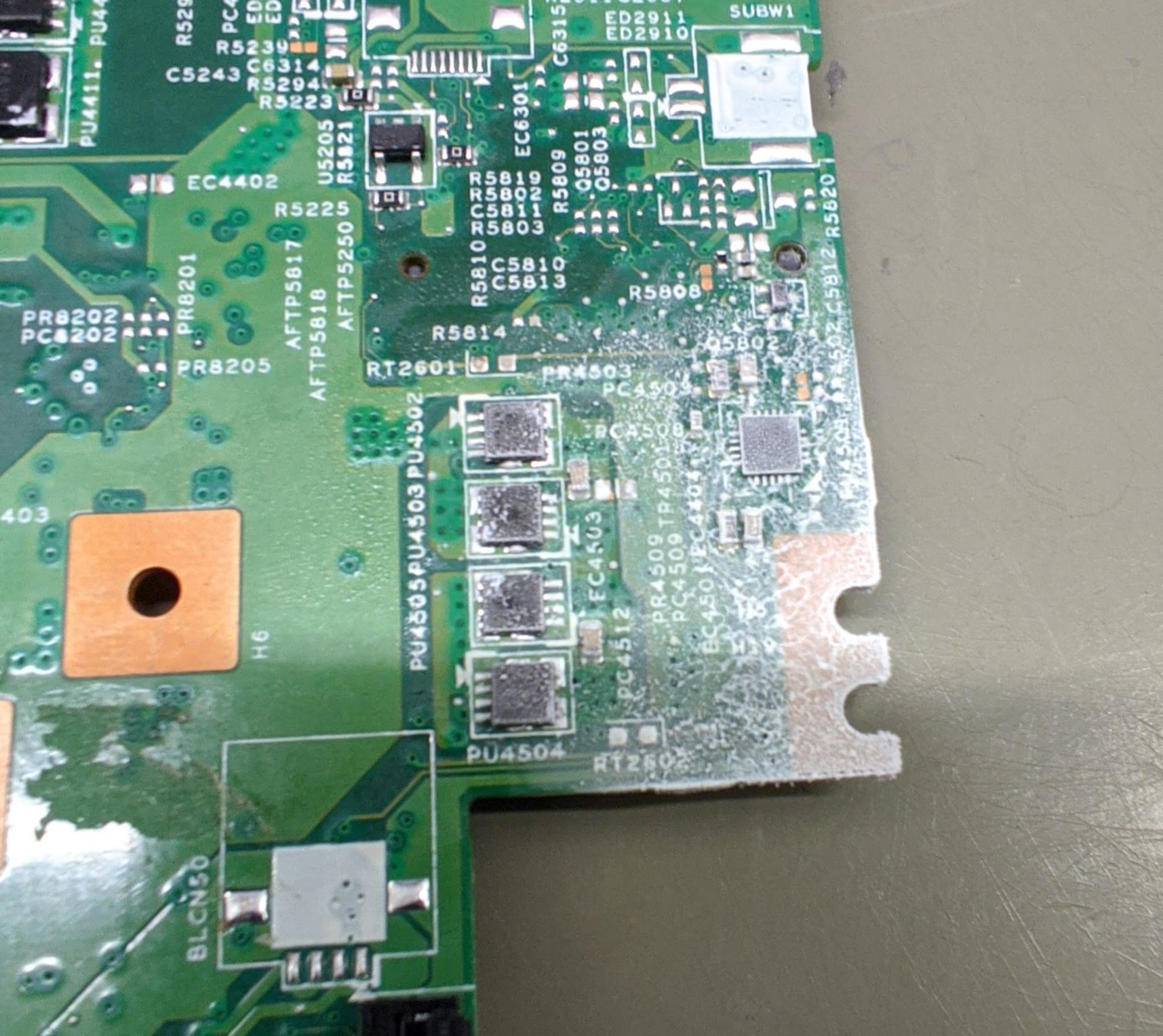

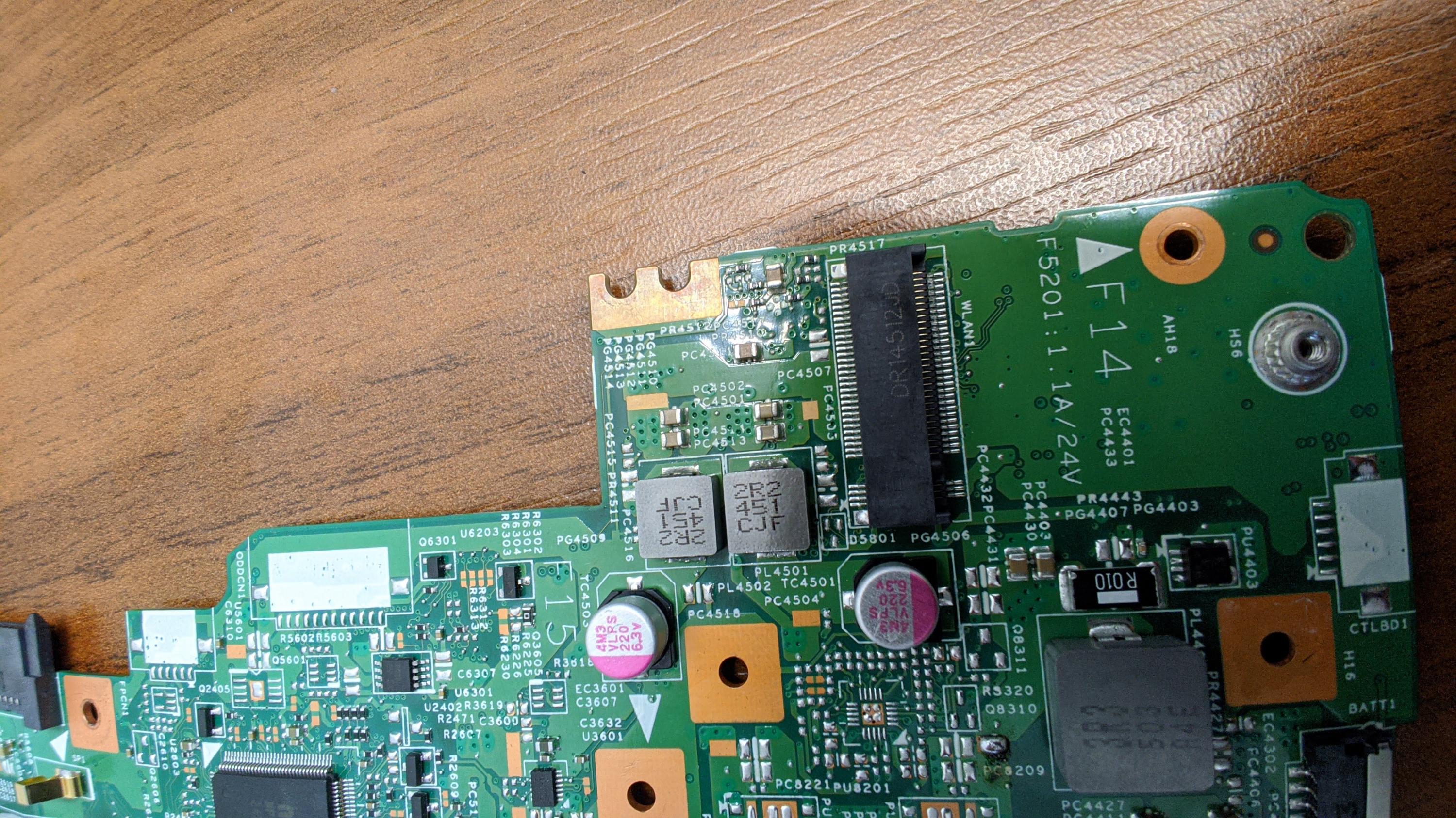

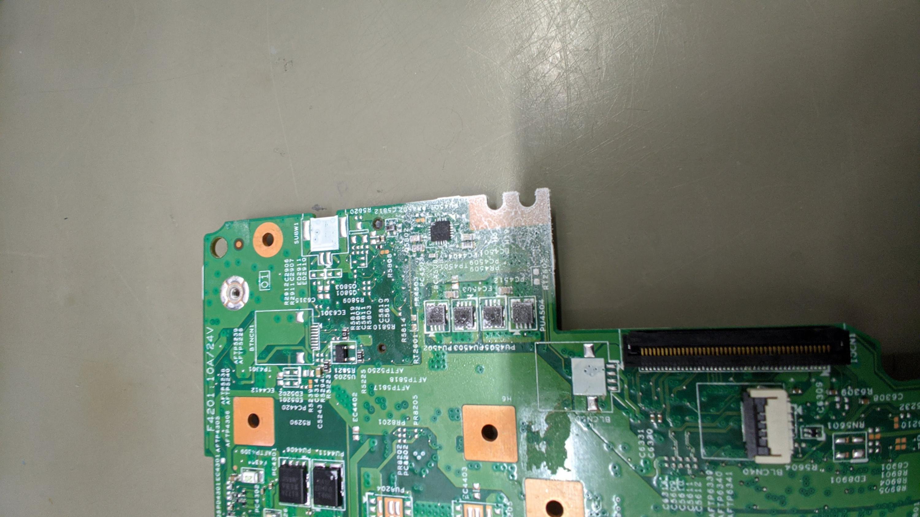

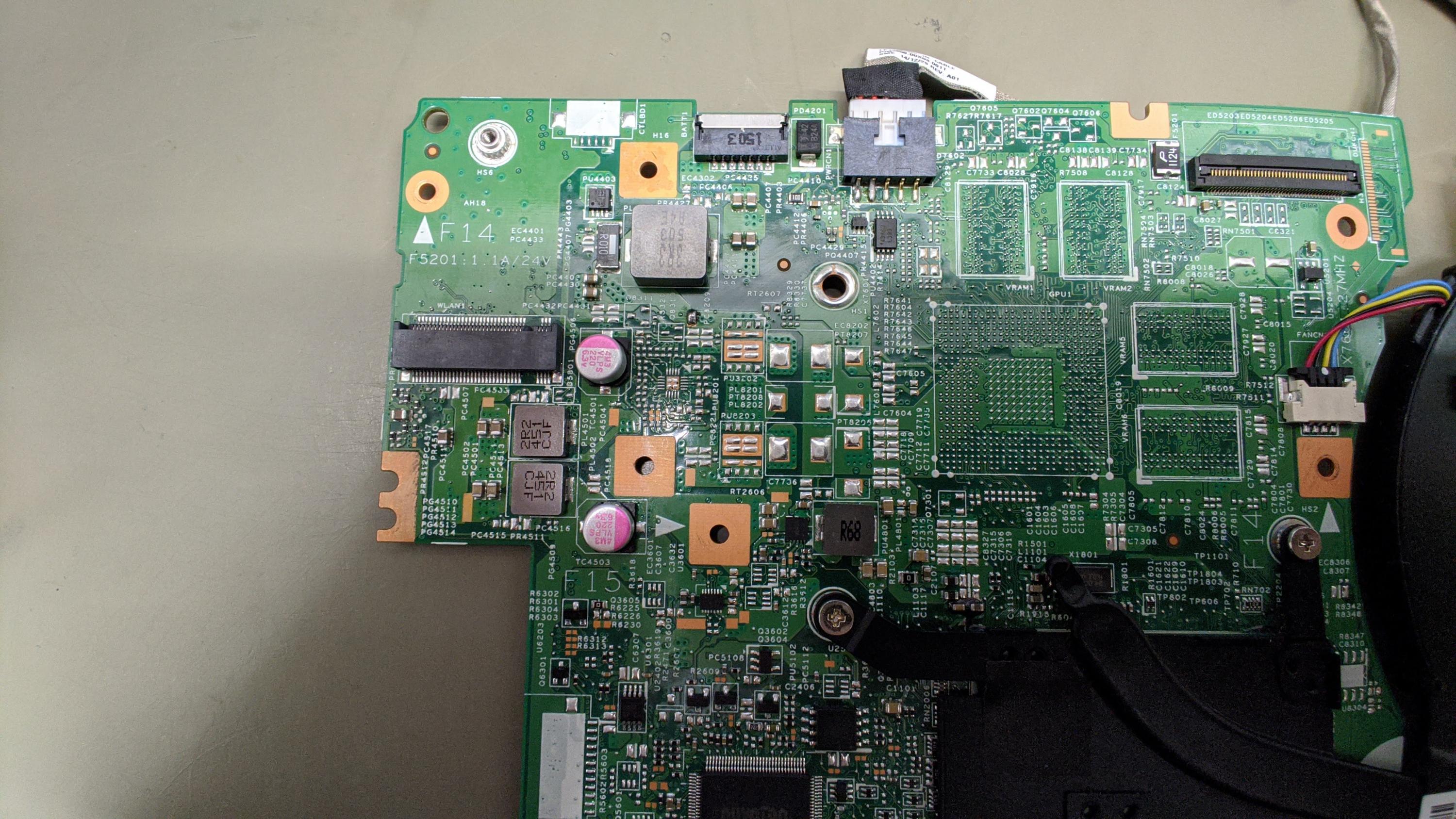

      Hi!
      1)Yes,
      2)yes, i have, but not for this version.. I was attached the file.
      3)I tried both, same issue..
      4)I measued in PU4406 drain side:~5Mohm, Source: 17Kohm
      i took some picture.
      In freeze test only the pwm ic getting hotter.
      5) no liquid damage or viewable damage, my client says: 'not happened anything'
      Thank you

        Power down and measure the resistance to ground on each grey coil on the backside. Perhaps one of these rails is with an issue that is leading the local switching regulator to heat up.
        It is very possible for the switching regulator to be damaged now but the question is why did this happen?
