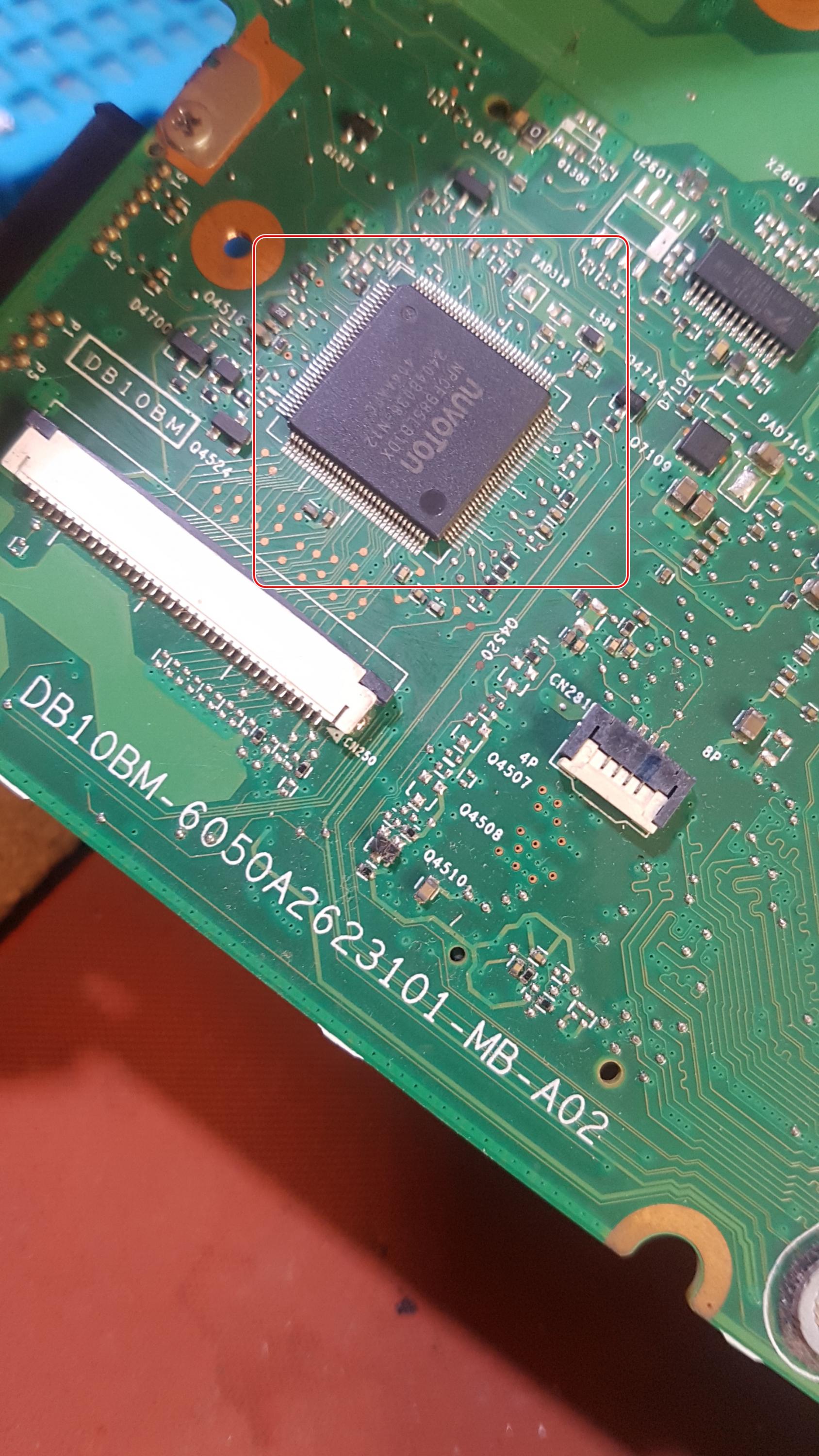

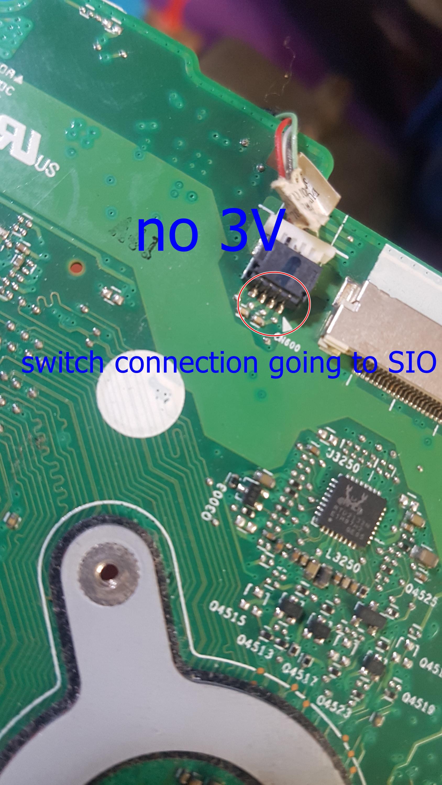

    Hi.. Good day.. Does any know the pin connection for this Toshiba Satellite C55 with board id: 6050A2623101-MB-A02 from switch going to SIO.
    I measured the pin of the switch or even on the terminal, there's no 3.3V.
    Plugging the charger will have a LED indicator.
    I need help..
    Thanks in advance

    UP for these..I need connection between switch and SIO.. Anyone has schematic diagram?

        the NBSWON# is what I am looking for bro... What PIN# on SIO chip?
