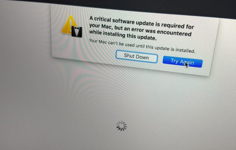

    A1706 820-00923 Boot looping
    Hello. Seeking advice on an A1706, appears to be 820-00923 logic board where:
    a) Apple has replaced the display under warranty
    b) Apple has replaced the keyboard under warranty
    c) now the logic board is acting up with that it power up, display works, boots the logo and onboard SSD for a restore -> prompts for the language selection -> voice prompts can be heard -> if you leave it here, the computer will reboot into this cycle after a few minutes. If you select enter to continue, the busy circle will spin for a while and then reboot into the same cycle.
    The logic board / computer is out of warranty and Apple wants $$$ to replace it.
    d) No fan spin on either fan
    e) Black CPU heatsink is toasty warm and measures @ 105 degrees F
    f) coils L7410, L7420, L7430 are reading at 0 volts. This is concerning.
    g) L7210, L7220, L7270 are showing voltages @ (varies) from 0.5 to 1.0x volts. Each is part of a 3-phase
    Understand that many other voltages have not yet been inspected but the unit is mostly working.
    h) the apple logo is solid upon boot but splits into many pieces before display text - much like a jigsaw puzzle - have never seen this before on macbooks
    i) using an external SSD, booting with fan spin and reach a point with "Critical update fail" message (see attached).
    Suggestions?

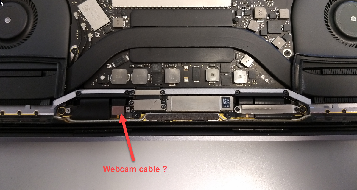

        • mon2
          • Dec 2019
          • 14368
          Re: A1706 820-00923 Boot looping
          Thank you for your reply and suggestions.
          Could you please confirm which exact cable is the webcam cable?
          Is it the one with the ARROW in the shared pic ?
          Update - corrected the location of the camera cable - found this detail on youtube.
          Is this the correct cable? Silkscreen references the text camera on the PCB.
          Also, the TOUCHBAR does NOT show an ESC nor lights up. We are suspecting a corrupt boot internal SSD and attempting to load from an external OS. Will report back in a few minutes on if the boot cycle is correct with the webcam cable removed.
            Yes the Webcam is that one on the left.

                          TouchBar won't work if T1 cannot boot. Critical Update Required appears when T1 cannot boot. bridgeOS for T1 is stored on the internal SSD. It requires macOS to be installed on the internal SSD.
                          https://logi.wiki/index.php/Critical...roubleshooting

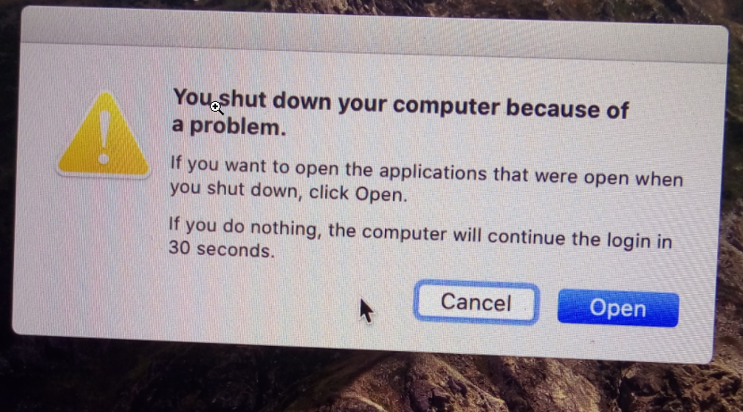

                                Hi. Updates and more questions:
                                1) using the same logic board with fresh USB type C (dual port) cable PCB - the logic board negotiates @ 20V on all 4 Type C ports. This is great news.
                                2) Next, we took this A1706 logic board and docked inside a completely different chassis (different LCD panel; different battery; different keyboard / touchbar and trackpad). The logic board boots and lights up the touchbar on this different enclosure. Good news again. Still crashing with the same end error message and while we did see the fan spin during a boot off Catalina, we do not see the fan spin during the High Sierra boot process. Respectively, during the HS boot cycle, with the fan not spinning, the CPU heats up and recycles.
                                I think we are getting closer as the Touchbar is lit up.
                                At what point should the A1706 be reflashed using the Type C to Type C cable? What is the procedure? Have not used this tool yet. Is it suitable for this issue? We can run the procedure on any macbook with the type C connector?
                                Attached is the screen from the Catalina boot cycle.
                                Would someone please confirm if the A1706 should have fan spin during first time boot up? Believe that it should to remain cool.
                                Thanks.

                                  Hi. Back to this logic board with the same issues. See the critical update is required boot loop. Using an external boot drive, we can get to the log in screen -> upon using our pswd, the desktop is presenting this error message and reboots.
                                  The touchbar does not light up. We have recently brought in a factory new touchbar but have not yet attached to this logic board. The webcam cable was removed but does not appear to make a difference.
                                  Any suggestions on how to proceed ?
                                  What is the procedure / tools are required to reflash the bridgeOS for T1 ?
