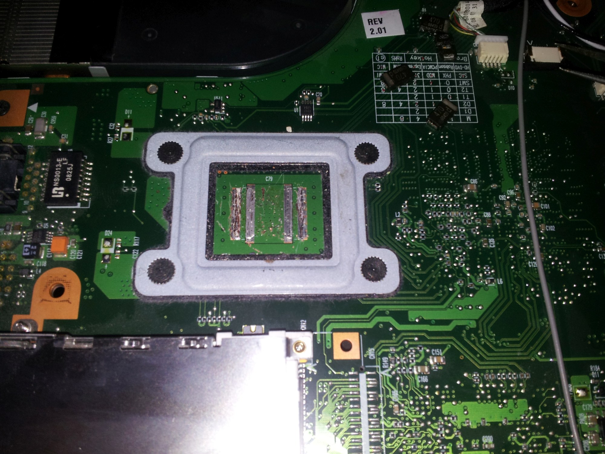

                                  Hi i have replace the nec tokin with 4 330uf 2.5v tantalium capacitor on my toshiba a300-20w but the laptop is working ok only without the battery, when i have connect the battery and the charger the laptop shutdown unexpected. Any advice?

                                    #857
                                    Re: Toshiba Satellite - Locks up when plugged in
                                    Originally posted by mockingbird
                                    That seller's ICs are almost certainly fake. I have bought MOSFETs from AliExpress before and they were obvious fakes...
                                    It's not necessarily impossible that he would sell a quantity of 50 tantalum caps with a value of $3+ each for $10 total, just make sure they really test 9mOhm and 330uF before you use them.
                                    They seem to be ok. I am now half way through my 2nd order of 50. I have used most of them in my own collection of A200 laptops. The ESR must be ok because the laptop will work after fitting the first 2 capacitors.
                                    The seller has 29 orders with good feedback.
                                    I have been bitten by fake parts through Ali-express. It can take a lot of time and effort to prove that the parts are at fault and not another cause.

                                      #858
                                      Are you saying that the laptop works normally when powered from the charger only?

                                        #859
                                        Yes, i use this capacitor from ebay maybe is crap but i remember that i have use it again without problem
                                        • rievax_60
                                          • May 2012
                                          • 897
                                          • australia
                                          #860
                                          Im still trying to make sense of this. While the laptop is being powered from the charger only, what happens when you insert the battery?
