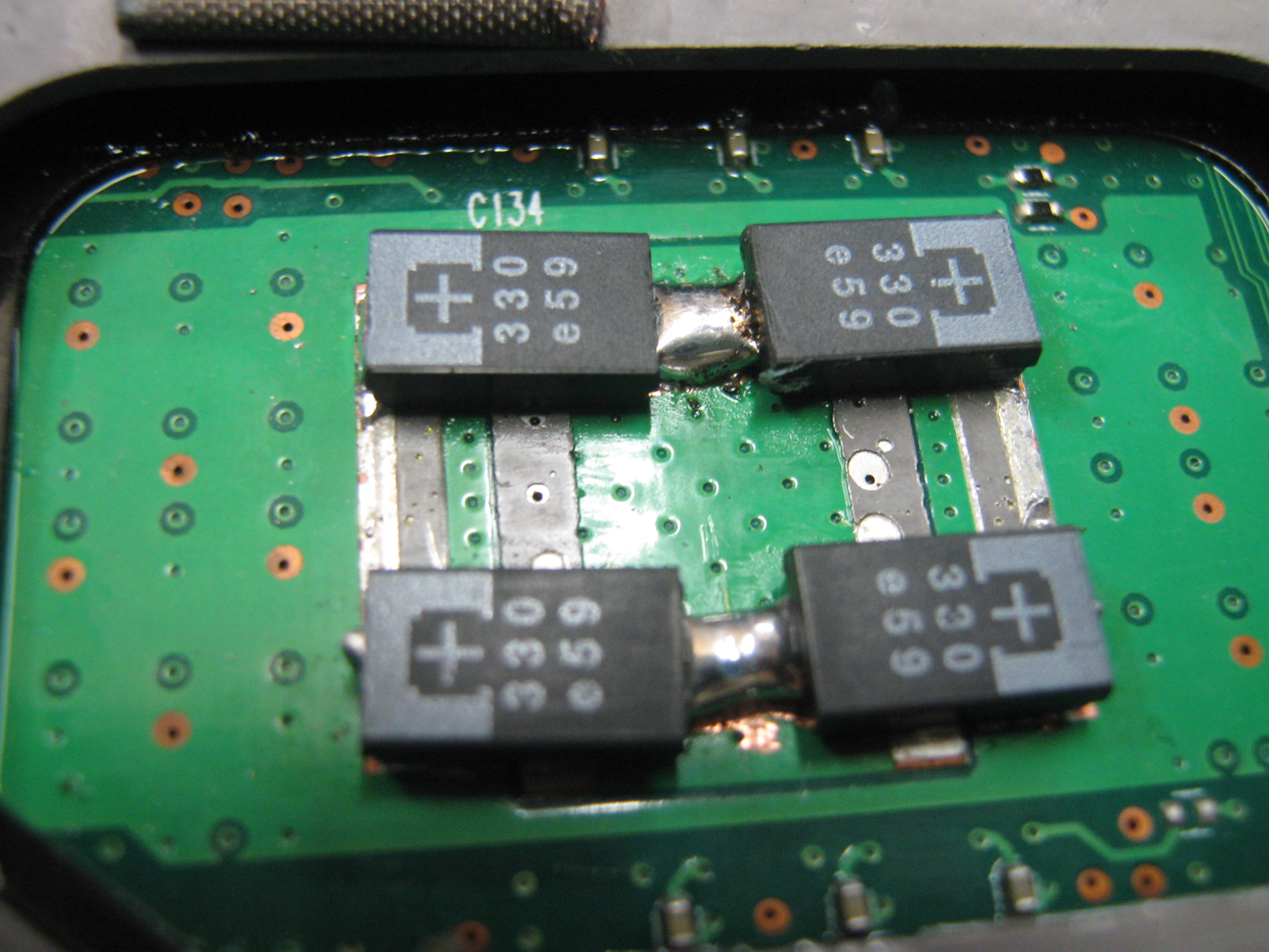

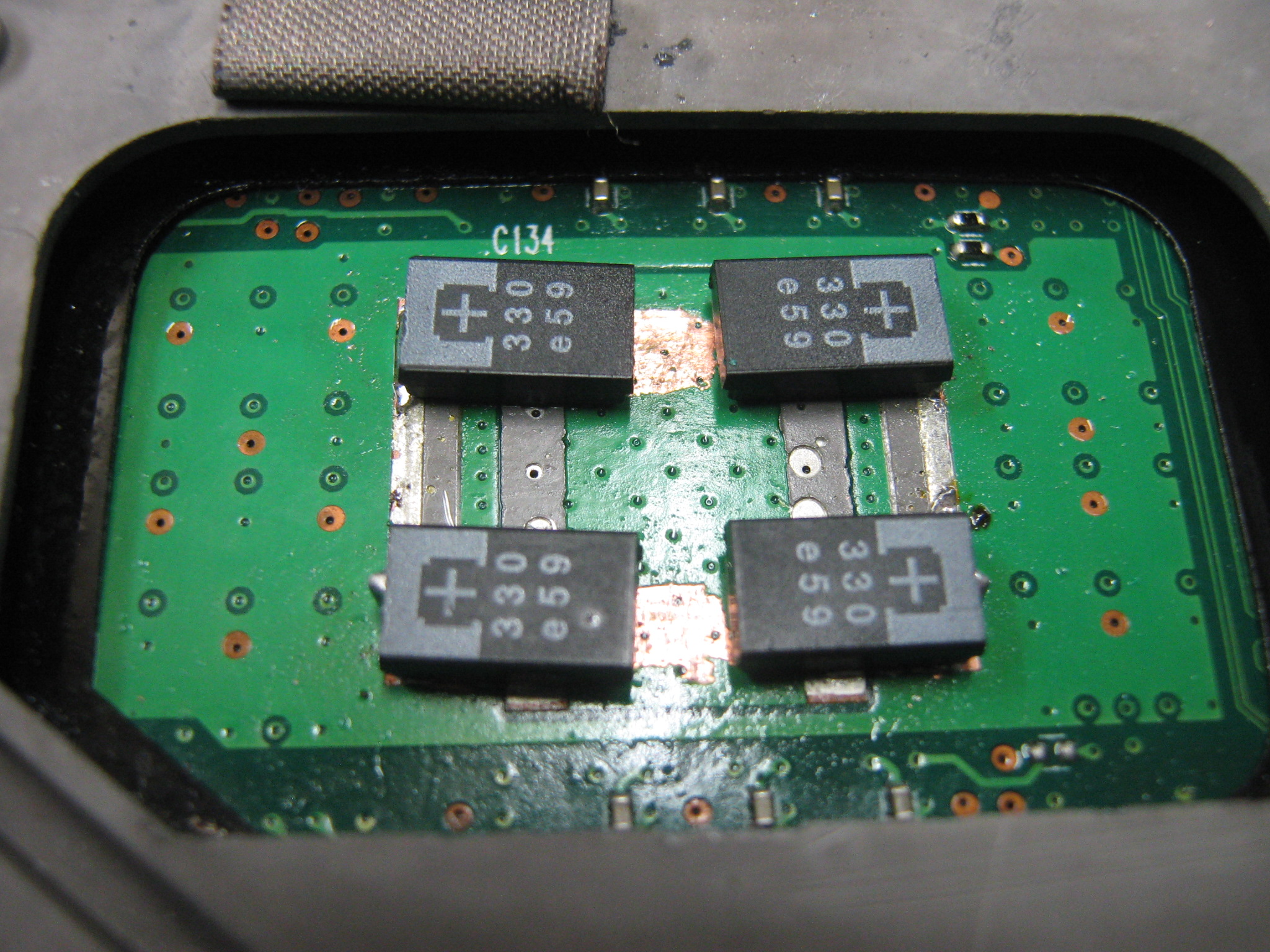

      i have the same prob A300. but my Q is if i can remove the tokin cap with heat gun and thermo laser gun???
      • rievax_60
        • May 2012
        • 897
        • australia
        #863
        Re: Toshiba Satellite - Locks up when plugged in
        yes, you are likely to be able to and make a mess as well. It is difficult to apply heat to where it is needed without the part melting an falling to pieces. It is much safer to gouge it off the PCB. It is not necessary to scratch the crap out of the PCB in the process.
        https://www.badcaps.net/forum/showthread.php?t=46821. Look at my photos in post #6.

          • rievax_60
            • May 2012
            • 897
            • australia
            #865
            Originally posted by predator0357
            Hi tnx 4 the help.
            but i dont care if the tokin will melt of fall in to pieces cuz its dead already ;-)
            P.S
            I forgot to ask if i can do it without removing things from the MB???
            I normally don't. You will risk melting the solder under the CPU socket. Also, leaving the CPU and heatsink attached might draw away a lot of heat.
            Causing extra damage to the mainboard is the main thing to worry about.

                  • rievax_60
                    • May 2012
                    • 897
                    • australia
                    #869
                    Why did u add solder between the caps?
                    To connect their (-) ends to the ground print. The green coating is called Solder Mask which needs to be scraped away to expose the underlying copper print so that is can be soldered to. Excessive scraping will ruin the mainboard.
                    You need to read more of this thread. You forgot to answer my previous question. It is sometimes difficult to know what is being ignored.

                      • rievax_60
                        • May 2012
                        • 897
                        • australia
                        #871
                        But the outer line are + and the inner lines are - so why we need to add (-)?
                        I did saw ur post it was helpful 4 me tnx.
                        The (-) tabs under the capacitors do not overlap the original (-) solder pads/stripes. Other members solder their replacement capacitors at an angle so that the capacitor tabs can be soldered directly to the original pads.
                        • predator0357
                          • Jul 2014
                          • 159
                          • Israel
                          #872
                          So if my caps (-) touchs the (-) terminal i dont need to do what u did,right?
                          • rievax_60
                            • May 2012
                            • 897
                            • australia
                            #873
                            That's right, if you can solder it properly. You have no electronics experience?

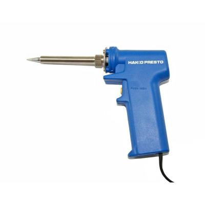

                              #874
                              Mainly what soldering iron do you have?

                                  • rievax_60
                                    • May 2012
                                    • 897
                                    • australia
                                    #877
                                    hi
                                    what about this vid https://www.youtube.com/watch?v=cgH7RYiSkkY
                                    what do u think?
                                    Dont do that if you want your laptop to work again. I have explained a safe method. Read more of this thread to see other members' experiences, good and bad, and avoid the unnecessary scratching.
                                    Send us a photo of your iron clearly showing the tip.

                                        #879
                                        Heres my soldering iron HAKKO PRESTO 981
                                        • rievax_60
                                          • May 2012
                                          • 897
                                          • australia
                                          #880
                                          I didnt even know that iron existed. It would take some practice to get the heat right. I use a K tip or large chisel tip. The rest depends on your soldering skill.
                                          Check the resistance of the CPU between the (+) and (-) pads before you start. Then check it after you have fitted the new capacitors to be certain there is no short circuit caused by the soldering.
