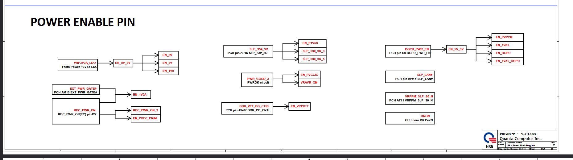

                Sorry for lifting an old thread, but i have simmilar issues with this board, when i plug the charger, the LED on the charger goes white and at the same time 4 time amber blinks while white is glowing , also poweer button is white for that time and then it goes off...i have 3.3V and 5V, PU12 =1.8V, and 2.2V at the power button...and that's it...the board doesn't turn on,2.2V goes of when put to ground,KBC gets that signal, adapter signal is present on the KBC, what else to look for? Can anyone explain how to read the power on sequence? Signals like PWR_GOOD_3 should be low or high?

                        So i figured... i don't get the pgd signals obviously...so i am missing a voltage?I don't know how to read the startup sequence from the image few posts above , can anyone explain? There are no shorts on the board, except low resistance (5 Ohm) on the +VCC_core,but i injected 1V, and get 200mA draw...so no short...
                          you refer to POWER BLOCK DIAGRAM at pg 64 ? I don't see any startup sequence on the schematic
                            #53
                            yes,that....sorry,i am self taught and still learning ...what to look for next?
