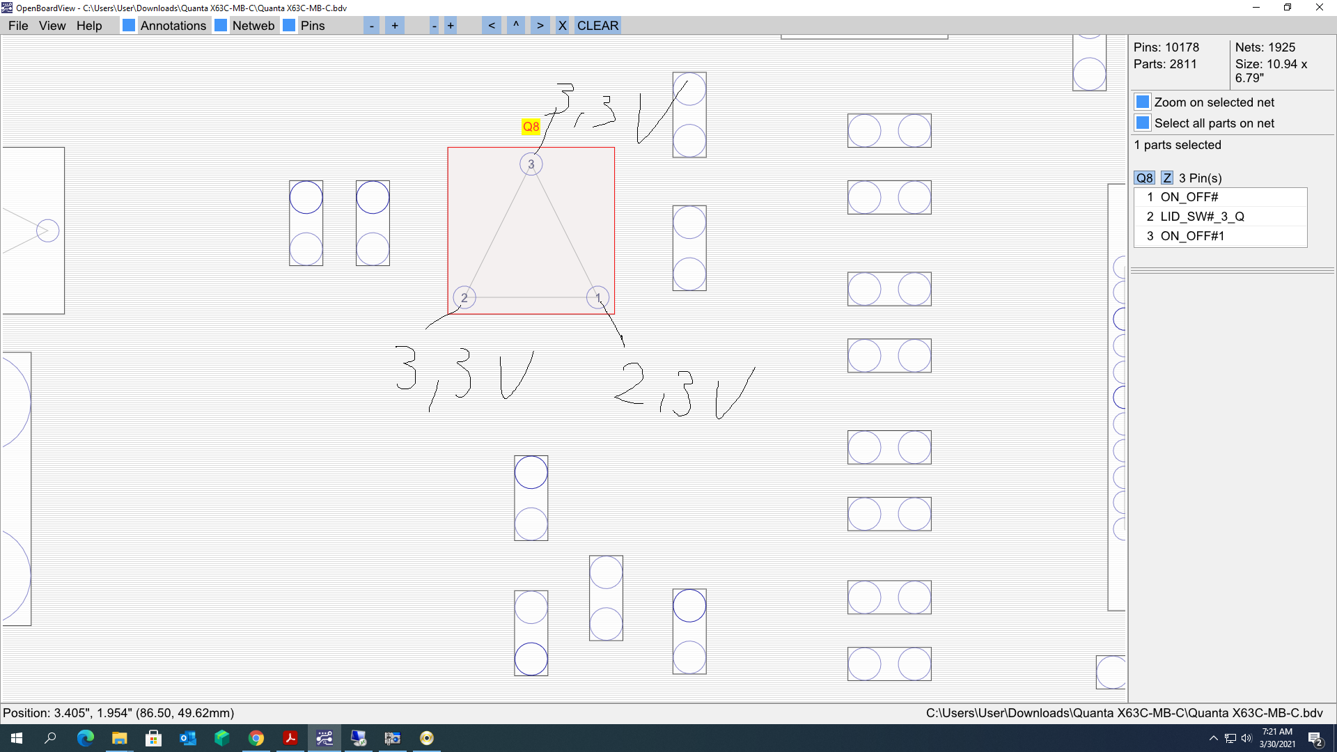

    Re: Hp probook 450 g3 not turn on
    Originally posted by techtiger
    remove C28 and check if the 3.3V is back CN5 pin 3
    no now i have 2.5 v

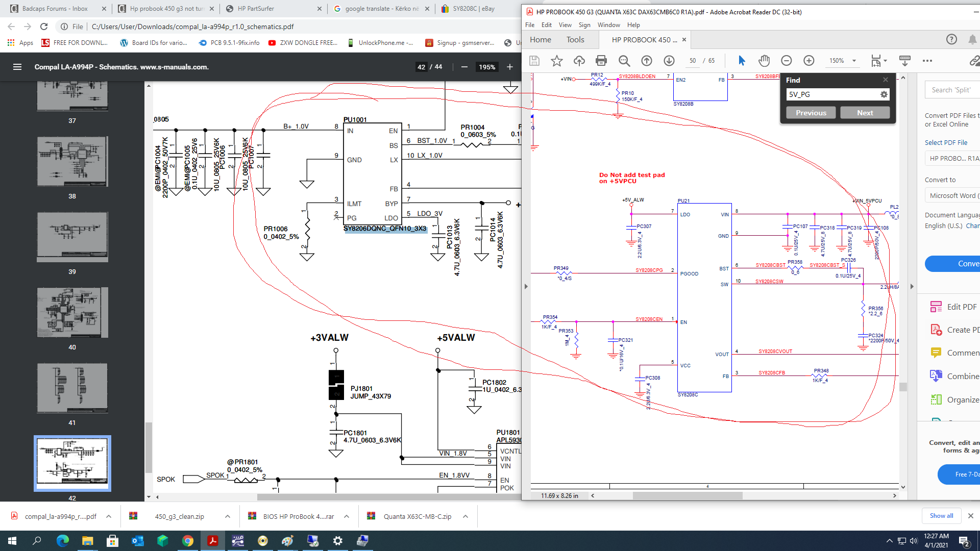

      Originally posted by SMDFlea
      The Q8 pins are wrong in the schematic - https://www.badcaps.net/forum/showth...ht=DAX63CMB6C0
      when i pres power butonn pin 1 and pin 3 going 0 v its ok ? power buton in cn5 is pin 3 and he conect with pin 1 the mosfet Q8
        • 22264
        Originally posted by arber1232
        in pin 10 i have 5.4v
        Yes as you mentioned at post #12 ., sorry .You still have 0v though at pin 2 PGOOD ,test resistance to ground and PR70 should be 3.3K ,and test voltage on PR348
          PR70 is 3.3k .. and voltage 0 v .....
          PR348 is 0.99k and voltage 0.5v
            CAn i try to jumb pin 2 PGOOD with pin 4 in Pu21 to have 5v ?
              No, you cant. Check pin5 of PU21 also. The voltage at the power switch may be ok. Have you flashed bios?? If not, do that first.
