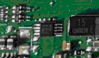

                          Hi
                          Please how type in Asus UX410U mainboard is this chip as in attached picture ?
                          On my MB is burned and not see sign.
                          • Stevedb
                            Stevedb
                            • Feb 2018
                            • 624
                            • Belgium
                            #33
                            Re: ASUS ux410u - No power no charge
                            Photo is not clear enough you can use some cool paste or toothpaste to see what is written on the chip.

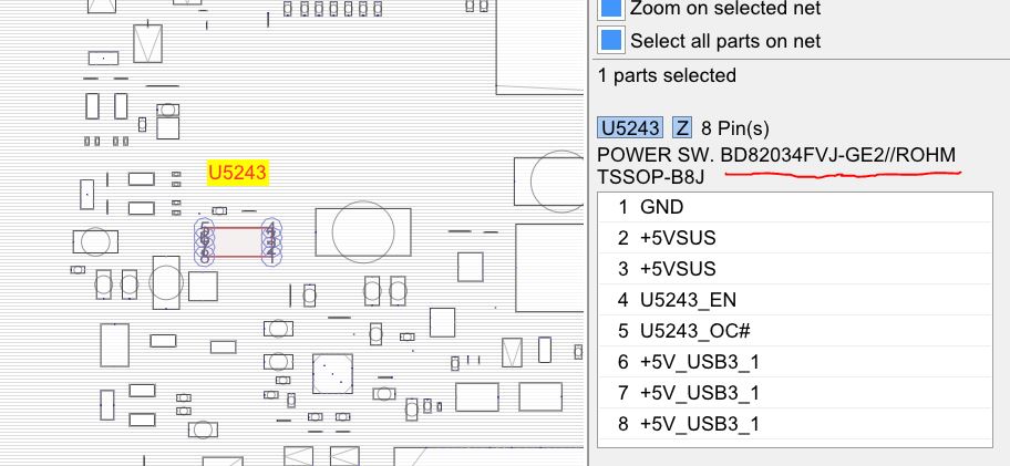

                              • 20504
                              #34
                              Originally posted by velektronic@gmail.com
                              Hi
                              Its a ROHM BD82034FVJ-GE2 .Datasheet https://cdn.badcaps-static.com/pdfs/...9fb9560043.pdf
                              Use this boardview https://www.badcaps.net/forum/showpo...28&postcount=7
