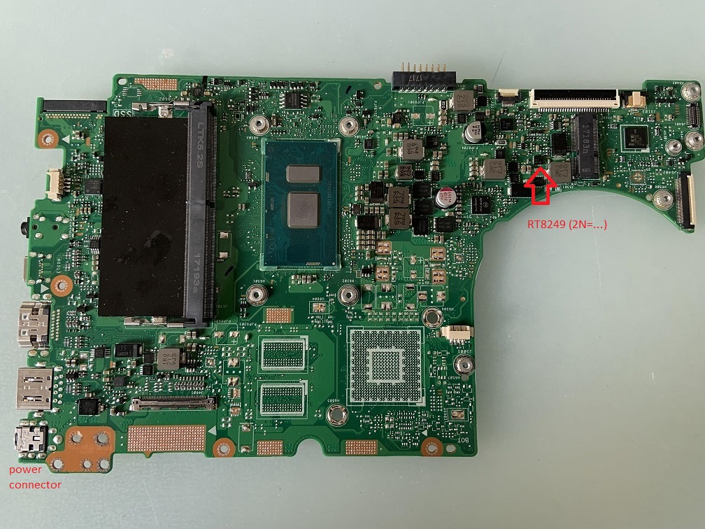

    I have an ASUS ux410u that is no boot no power. I'm trying to find out the issue and I'm seeking for help. I'm not a specialist, I have a background in electronics from engineering schools but nothing more.
    The good news is that I have another ux410u that is working perfectly, so, I could compare if needed.
    I've disassembled it and isolated the mainboard of the defective one and made some checks:
    * the power port is ok, I get 19.4v on the board
    * After the two first mosfets, I still have 19.4v
    * Without doing any voltage injection (just the official power adapter), a component is getting super hot: I can feel it with my finger. With alcohool and microscope, it's pretty clear that it is this component.
    * The hot component is 2N=4a... which seems to be Richtek RT8249C: https://cdn.badcaps-static.com/pdfs/...d7b1efab2b.pdf
    * For sanity, I tried to find a short around the hot component but no "success".

    * During my sanity checks, I tried to measure most mosfet that could be connected to the 19v powerline. One of them (which seems ok) has one pin to 25v. Is it normal? I would expect to have nothing more 19v. (maybe a newbie question )
    * Most mosfet are 4N VUC. My research let me find that it could be PE528BA. However, I'm not able to find out what VUC stands for? Are 4N VUB and 4N VUC the same components?

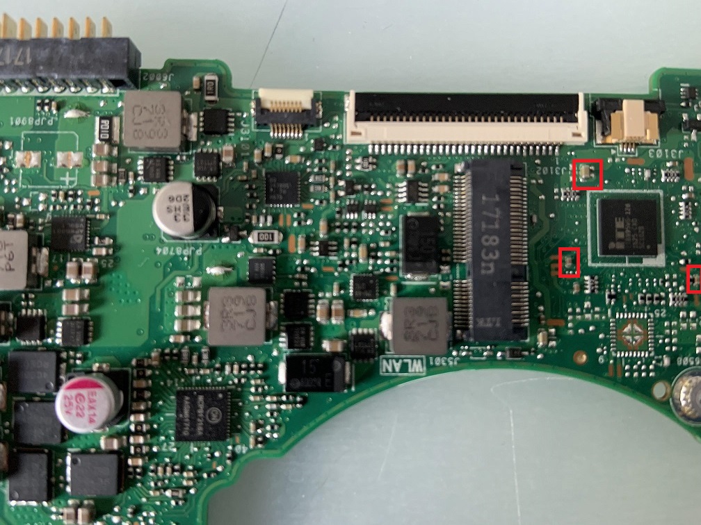

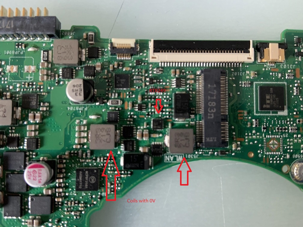

        Re: ASUS ux410u - No power no charge
        Hi techtiger and mcplslg123,
        First, I want to thank both of you for your reply, it's appreciated .
        I have attached some pictures took with my phone (sorry for the quality).
        @techtiger:
        • I didn't find the schematic for boardview. I believe they are not available for this board
        • For voltage, I have: 0.8 for pin 3, 0 for 13, 0.175 for pin6&20.
        • I don't have neither schematic nor voltage on coils. I'm not sure to know how to identify the coils you mention. What does ALWS stand for? (sorry, I'm still pretty "new" in this field). I would guess that these are the coils around but I'm not sure.
        @mcplslg123:
        • I've measured the resistance between these 4 pins and ground. My current results are: 30kohms on pin3, 99.2kohms on pin 6, 505kohms on pin 13 and 9.86kohms on pin20.
        • I will remove the component this week-end and compare with these values. My understanding is that, if I see huge changes on these values, it would be a strong indicator that this chip is bad. If I need to do short injection, my plan would be to remove the component first, and then inject 1V (much less than 3V and 5V) on the pin that doesn't change so much, is that correct?
        • You say: "There is bright chance of EC being bad." What does EC stand for?
            @techtiger:
            There are different states of MBD Power in SLP_S5# state ALWS (all ways) Voltage will be active depending on the platform in your case RT8249C is the Regulator which output 3/5 ALWS + LDO 3/5
            EC embedded controller SIO (super input/output) KBC
            microcontroller in computers that handles various system tasks

              So, I did some more tests and I believe I'm making progresses. The facts I have right now are:
              • my main power rail is OK (19.6V)
              • my RT8249C is getting hot. Its pins doesn't get correct voltage. 0.8V on pin 3 and 0v on pin 13. I don't know what would be the expectations on the pin 6&20 but 0.175v doesn't seem normal.
              • My EC SIO is ITE IT8995VG-128. Under "normal" operation(charger plug in), I don't notice any hot on it.
              • I've finally found at least 3 capacitors that seems shorted around my EC SIO. The impedance is around 1ohms on these capacitors. These capacitors are not in the exact same space but around my EC SIO.
              These facts let me think that my EC can be dead (as mcplslg123 suggested). Before going further (attempting a replacement), I'm looking for a proof of that.

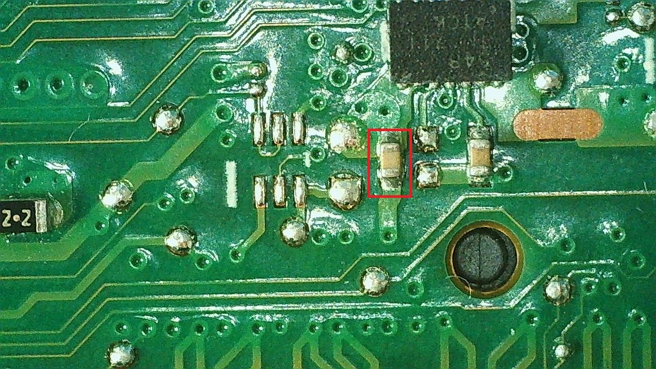

                    Adding a picture to show the shorted caps (in case somebody else get a similar issue in the future).
                    I have another caps behind the board that seems totally shorted (less than 1ohm on both sides of it).

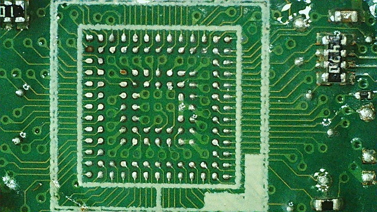

                              So, I did 1 and so, removed the chip:
                              * the three caps around the ec are no more shorted
                              * one cap behind still totally shorted (see picture)
                              I removed the remaing cap to see if it could be it. However, the short remain. Since I really don't know which side is + (0 ohms and was 0v), I'm a little bit lost on how to find out what could generate this short.
                              The bad news is that, while removing the chip, 2 pads are gone => picture. This is where I start to have doubts I have the right skills/equipment to repair this board. I mean, I know that it's not game over to have pads gone, but BGA + missing pads, maybe I'm too newbie yet

                                What is the reference of the IC in close to the cap? Look for its datasheet and use its pinout as reference to find which pad of the cap is ground. Looking at the picture, I would guess the top pad of the cap is ground.
                                For the BGA maybe you pulled it before it was fully melted, but the damage does not look bad. Its easily fixable with jumper wires. Just make sure to properly secure the wire once soldered (ideally you should use UV curable soldermask paint).
                                  Do you have schematic and/or boardview for your motherboard?
                                  • Nice approach. Seems obvious when you say it but I didn't think about it
                                  • Maybe it was not fully melted. First time it happened to me . I try to never put too much heat (I've trained my skills on many "dead" boards before). I will look at how to repair them once I'm sure it's worth to try. For the moment, as long as I have a short, it seems a waste of time to fix the chip.

                                      The chip close to the cap has "548 TI 711 ATCK". Didn't find the datasheet yet.
                                      Just to be sure: you believe top pad is ground because we have a huge track or is there any other reasoning?
