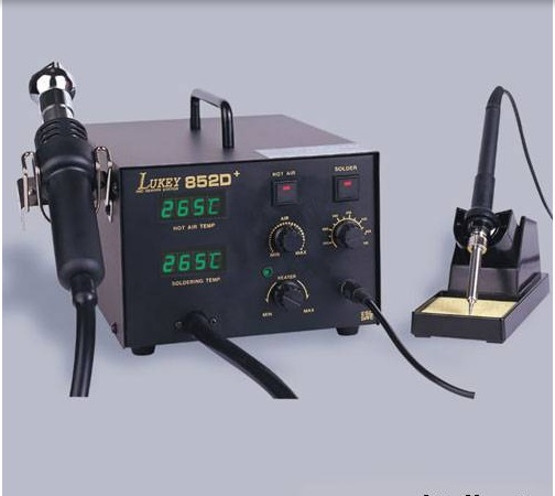

    Hi am new to this board and am practicing hot air station refliw on some laptop gpus .
    How i can improve reflow life time ?

    you can disassemble and install SMD chip with a similar hot air station. but you should not interfere with the chips in the BGA foot structure, such as the GPU. good works

      So do you mean i should not heat the gpu die and only the sides?

        reflow is NOT repair. it will last as it can, but havy gaming and u have it back within week
        if u want to reflow u MUST have preheater. 70% of heating power must comes from preheater
        if u wanna practice, than practice with reball. dont waste your time on reflow

          2.1. Never reflow large BGA
          It won't fix the problem since 99% of the time it's not an contact issue between the BGA and the logic board. There's a high risk of damage the board even further.
          If you want to confirm if an AMD/NVidia chip is bad, you can heat it up to 200°C max for a minute and a half, no flux. It'll come back to life for a short while and then die again, because it's bad. In this case it has to be replaced.

            Ok thanks mate . What would be an affordable beginner bga reball station or something i can build up.

              Most "beginner" bga reball station, while cheaper, they usually have rather poor calibration and require some experience to gauge when the chip has reached reflow temperature. Otherwise it is very easy to damage the chip, or worst, damage the board itself due to the latter delaminating, etc.
              If you are new to soldering, i'ld suggest you start by practicing through hole soldering using a 'normal' iron with a proper tip and SMD soldering (you can get by with a cheap Chinese one, they are OK for small jobs).
