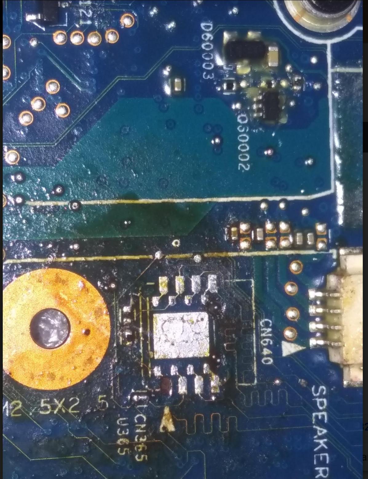

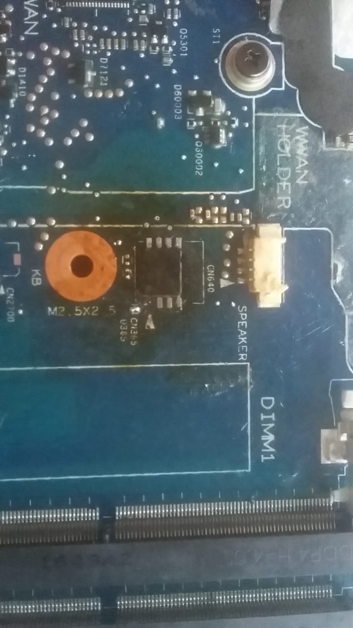

    HP 820 G3, Power Flashing.
    i have 820 G3 flashing light, its good before ai try to unlock bios.
    I'm sure, I have Flashing the original bios and the pins are installed properly.
    i got,
    Pin 1 = 3.31v
    pin 2 = 3.24v
    pin 3 = 3.30v
    pin 4 = 0.00v
    pin 5 = 2.60v - 3.31v (up and down)
    pin 6 = 0.00 - 0.14v (up and down)
    pin 7 = 3.30v
    pin 8 = 3.31v
    anyone can help me, i dont have schematic.

    If it was good before flashing the BIOS, chances are it's the wrong image or it's corrupt.

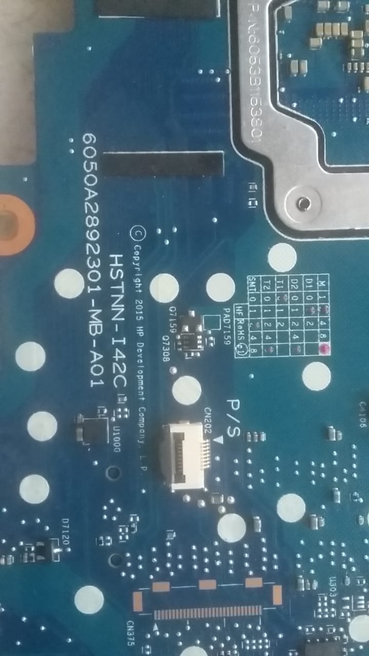

    "HP 820 G3", and only that, doesn't really tell us anything. Theres an i3, i5, i7 or even an AMD board, each with different BIOS. And different revisions for each that could have yet a different BIOS. Need to be more specific. For example:
    I have the board 831762-001 from an HP 820 G3, i5-6200U, and flashed this file with MD5 cb229e609f1ebd3d56e4da05cc2f6645.
    With the provided information we can't even know which are the schematics you need

      I have 820 g3, i5 gen 6. code board : 6050A2892301mb-A01, i broke the pin 1 when i try to jumper. and unlock bios, after flash to original (im sure its original is good) the laptop cant on, just flashing light power.
