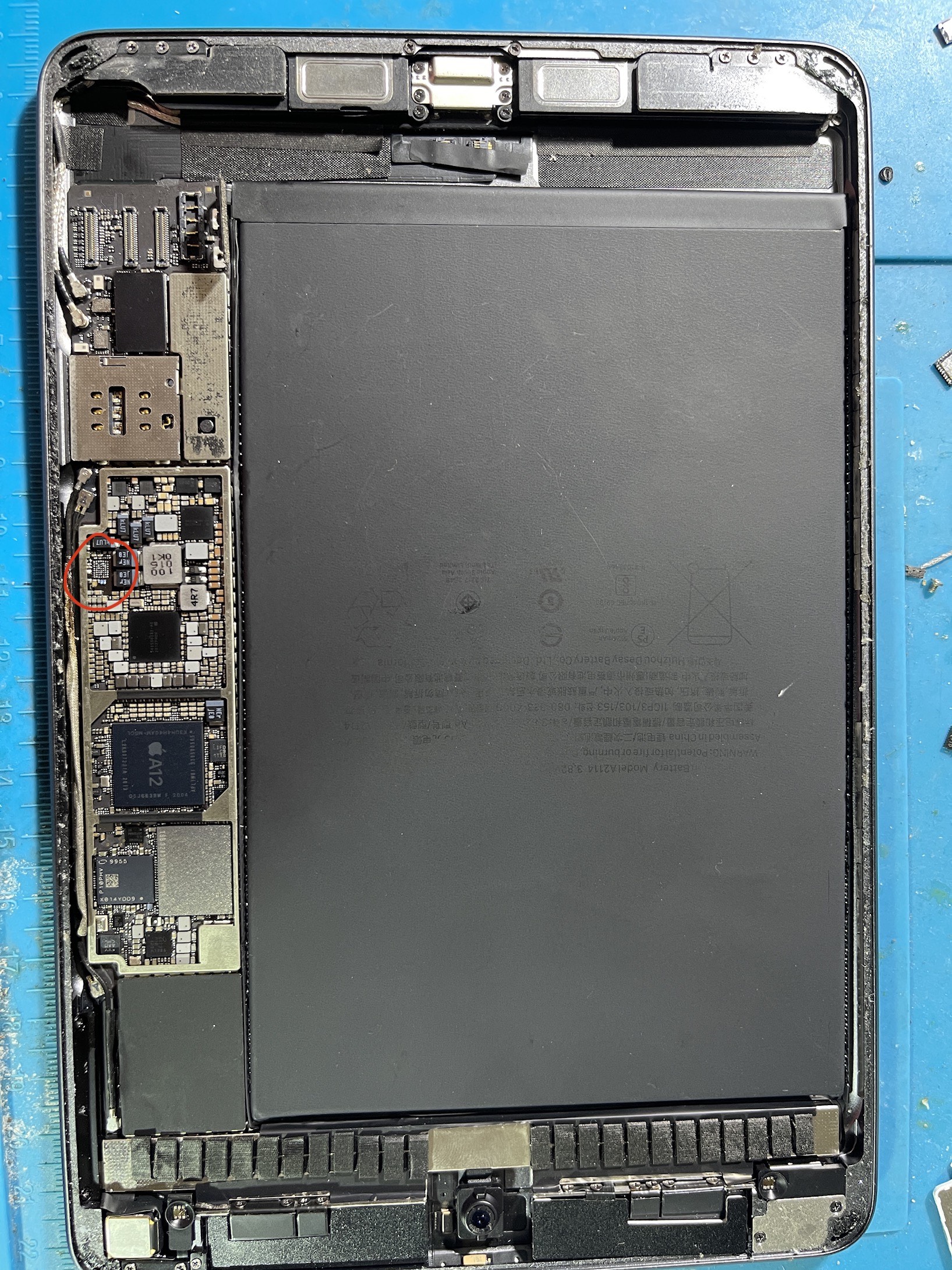

    dear all,
    i have an iPad mini 5 x repaired from another shop.
    the case is dead and no charging. when i opened the is a missing component. you can see from the picture that i attached.
    does anyone here have a schematic or boardview for this ipad mini 5? because i was searching everywhere but couldnt find it.
    thanks in advance

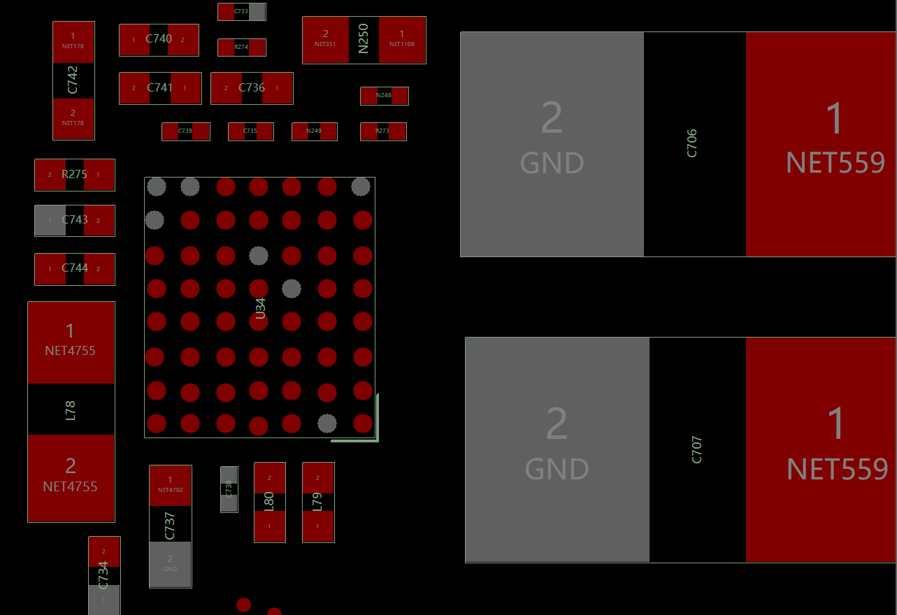

      Have only the attached from our subscription - boardview file but no schematics.

          do you know where to buy this component?
          is this some kind of tristar? because i dont have the parts number of this missing component
          • kingskie
            • Oct 2014
            • 249
            • indonesia
            Re: ipad 5 A2126 dead no charging
            i found it from ifixit.com it is U2 charging ic 1612A1
            i will try to put it back and let u all know later..

                Wait! That cannot be part as the 1612A1 = 36 balls (6*6).

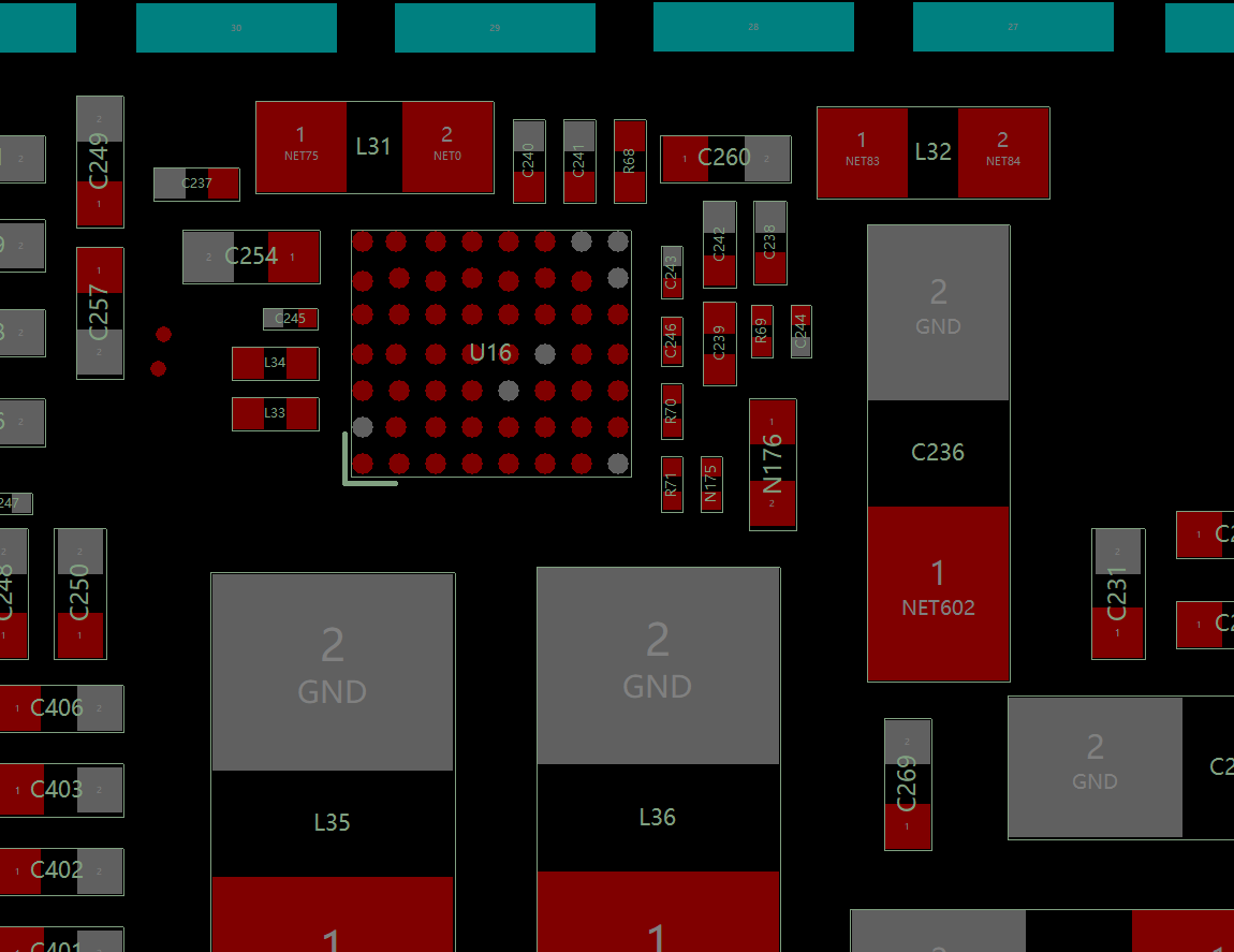

                Please review my boardview of the same PCB.
                The landing pads are more than 36 balls.
                Best to go to the client -> ask which shop worked on this -> ask the thieves which part they stole or 'attempted to repair'.
                    In my macbook logic board, the T2, ISL9240 (what we bought it for) + CD3215 devices were all stolen.
                    We are studying the operation of the ISL9240 but this store helped themselves to the parts and told the customer, the computer cannot be repaired.
                    1612A1 is 7x8 (56) balls
                    the problem now is the dot on the chip that indicate for first pad is opposite position with the phoneboard boardview.
                    this ipad mini is from the repair shop that i cooporate with so i dont know where is the repair shop that stole the parts...
                      Suggest to find any schematic with this tristar ic.
                      Then review which balls are ground.
                      Locate the same ground pattern on your logic board with a multimeter to learn the proper orientation of the chip.
                      Please keep this thread updated. You are working on an interesting case.
