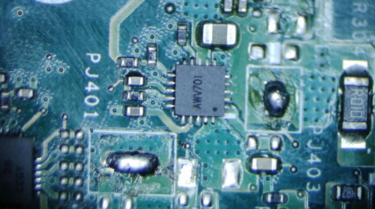

                Re: Nitro 5 AN515-51 - Burned KBC and regulator - LA-911P
                Does anyone know how I can find what IC is this? PU401?
                Cant find it by the letters on it...AWV701
                I removed the SIO, and 3.3V EC is stable now.
                But this IC should output 3VALW and its not... and its also responsible for 3V and 5V rails activated by the SIO
                Pin 11 EN is present.
                So I think this IC could be the responsible for this, but would need a datasheet to check
                Any idea?
                  Datasheet for SY8286B is not available ("A" is but there are differences). But yes it is responsible for 3V, the smps output should start after enable signal on pin 12 is present. (should come from SIO which you have removed).
                    Thanks, sad theres no datasheet
                    I have the PIN 11 enable at ENLDO_3V5V
                    Should this be enough to get output at pin 14 +3VALWP?
                    or needs to be enabled at pin12?
                    Just trying to be sure that I should have +3VALWP present without the SIO or not
                      SIO gives enable signal to pin 12 for +3VALWP to start.
