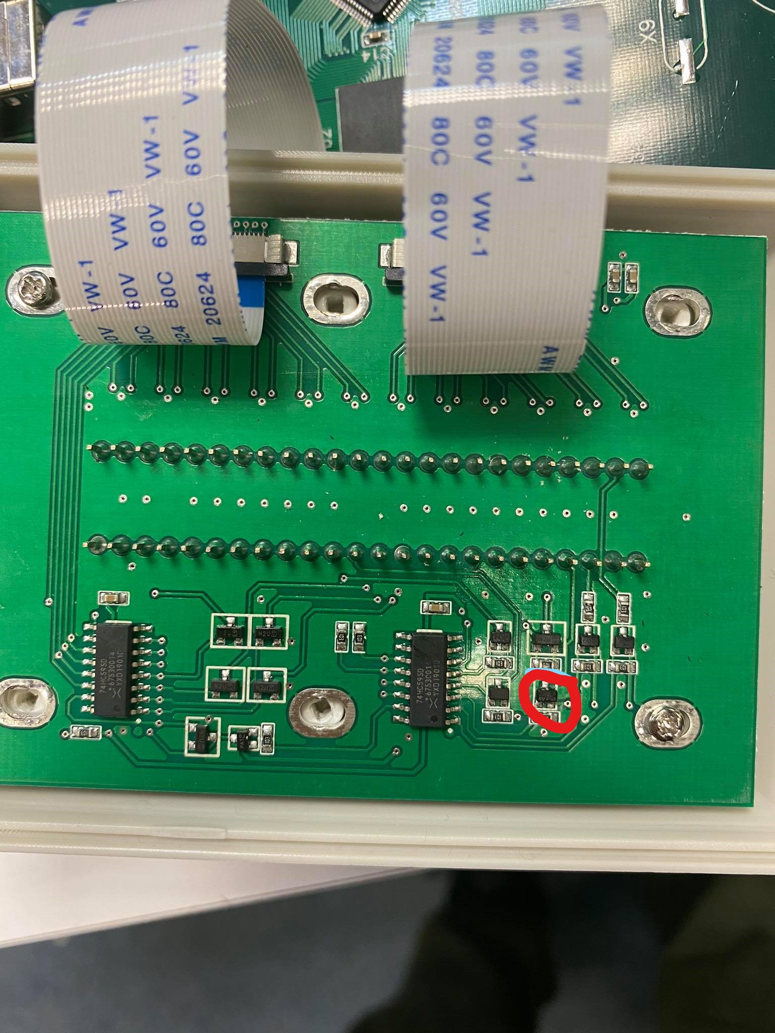

by ntecHi, I'm repairing my expensive aquarium led lights and need to replace a broken sot23 transistor. I need help in identifying the correct part to order for replacement. I have attached the pic showing markings of B28W and the transistor sits beside a 0 ohm resistor and a capacitor....

by magnehHello
Got this speaker from a friend , defective. Power led comes on and off , in a loop.
Disassembled, got the board out, and after a bit of measuring I found a low resistance on a 5v6 line. With a bit of current I found a transistor heating up on that line (labeled T1 and 113 as on pic).
After removing this guy, I got a value of 0.7 in diode mode on that 5v6 line, which before had 0.02 or something like that.
I tested powering it up without the IC, and the speaker turns on and stays on, and works fine
Still, I need to replace this transistor.... -
