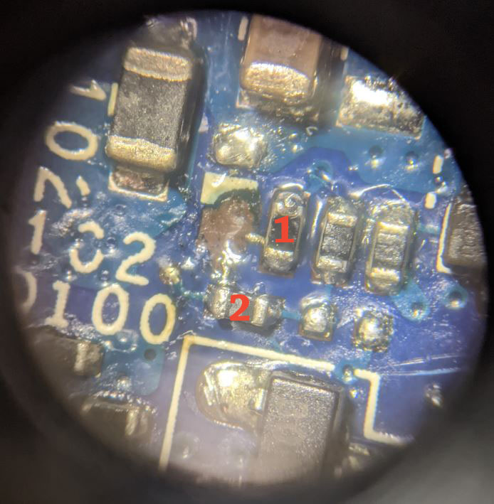

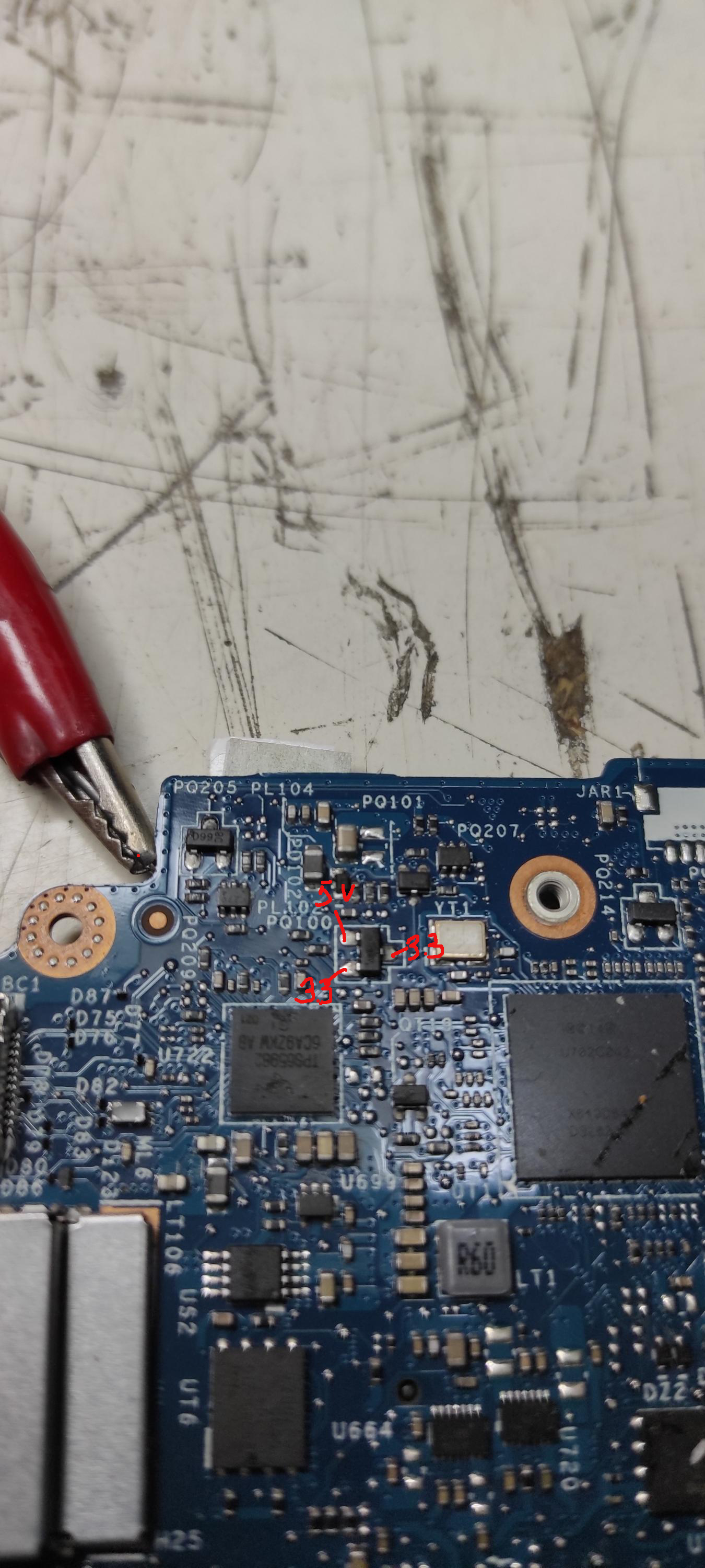

                    Sorry to jump on an old thread here, but I have come across a very similar issue with a small twist. The TVS diode, PD102, and burned one side of the trace. See pic below. I did find what I think is a compatible donor from a Dell XPS 9560 board, 2nd pic. From what's left of the trace, it appears that it went to both the resistor marked #1 and cap marked #2. So ISTM I could attach a new tvs diode connecting to what's left of the trace at #2 and run a small jump from there to #1, is that right?
                    As usual thanks for your suggestions.

                      Re: Dell XPS 13 9360 No charge
                      Seems right to me, take a look at schematics to be 100% sure.
                        To me that looks like some residue/gunk/whatever. Is that really burned? Did you try cleaning it with IPA or nail polish remover (careful of course)?
