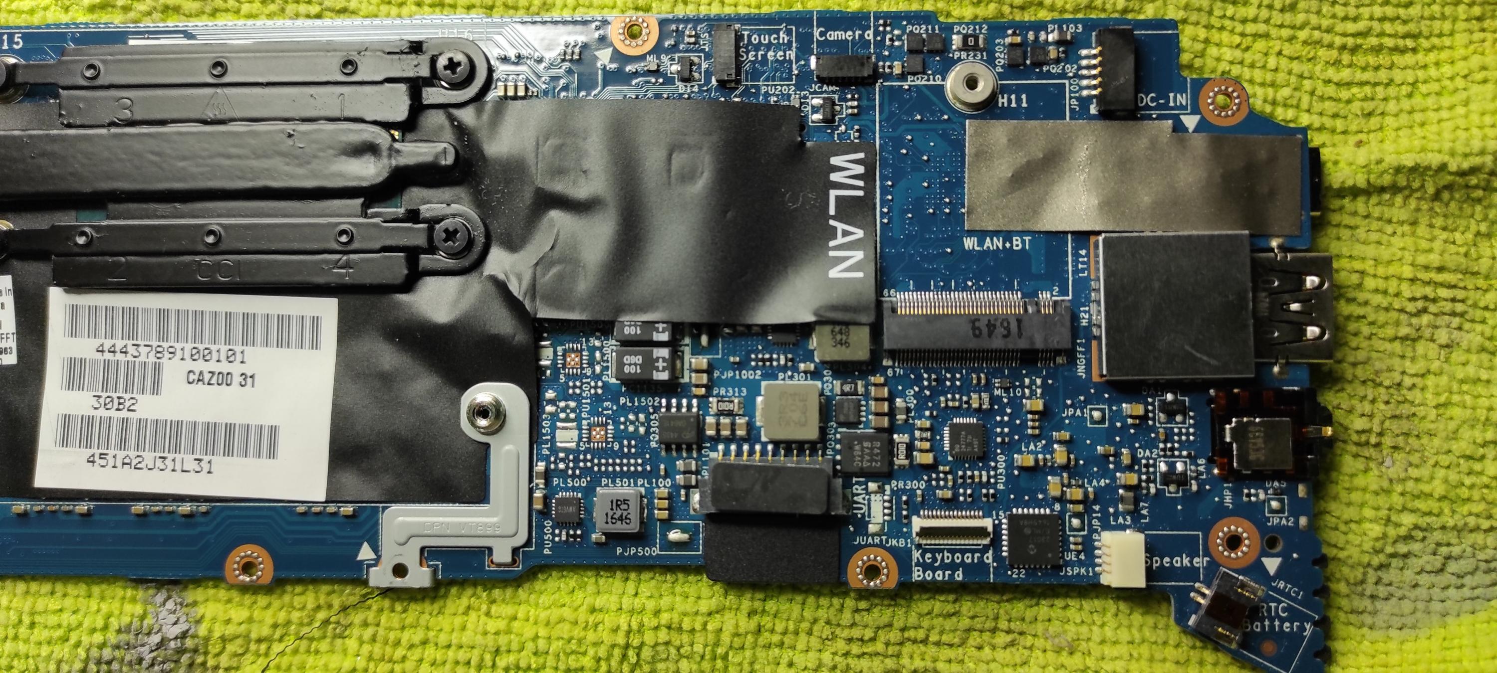

    Hello.
    I have a XPS 13 on the bench that doesn't charge.
    The jack seems fine as i put a needle on center pin and it doesn shortcircuit with the pin 3 that is PSID.
    Now, not sure if this is a real problem but i looked on PL102 and nearby is a tiny black SMD that looks bent and/or cold soldered (perhaps a diode?)
    I marked it with a red rectangular in one of the photos, unfortunately it's impossible to take a more clear picture as it's extremely tiny.
    What do you suggest?
    Schematics attached.
    Thank you in advance!!

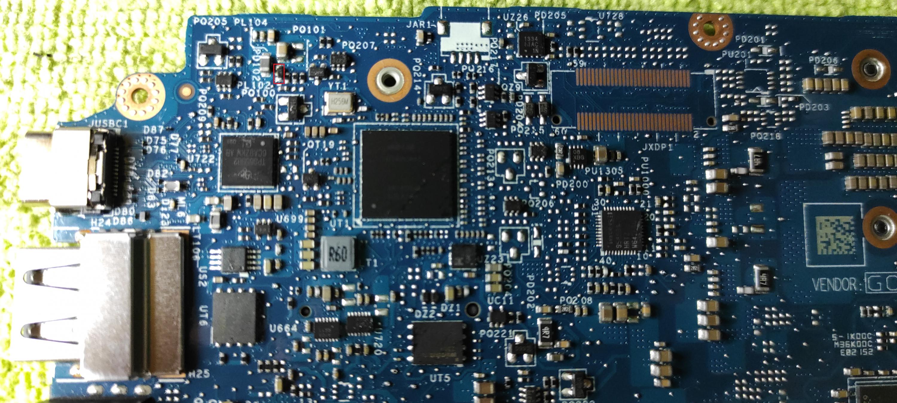

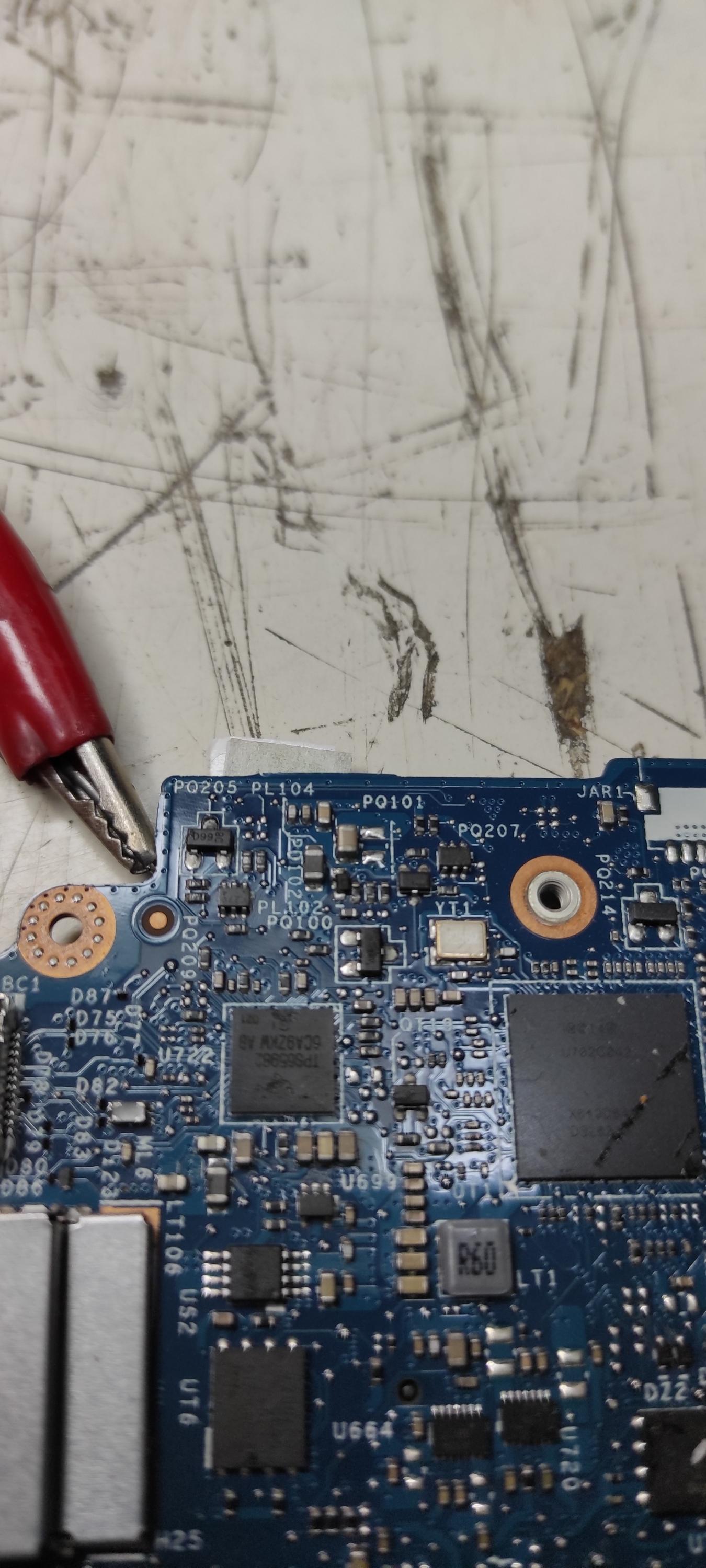

              Re: Dell XPS 13 9360 No charge
              Near PQ100 i see one black resistor that has continuity in both pin.
              Right above the PQ100 though is the black SMD i mention in first post that looks weird, is not straight and on bottom pin i see the PSID but not on the top.
              Check the picture, is very close
                • 22084
                The black SMD part is PD102

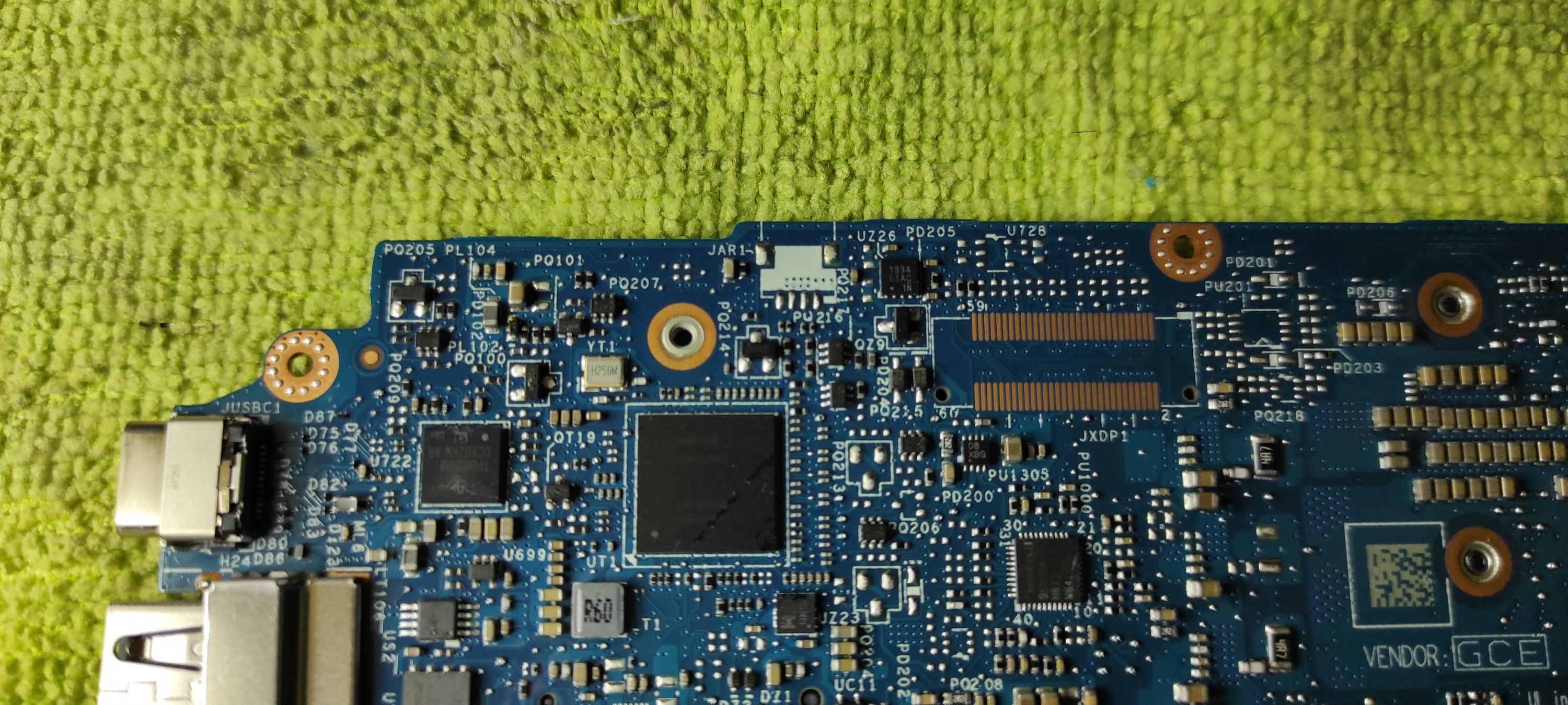

                        • Andreasbest
                          • Aug 2014
                          • 1196
                          • Hellas ( Greece )
                          I think is this (red rectangle), no sign of PSID in either pins, haven't check voltages yet.
                          Is this the PR103 though?

                            I checked voltages on PQ100 too
                            I only see 5V on gate pin and 0 at drain.
                            I check only the motherboard, without battery connected by the way.
