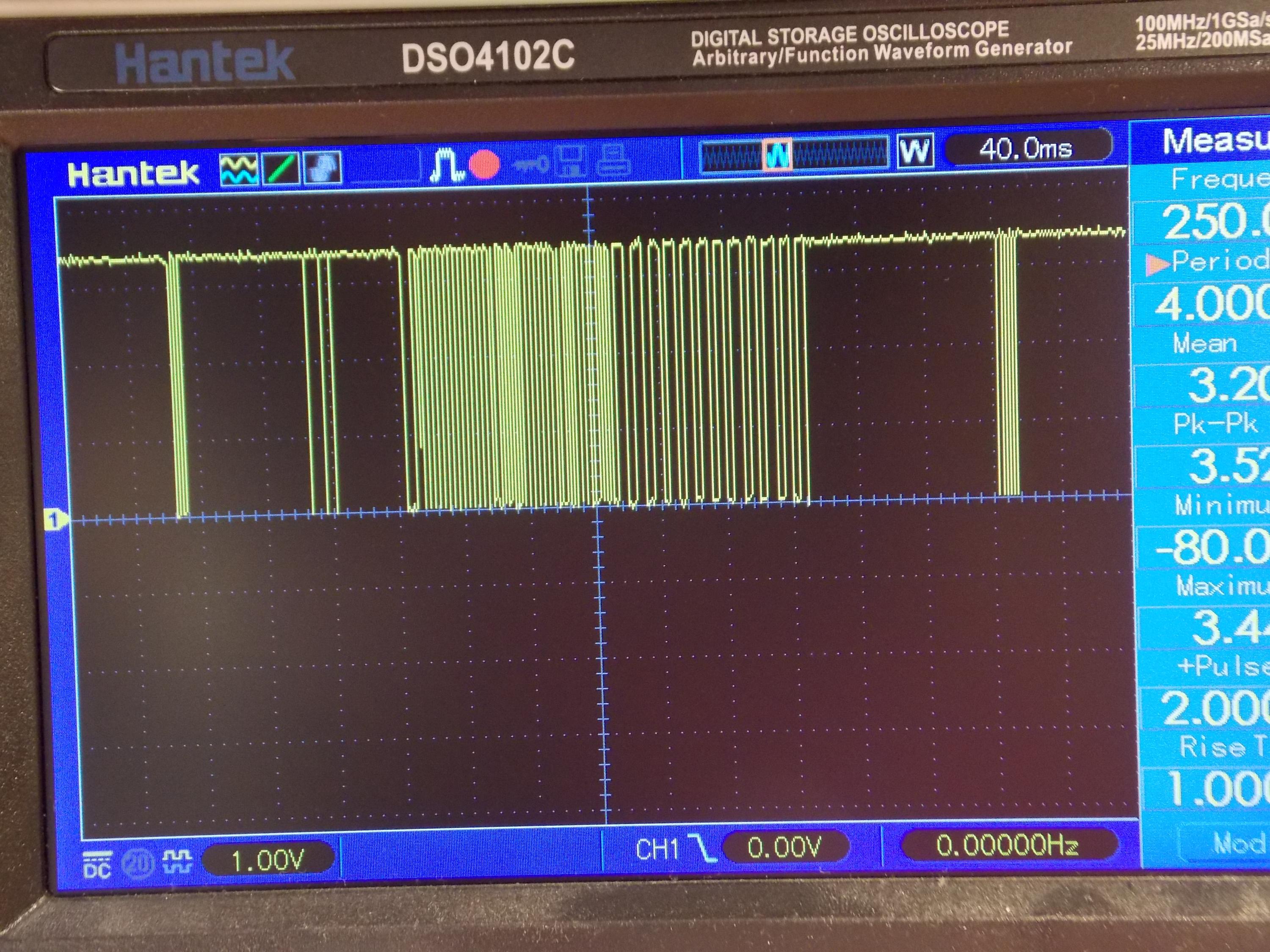

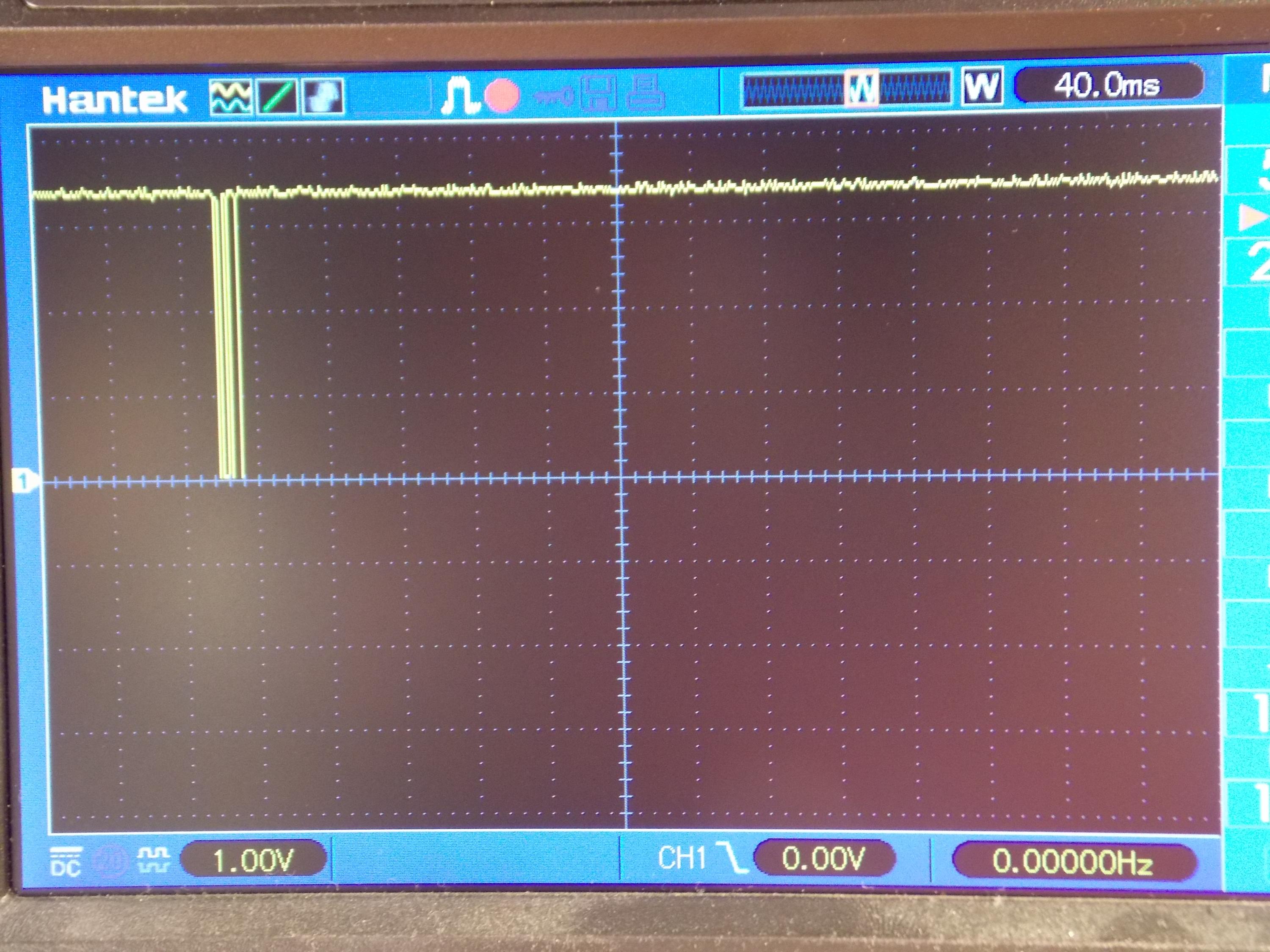

    Hi guys, so i have 820-00165 with no brain here. Powering on sequince looks like this:
    DCIN jack in -> 14second 0.4amp -> restart -> 0.4amp allways on no chime.
    Working board looks like this
    MagSafe in -> 0.54amps ->0.30amps ->chime
    My board bios CS activity: DSCN1077.jpg
    Working board CS activity: DSCN1076.jpg
    Looks like its only first pulses of bios activity, maybe thoughts what can cause this? Tryed to switch bioses between boards, same thing happens, so we can rule out bad bios. Termination resistors and vias cheked. Do i have bad PCH ?

    Re: 820-00165 No brains, no chime. BIOS CS comparisson
    Update:
    Replaced SMC between these boards, no effect, conclusion SMC good.
    Reacts to SMC Bypass, max fan, no chime.
    Does not react to PRAM reset.
