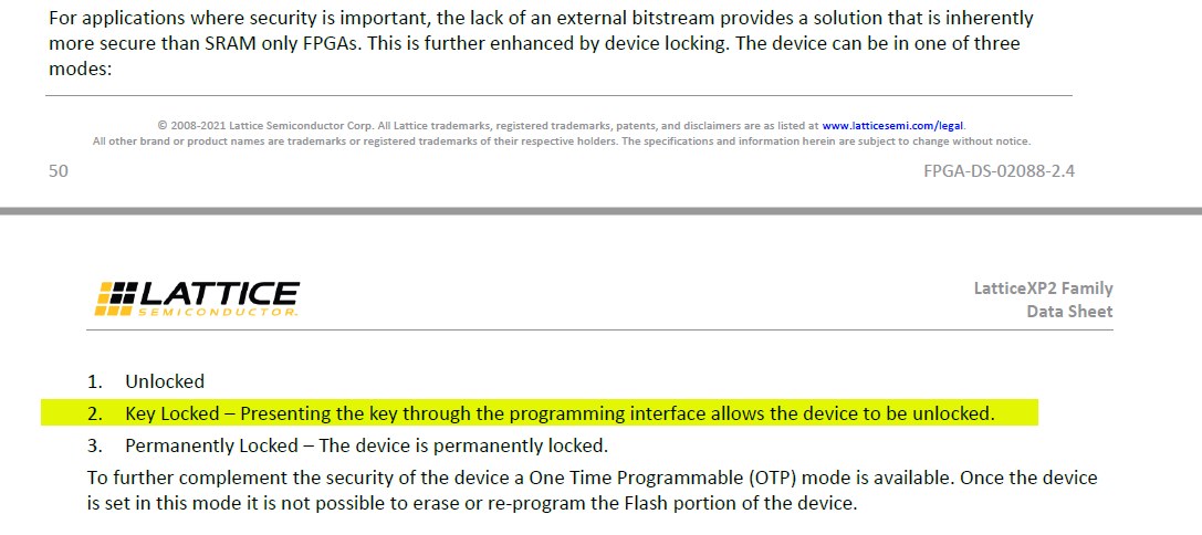

                        • mon2
                          • Dec 2019
                          • 14628
                          Re: Apple MacBook Pro 15 A1286 Demux IC Programming Mod Help.
                          Originally posted by dellxps15
                          totally agree. i wonder if with that tools i posted up those who already have the lattice programmer are able to read and save the firmware...
                          The Lattice website should offer the programming tools for this FPGA. Lattice Diamond should be able to perform this programming task.
                          From past experience with Lattice, they use the FTDI FT2232H controller inside their USB to JTAG programmer and the FTDI USB IDs onboard this controller are required to be enumerated & supported by their toolchain.
                          However, based on the quick review from this morning about this FPGA MUX fix, most likely the FPGA is security locked by the DosDude mod. Not sure as we do not have this logic board in house that I am aware of. A possibility exists that if a logic analyzer is used during the JTAG operation, then the raw dump of the FPGA could be extracted. It is more of a pain to do this than to pay the author for the original development time and to encourage future support.
