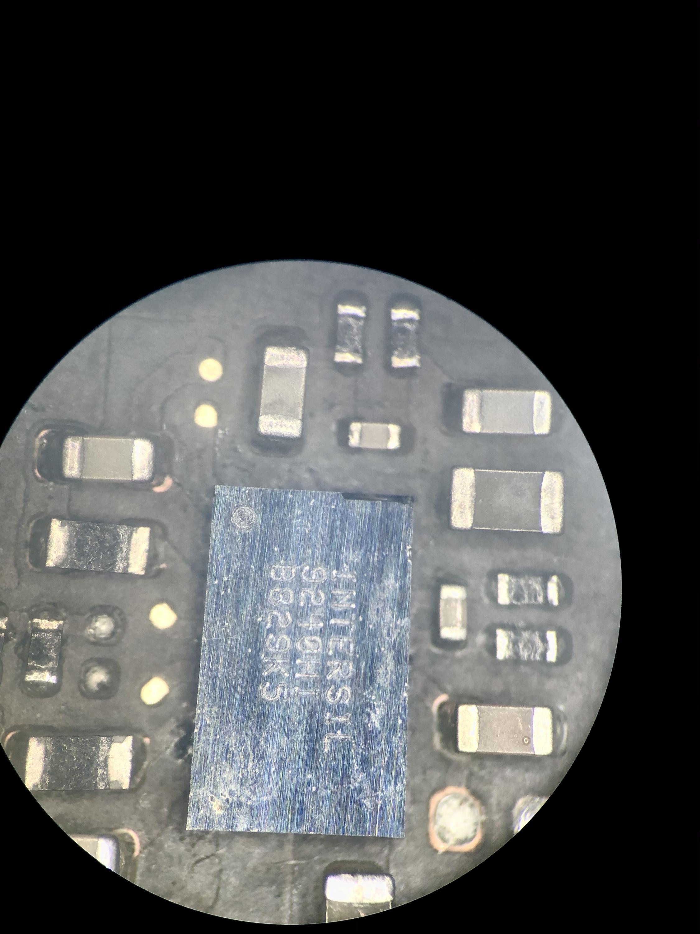

    Hello all,
    this board is drawing 0.00 - 0.13a (jumping) with 20.3V
    I assume all cd3215 are ok.
    U6940 has 3.3v on pins 1,3,4 but 0.00 v on pin 10 (chgr_rst_in_r)
    By the way L7600 is showing 0.03v,pp5v_g3s is missing.
    U7000 was already treated (picture below)
    Thank you in advance!

    Hello all,
    i measured all Power Rails. there is a lot of missing and PPBUS should be at 13.1V i think.
    It looks like PP5v_G3S is not created, the Enable Signal is 0V as well.
    The device can be put into DFU Mode but the repair aborts.
    Any ideas?
