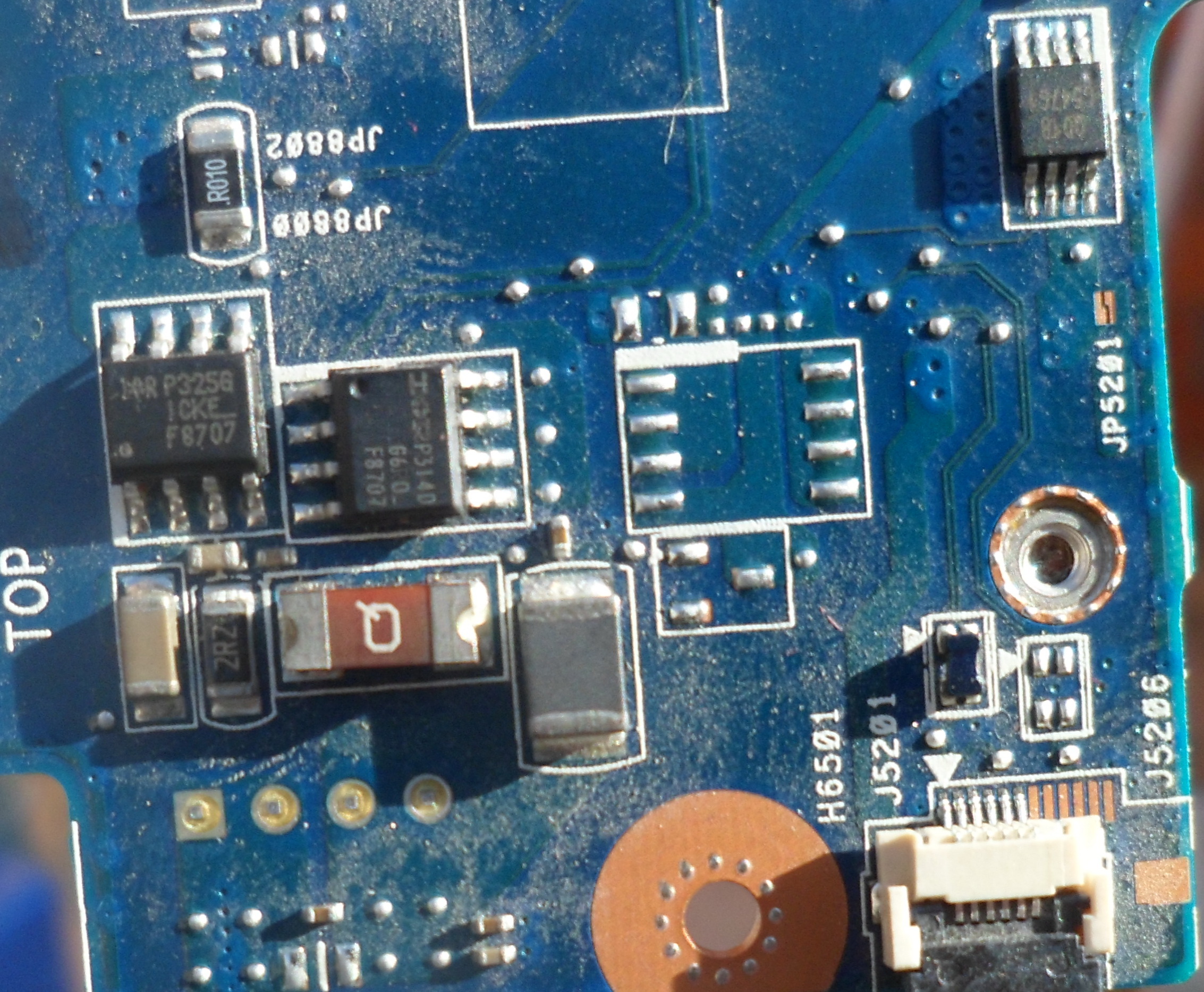

i need a replacement of IOR P325G
  • kadi144
    • Aug 2015
    • 690
    • algerie
    hi alles i need a replacement of IOR P325G a mosfet in toshiba
  • R_J
    • Jun 2012
    • 9535
    Re: i need a replacement of IOR P325G
    The number to use is IRF8707
    • ktmmotocross
      Boardkiller
      • Feb 2014
      • 3577
      • slovakia
      there are so many replacements ic. u dont need same brand
