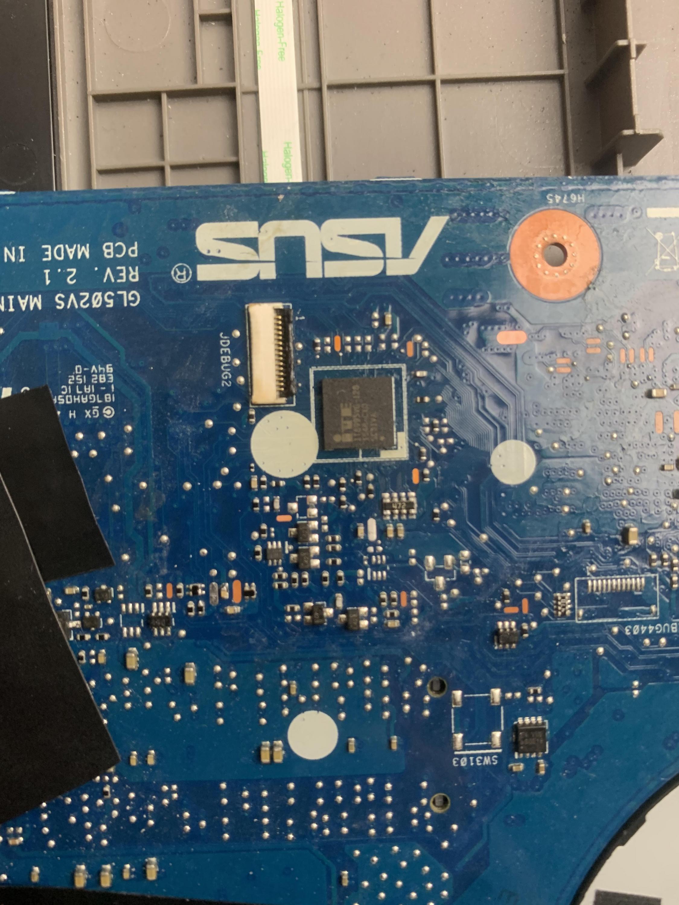

    Hey guys, hoping someone out there with some more experience than me can help. I got an ASUS GL502VSK, It was working previously but in an attempt to solder a battery to the board (connector was ripped off by previous owner, missing pads) the IT8995VG-128 chip was fried. The computer was completely functional apart from the battery before this point. I did voltage injection, realized that the chip was getting hot. I then sourced some new chips off Ali and replaced it. Now it powers on but does not post, full fan spin and blank screen. I then reflashed main bios chip to make sure it was not corrupt. Flashing the main bios did not change anything, still fan spin and no display. There is a debug port near the chip, so I assume it needs programming. I have scoured the internet and cant find anyone that has had to reprogram it, so I was hoping someone could give me some guidance. I have very little experience when it comes to programming, but I do have a ch341a programmer if that matters. Really hoping that someone can help me revive it, I appreciate all the time and effort everyone on here puts in to helping those of us that are less knowledgeable. Thanks!

    What did you flash the BIOS with? Did you retain the contents of the original chip?
    Power on the machine and let it sit for 3 minutes. See if anything interesting happens.

      You need a more specific programmer for this one, like Vertyanov or SVOD3. The EC will be programmed via keyboard connector, while soldered onboard. But this is all i know about.
      Maybe you're lucky, if you try another bios. Check DPWROK_EC for Voltage pls.

        I flashed it with a cheap ch341a programmer off amazon. I had trouble flashing it on board with the clip so I soldered the bios chip to the programmer. I pulled a bios dump from the forum, other people confirmed that it was working on the same model of laptop that I have. I will try leaving it on for longer and see if it posts. Thanks for your input

          Thanks for the reply, I apologize for taking a day to respond. I am very busy with school right now. I did see some other forums that mentioned the keyboard connector, you have definitely put me on the right track. The Vertyanov programmer looks like it should be able to program the ic. I think I should be able to reball and solder on the old chip, then use the programmer to copy the old chips contents to the new chip. Thanks so much for your help

            You don't need to solder or touch ITE chip
            Just use a keyboard connector strip to connect with keyboard connector on motherboard to attach with vertyanov programmer to programme it

              Ok, thank you. Do you have any idea where I could find the programming for the chip? could it possibly be stored in a bios dump? Or would I need someone else with the same laptop to read the chip?

                Some it's chip are non programmable
                Some are programmable
                So post in bios section ITE chip number and ask for ITE 128kb bios for it
                You will use another computer or laptop and install vertyanov programmer software on it and via usb your laptop will connect with your motherboard and when software at laptop asks for system you will connect your motherboard via keyboard connector using strip
