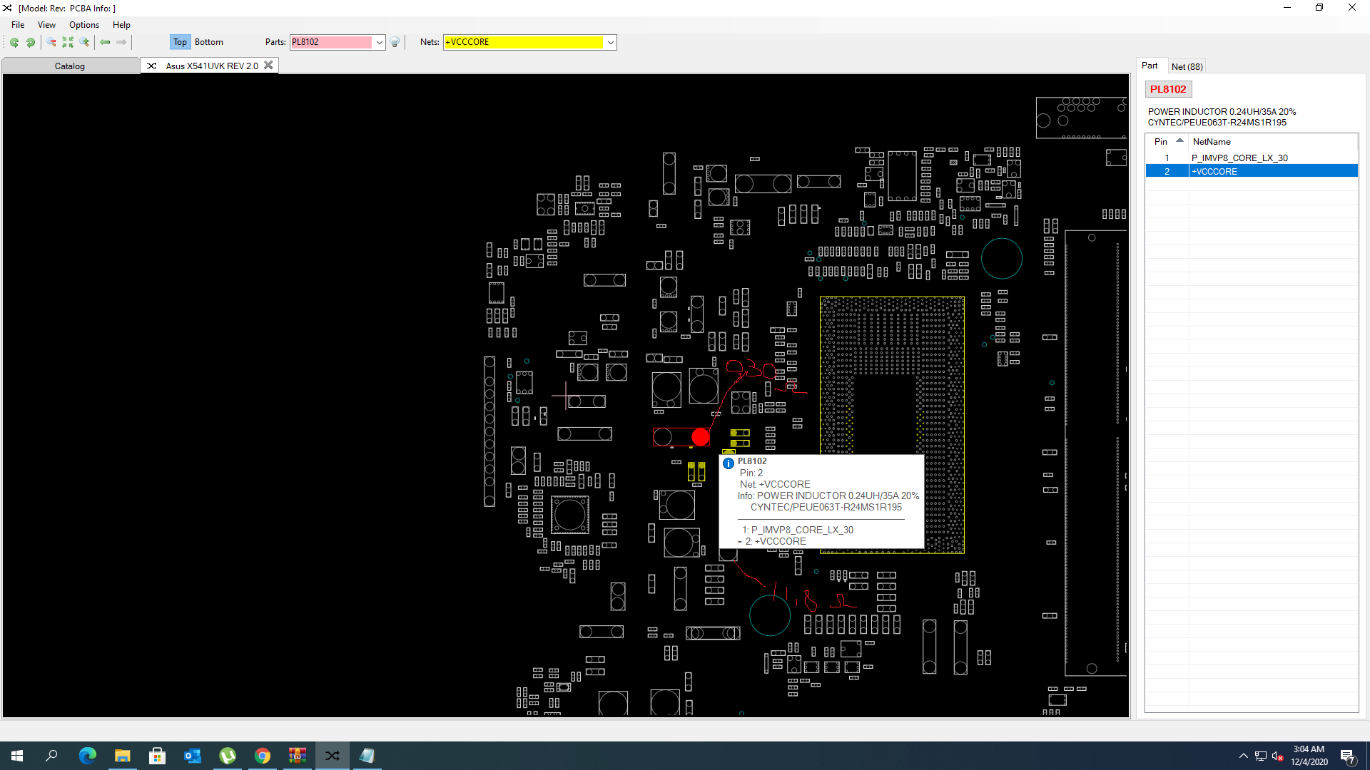

    Hello everybody . I have an Asus laptop that turns on but does not display the screen. I continued with the voltage measurement.19 v is ok 3.3v is ok 1.5 volts in RAm is ok. but in cpu I do not have 1.0v or 1.2v ... how much can the processor have. And the processor was cold ,, .. After some measurements I noticed that PQl8104 was short. I removed it and replaced it with mosfet 6414A I do not know if it is a choice but please tell me .. I put it in the charger I see that the cpu is hot but there is no image. I did the bios that I found in this forum but again the same problem After the voltages in Pl8102 it is 0v and in Pl801 it is 0 v..This laptop has NCP81216A chip. Please tell me what I can do to diagnose the problem. Thank you This is board view ....And the FAn not spining . I try to turn of laptop but turn on agin for 2 sec.

    Re-test all secondary power rails for short to ground and short to B+. Remove the CPU and power up the board, test voltages and watch for the board turning off.

      I not understan B+ can me explain ?.. And i not cant remove cpu becouse is soldered in board......... measure in ohm these two points minus the camera in the gnd of the laptop and + in PL801 and pl802

        0.3 ohm is a short. This plus CPU heating up is not good news. Interrupt the VCORE power line as close to the CPU as you can and measure the voltage on it. If the voltage is normal after you replaced the mosfet, and the mosfet you replaced was the high side switch, then there is a good chance the 19v went straight into the CPU and you now have a donor board...

          the mosfet is ok ... i close line in pl801 and pl802 but the cpu is hott . and voltage is 0.2 v in mosfett

            This means there's a short in the CPU and its pulling down the voltage, which is why you should test it by interrupting the VCORE line to verify it. Pull out the coil or some other component in the path to the CPU to verify. However, it does appear that your CPU is dead...

                  ok pl801 and 802 are behind the mosfet that supply the processor with voltage. that should give 1.5 volts or less .. when I disconnect these I have no voltage. yes it is logical not to give because the cpu is in shorttt ... In processor i have 1.0 v coming from 2 points pjp 8104 and 8303. when I disconnect these laptops it turns on for a while and turns off .. now I have left only pjp 8303 connected and the cpu heats up a bit. pjp 8104 connect +vccsa and +vcccio_cpu pjp8303 connect +1.0vo and +1.0vsus

                      If that's the case, I'd put an oscilloscope probe on mosfet gates. If nothing's there, then check enable signals on the DC-DC converter that feeds it, then the converter itself

                          No, I am asking about the gate control

                            the gate control not have voltage is 0v .

                                  CPU VCore should be around 6 ohms to ground.

                                    IN pl8102 i have 13.6 ohm to ground in pl8101 o have 0.13 ohm this point ore cpu vvcc core ?

                                      PL8101 is iGPU VCore but it should be around the same value than CPU VCore.

                                        then I have gpu in short
