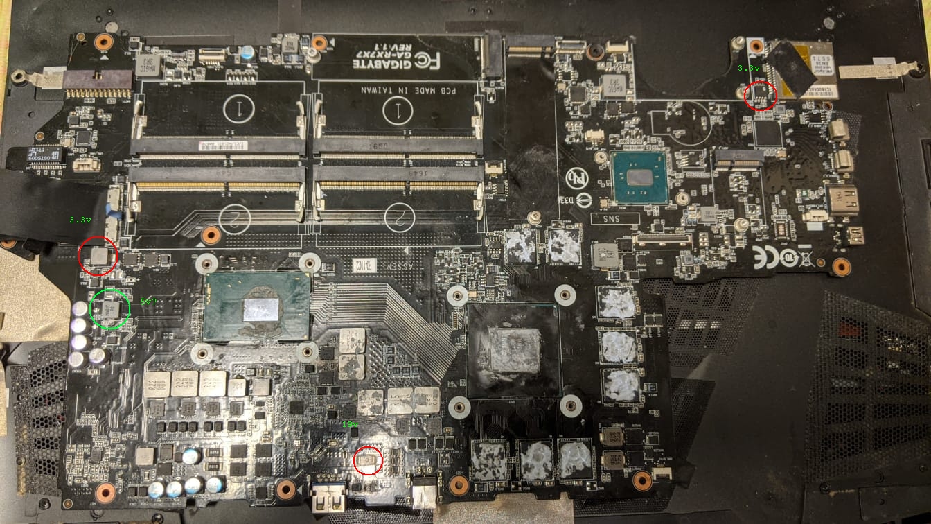

    Hi Guys
    This arrived dead and it looks like someones had a go at this. Working blind as I don't have boardiew/schematics. So far when I press the power button, 19v present, 3.3v on coil and on bios.
    Should I be looking to restore 5V next? Any idea if it should be on the coil next to the 3.3V coil? Currently 0v no short.
    Any other ideas wecome.
    thanks

    You can check voltage on all coils and without power impedance of coils. All should be above 300 ohm except three CPU,GPU and vccio and ram coil
    Without power
    Use beep or continuity mode of multimeter to check short of first two MOSFETs and voltage on gate of 2nd mosfet
    Pin 1,2,3, source
    Pin 4 gate
    5,6,7,8 drain
    If liquid damage then it must be cleaned first
    Mostly GPU area is effected

      Post the part numbers of all the QFN chips on the board.

        These are the ones I can identify:
        BQ24780 charger IC
        Asm1061 sata driver
        UP9511p gpu power
        Sic631 driver
        95855 multiphase vcore
        75dp159 HDMI
        Tps65982 USB/C
        Rts5328 controller
