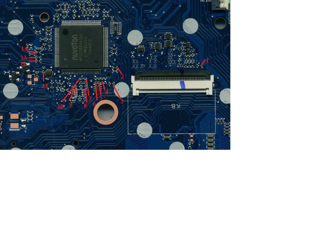

    Hello for all, I have this motherboard DA0X8CMB6E0 REV:E , if anyone has a donor to measure the values of the resistors indicated in the photo, at least approximately. thanks

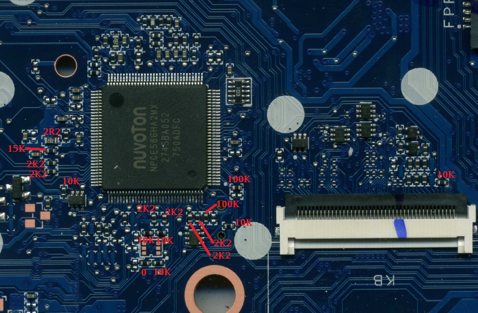

    I solved the problem by replacing the resistors indicated in the picture, can anyone help.
