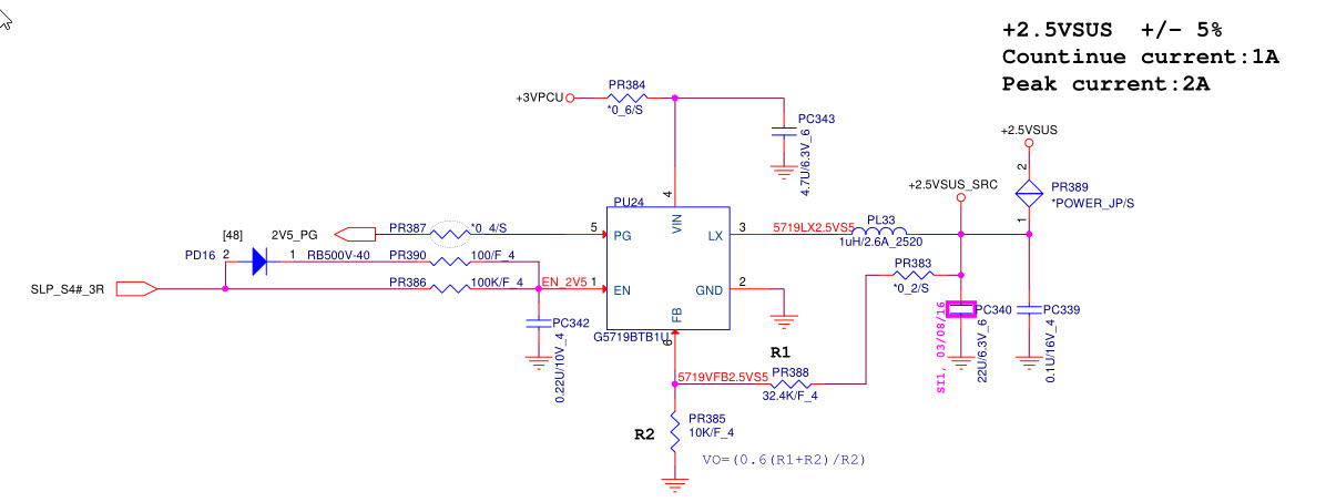

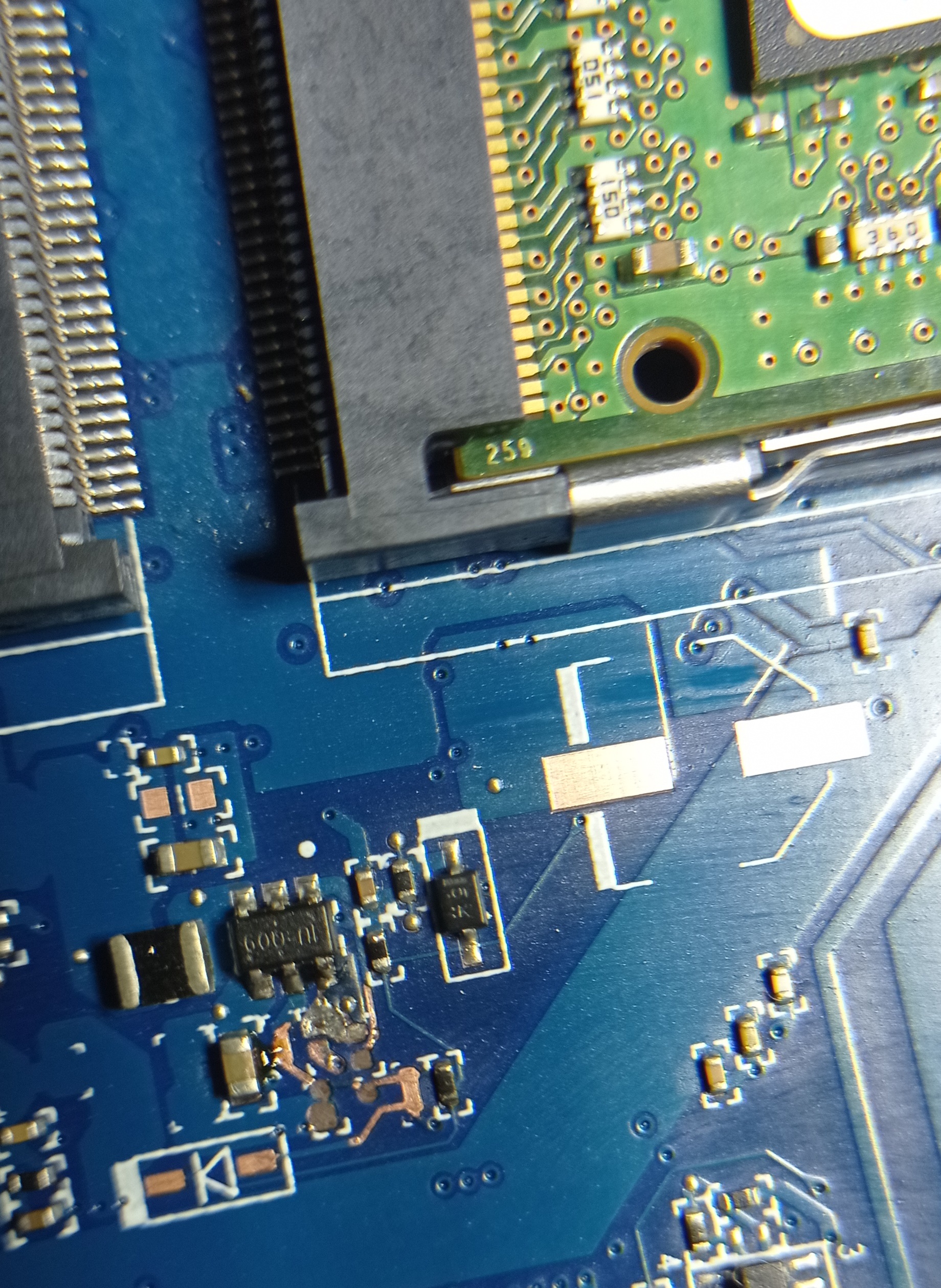

    i Have Hp ProBook 450 G5 DA0X8CMB6E0 REV:E Mother Board with Liquid Damage.
    i Guess here two resistors are missing.please some one give me the values of two missing Resistors,
    Appreciate your help.Thank you.

    Hi. Some mixed news.

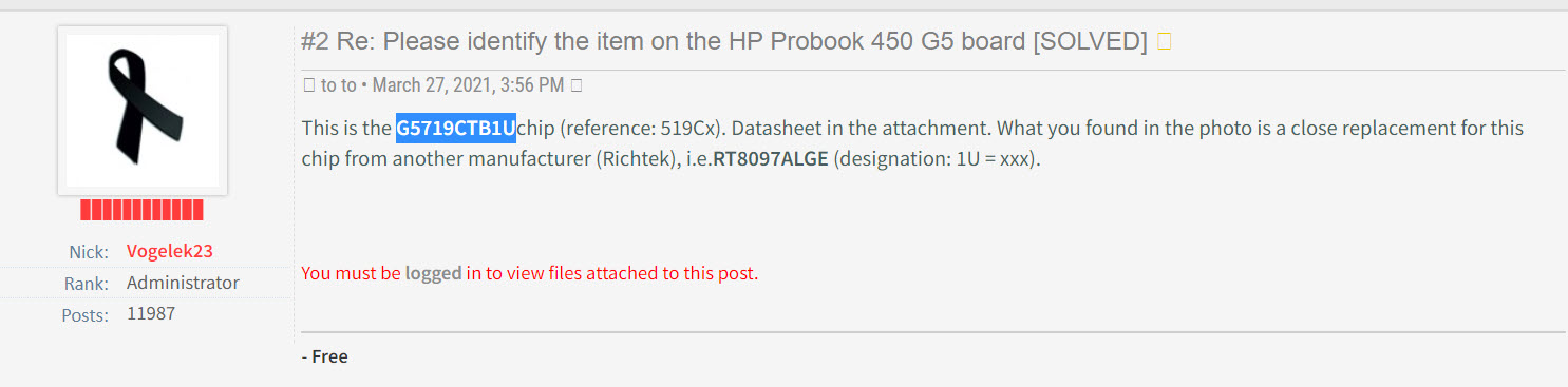

    1) The IC markings appear to be '1U=Q09' - is this correct ?
    2) '1U=' is the mark used by Richtek for their p/n RT8097ALGE. See attached datasheet.
    3) Using this p/n, unable to locate the regulator in the schematic for the DA0X8CMB6E0 logic board
    Updates:
    4) Mystery solved !!
    See here:
    https://www-elvikom-pl.translate.goo..._tr_pto=nui,sc
    and attached.
    HP logic board uses a different p/n in the schematic for which the Richtek is a drop in replacement
    If you search for the alias name - the regulator site and the requested part details can be found in the schematic.
