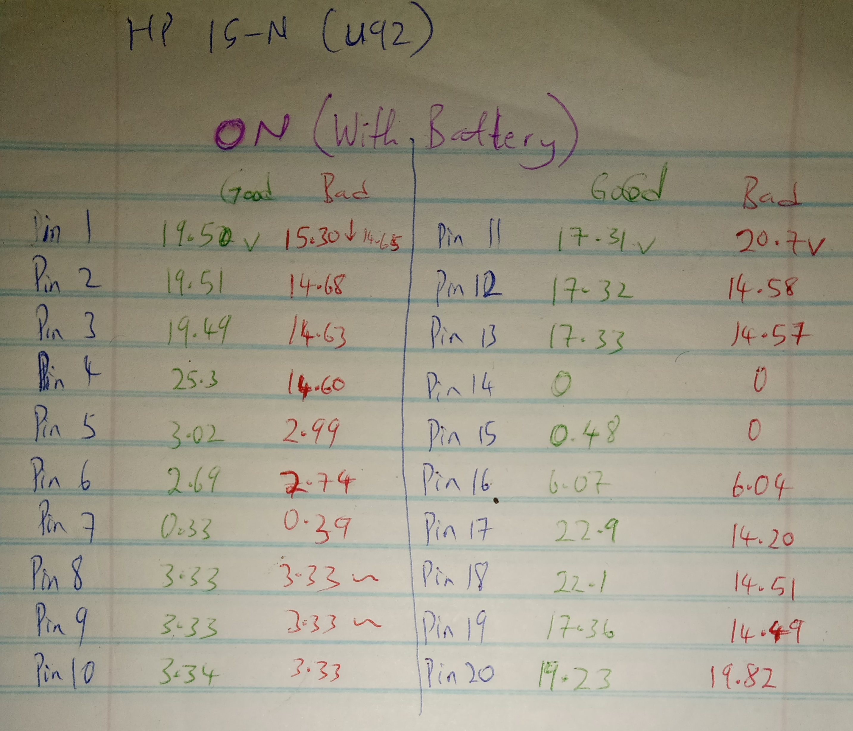

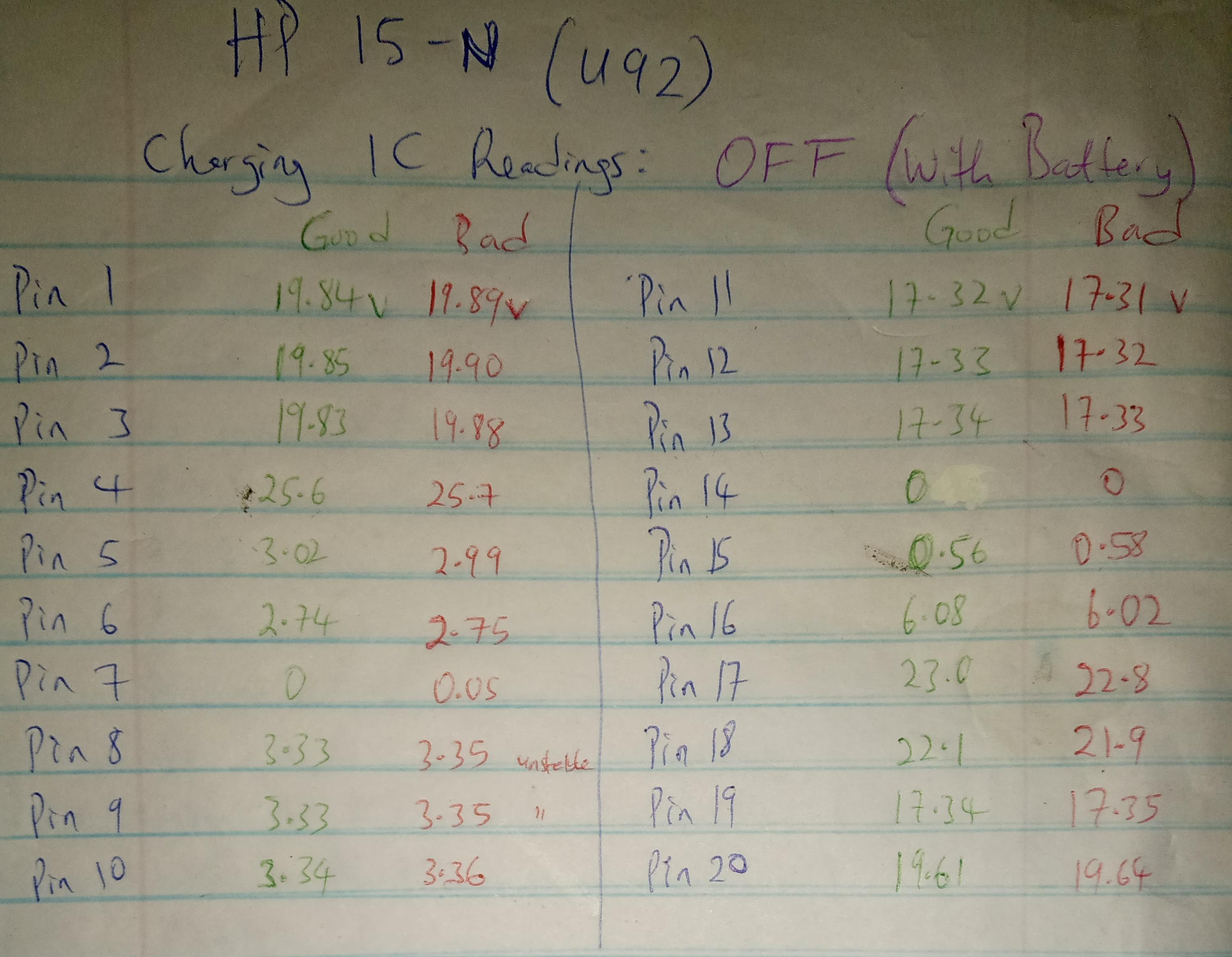

      Re: HP Pavilion 15-n (U92) not powering on with charger
      I have taken the readings of the charging IC [BQ24728] PU2 of a good board and that of the faulty board. Please check the images attached
      When the motherboard is switched off, it charges the battery but immediately i switch on the system (with battery attached), it stops charging...... The AMBER LED turns to WHITE.
      Please I need help with this laptop.... Thanks
          My HP laptop (DIFFERENT than your model) had similar symptoms.
          If you want to try something quick for a possible fix, replace PQ20.
          I had parts corresponding to MOSFETS PQ20, PQ21, PQ14, PQ15 and CHARGE IC PU2 replaced on my laptop.
          If you want to isolate to exact component(s), then take readings of Charging IC with only AC adapter, no battery, laptop off.
          Your readings OFF_with_Battery doesn't show much difference between Good and Bad.
          Perhaps readings without battery will pinpoint something to debug.

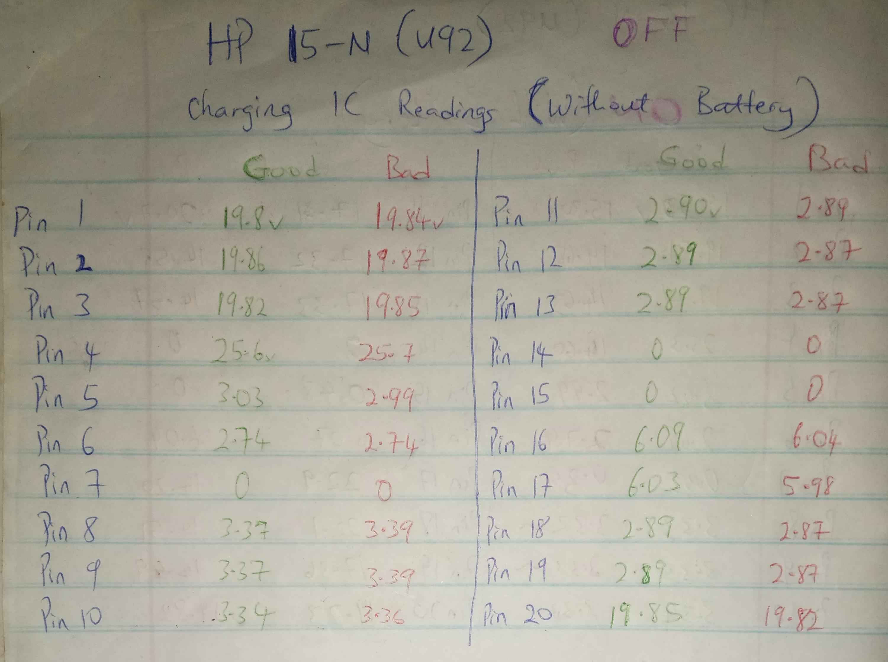

            Readings without Battery has been attached now
                  I would expect pin10 in OFF_Without_Battery to be 0V as it does in mine after mine was functional.
                  But IamPritesh may be onto something more solid.
                  According to your schematic, AD_ID is an input for "Smart Adapter Type Check" and produces AD_TYPE which is input to the SuperIO chip.
