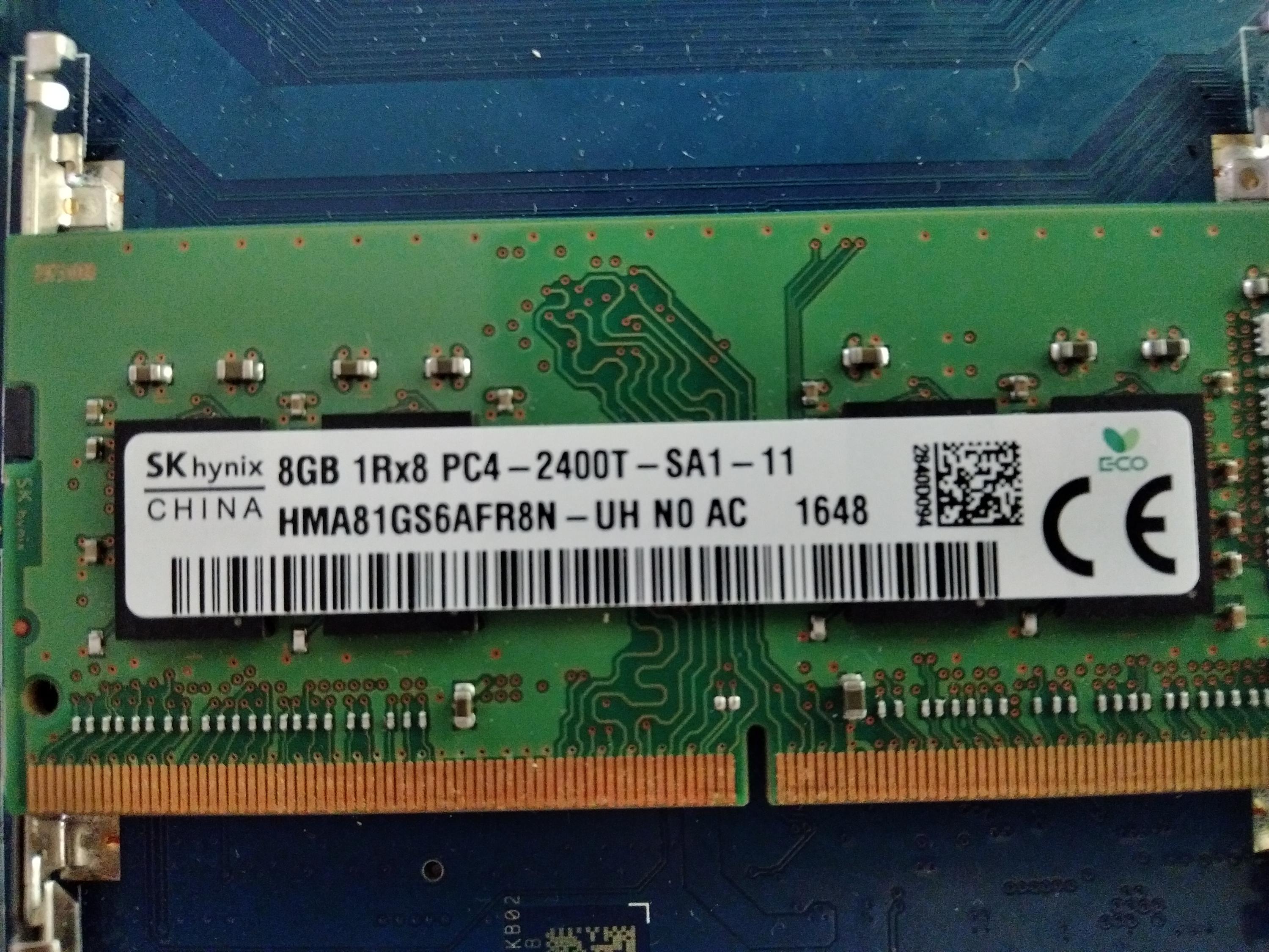

    HP omen laptop after bios update from F48 to F55 , laptop stop booting and giving caps lock led blink error 5 long and 3 short
    Following checked and still getting error caps lock blink 5 long 3 short
    1- RTC battery removed and waited 30min and again inserted.
    2- RAM memory Gold contacts cleaned and reseat.
    3- Power hard reset: Battery and cmos cell removed and checked
    4- Bios bin flash with working bios
    Need help to diagnose the issue

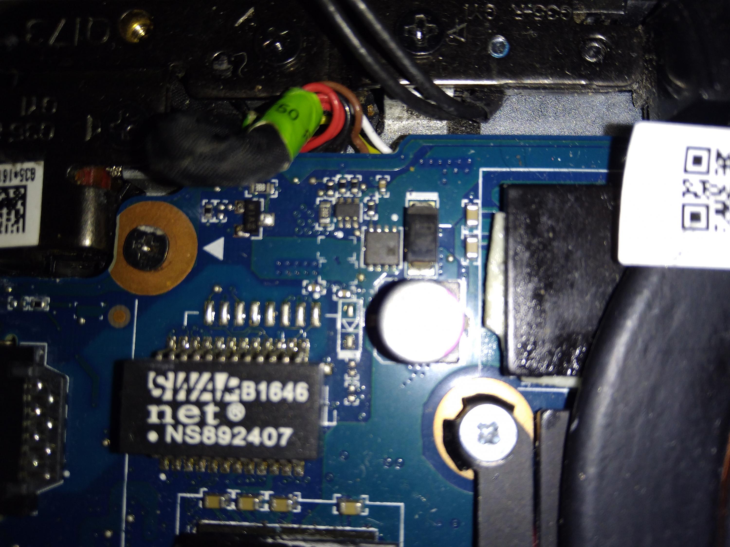

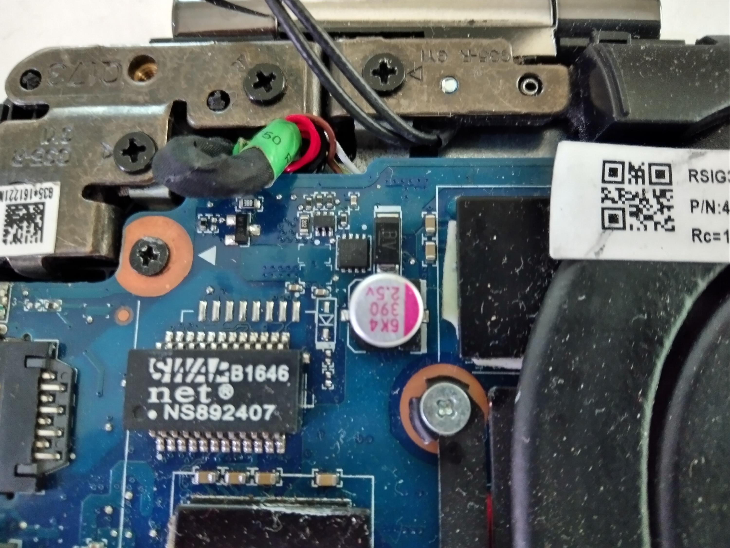

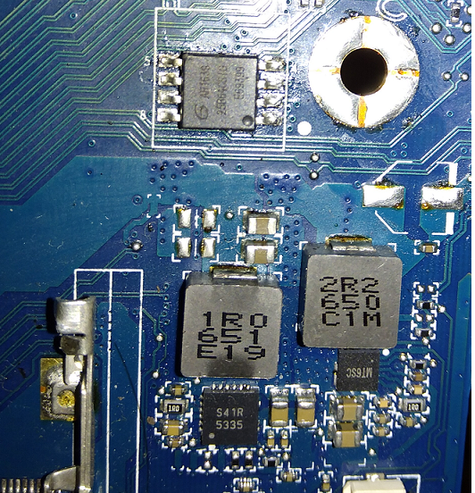

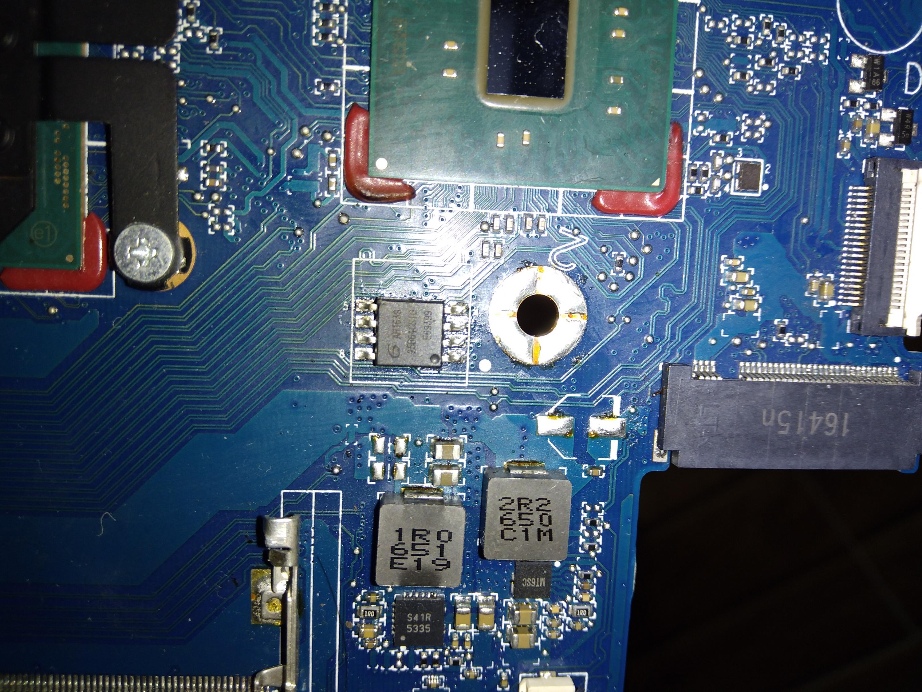

    Hi
    i am facing issue of no display on my laptop , i have gone through many steps as mentioned in above posts but recently i found something strange when i open laptop cover.
    Can anyone tell me whats wrong with this COIL , i noticed this and took a picture
    It is a coil for bulk convertor +1.0Vs5_s2 near RAM slot

        Re: Need help, HP omen ax236tx , no boot capslock blink 5long 3 short
        Originally posted by stingerchamp
        Hi
        Can anyone tell me whats wrong with this COIL by, i noticed this and took a picture ,
        It is a coil for buck converter +1.0Vs5_s2 near RAM slot
        is this coil ok.

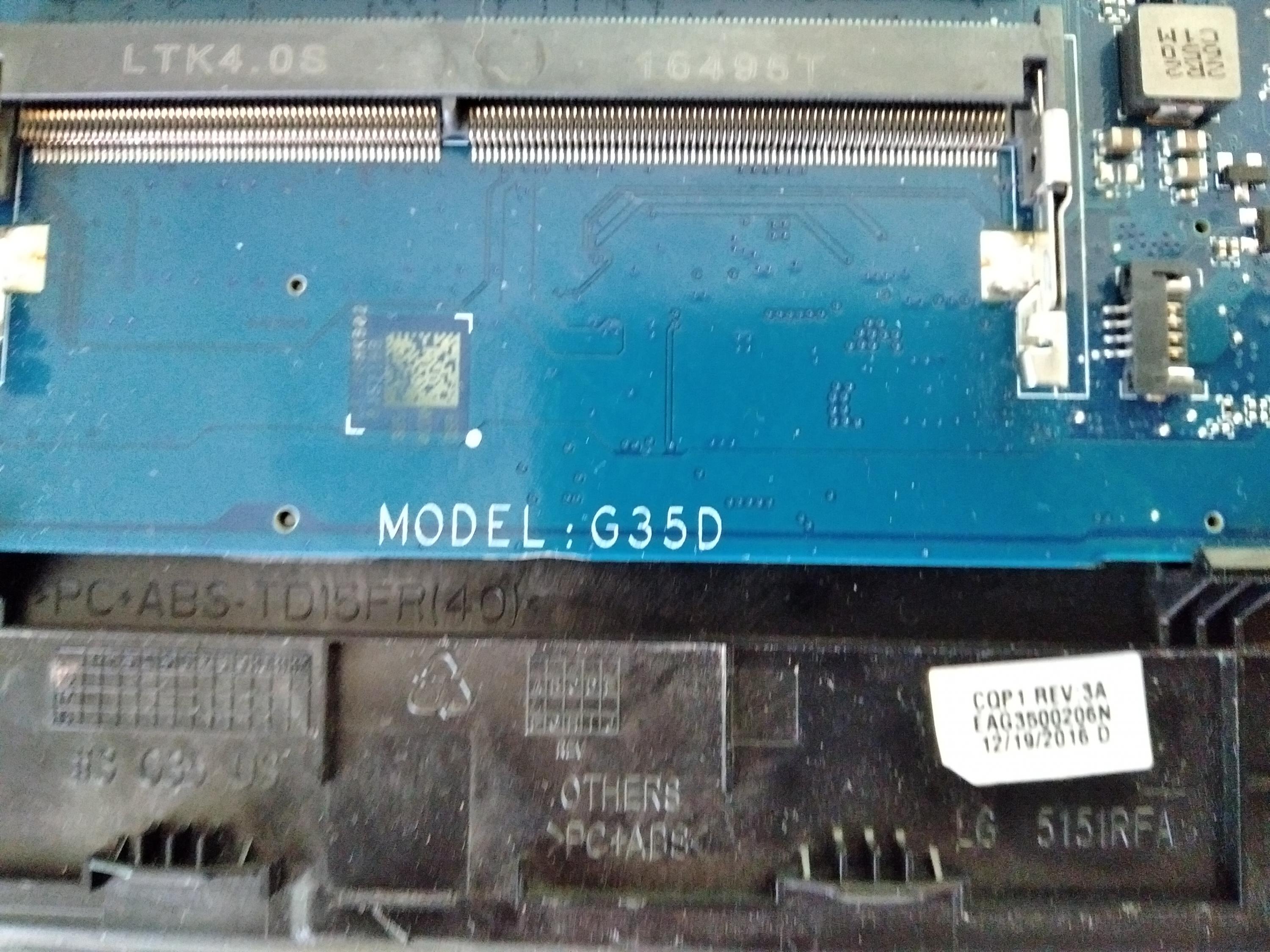

                Hi
                First of all thanks for your kind help
                Kindly share in detail as i am unaware of the pin number for DRAMRST signal and SYSPOWEROK signal, should i check it on memory slot pin 108 or at PCH pin (dont know) and i am also attaching memorystick and memory slot pic for your reference.
                I am not sure if the above schematic is valid for Quanta G35D rev D
