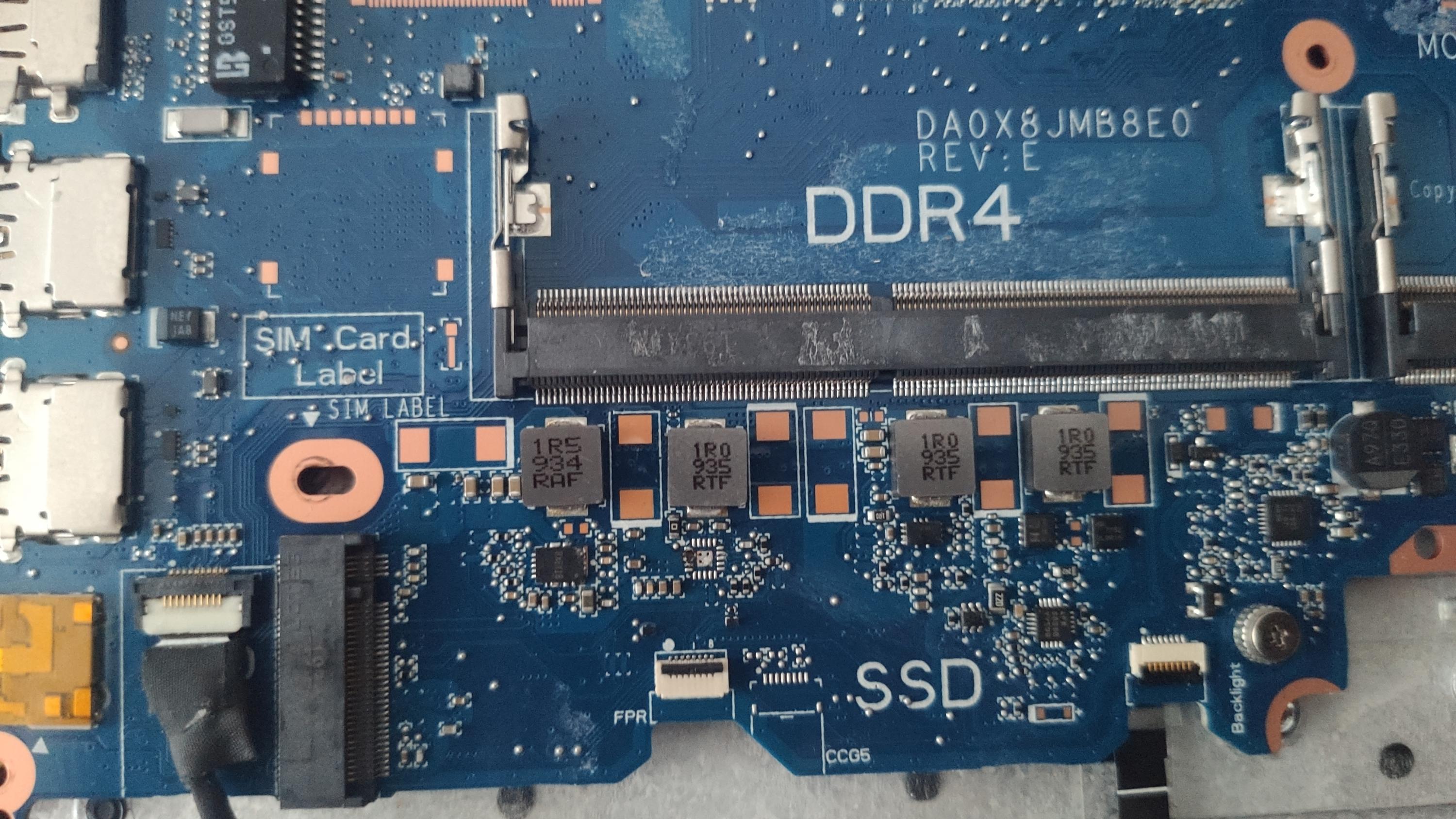

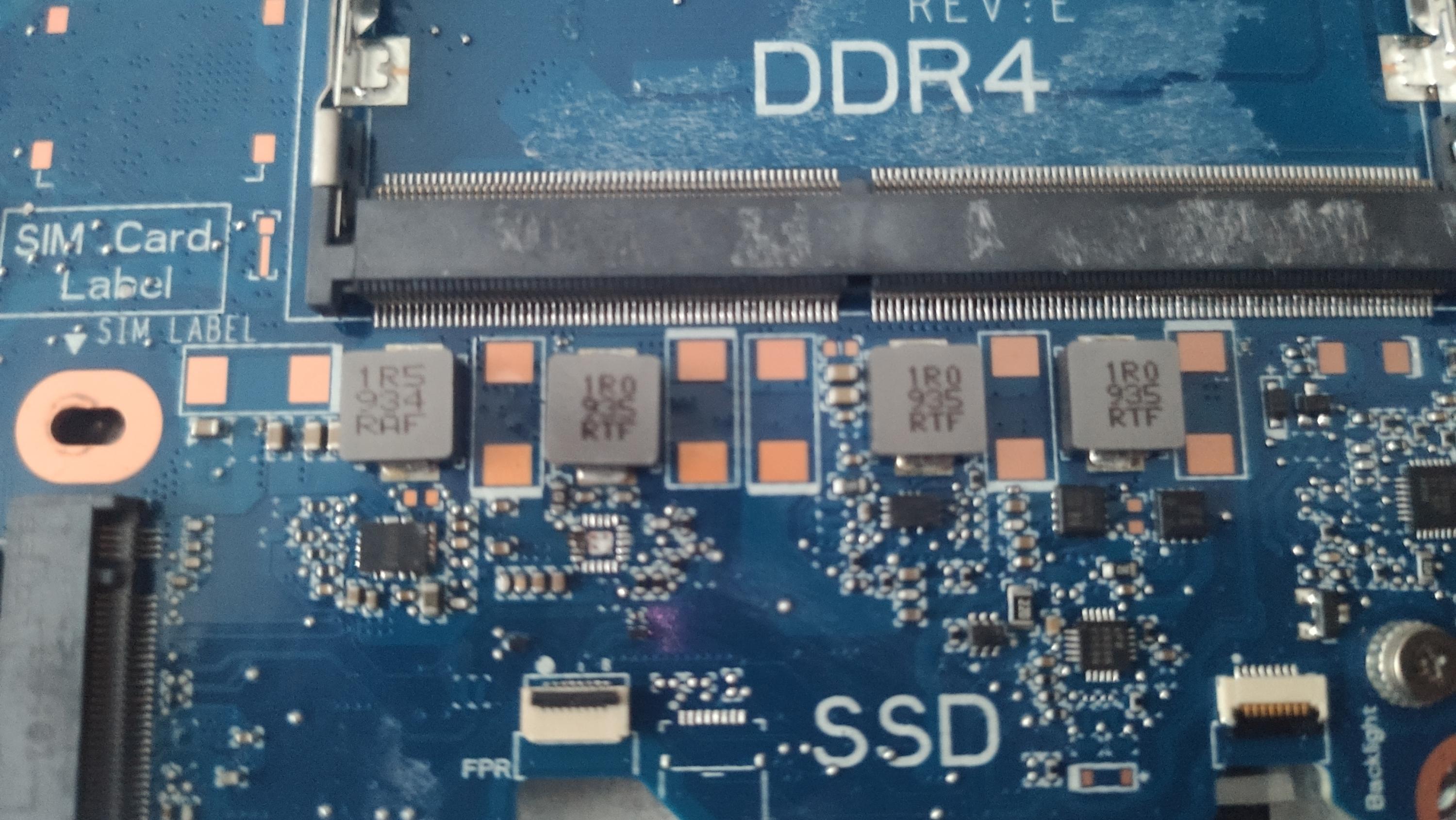

                Re: HP Probook 450 G6
                can you please advise me what it's like in the photo? was burned so I don't know what it is. or if someone had a scheme I would be grateful.

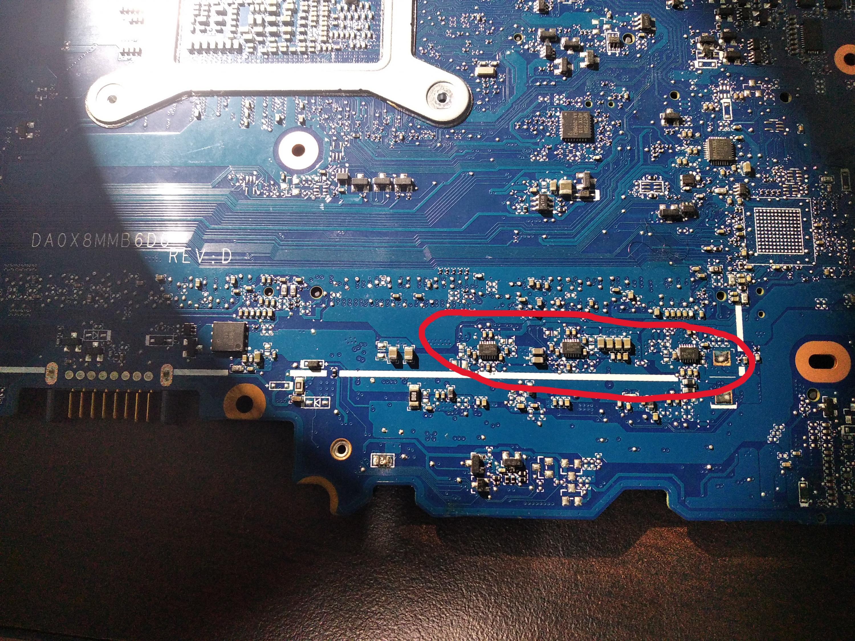

                    Hi There,
                    I no longer have access to the board is question but i have the attached board as a donor and have marked the chips i replaced to fix the issue i had. Unfortunately we were in a bit of a rush when doing this repair and did not test an individual component but replaced all 3 chips to fix the issue.

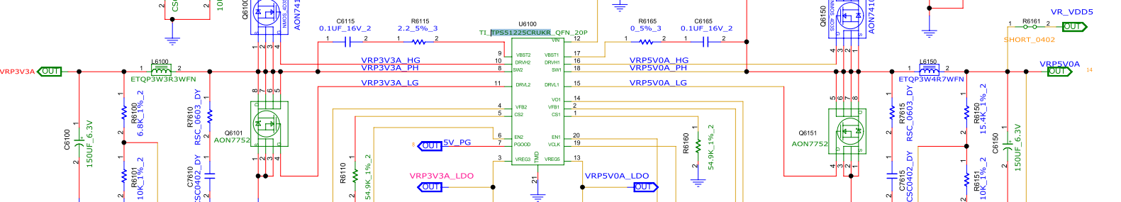

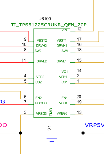

                            Is U6100 (TPS51225CRUKR) the component that is causing this problem here, as it enables the 3V and 5V buck converters?
                            Thanks for any helpful input
