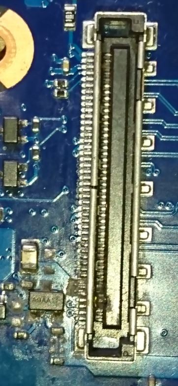

    I have an Samsung NP770Z7E with water damage.
    LVDS connector damage, burnt.
    Layer damaged a little bit...
    I found and order LVDS cable BA39-01208A.
    But the mother board connector also damaged.
    I no have schematic for Nike2-17H BA41-02194A
    But from 15" i found same 44pin connector:
    Mat code: 3710-003425 SOCK-44P-1R-SMD
    Where can I find same? ALiexpress ebay?
    Thank you

    if you can't find it, order a defective motherboard in your country, which has the same connector and remove it from there, there will be parts left.
