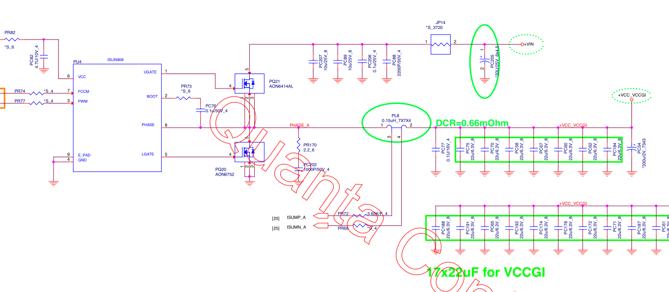

    hello, i have acer aspire es1-432-c79f, it is coming on, but the issue is the screen goes blank and sometimes the screen goes black, but the laptop is on, i already tried external monitor but same issue. i already flash the bios, but problem is still there, i already formatted the hard drive but still same thing problem still occur, also when pluggibg the charger the screen goes blank and sometimes goes blank. but i notice that everything works fine in safe mode... anyone suggestion to address this problem? thank you so much...

    Did you try another screen cable !
    Clean lvds connector .

                  Re: blank screen/black screen acer aspire es1-432-c79f
                  ok problem solve... i just replace PQ21 mosfet... and sometimes desoldering and soldering back PL8 will also solved the issue... and this is common issue for this model... i dont know why... but thanks a lot.... heres the thread that helps me...
