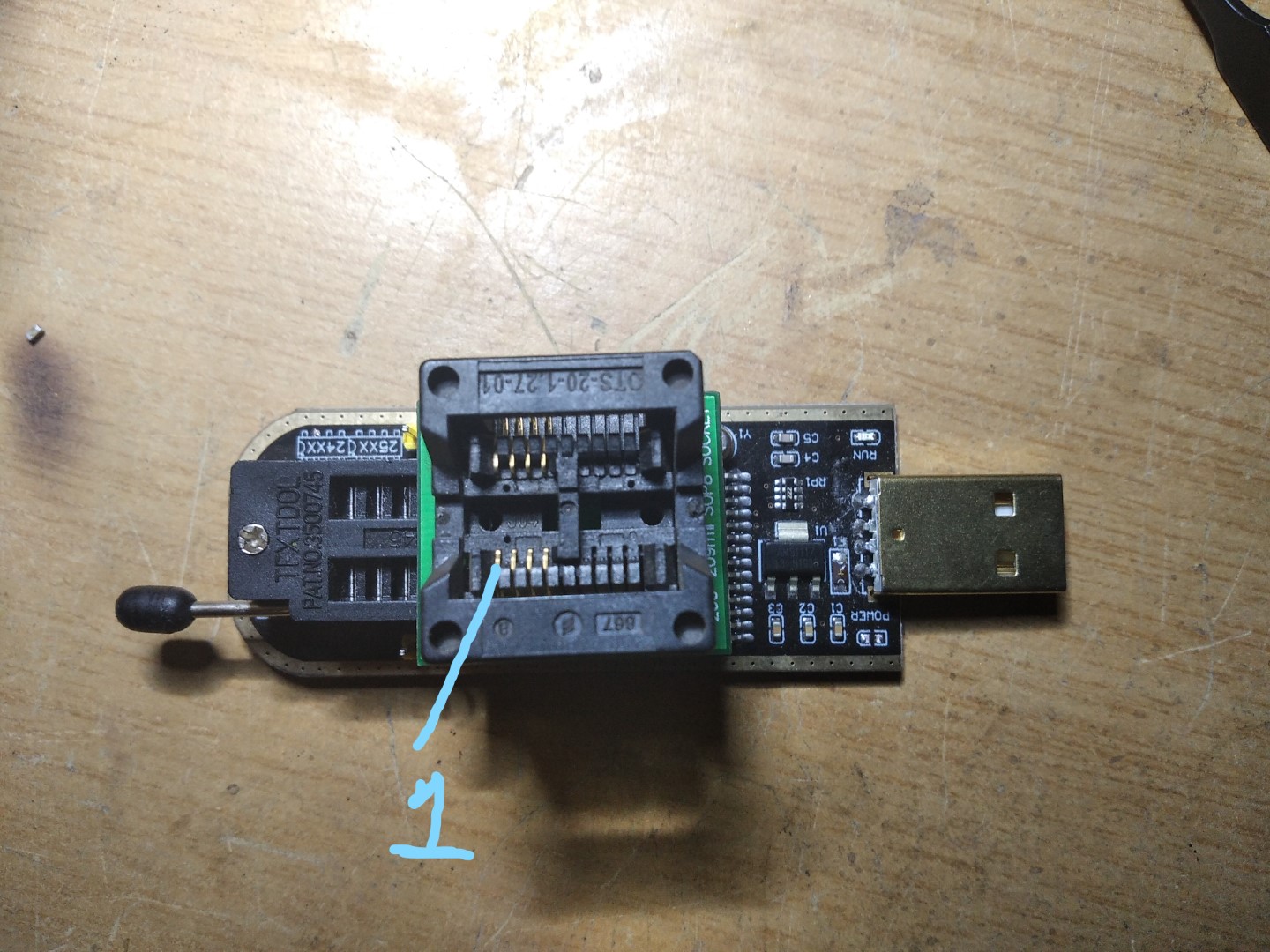

    Hello.
    I got a HP 8470p with SOP16 bios chip and a SOP8 CH341A programmer.
    I don't understand how to connect the SOP8 CH341A interface to SOP16 clip that i bought to connect it on 8470p and read/write BIOS.
    Can someone enlight me please??
    Thank you!

    Re: 8470p 16 pin BIOS and CH341A connection question
    Hi There,
    Please see attached image from my programmer

      where? your picture is an 8pin socket.
      @Andreasbest:
      download a datasheet for your chip, it will show the pin functions
        @Andreasbest:
        Yes i already did it, the CH341A has the pins i need on the right side. I'll upload photo when convertion is done.
