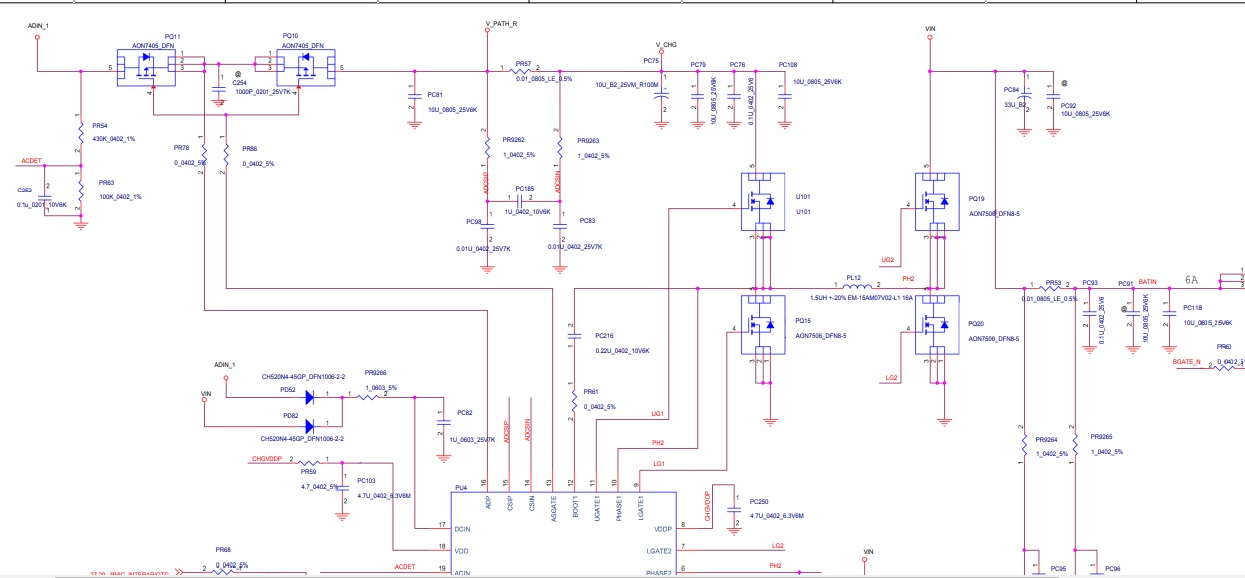

    Hi, i got to repair lenovo yoga 910 with mainboard nm-a901, found the isl9237 burnt, changed already 2 ic's, no 20v, only 5v. Can't find the reason. All resistor values seems fine.

    Make sure you have a good charger. 65w and above. Try the charger on another device that requires 20v and see if the charger handle it. I had similar no 20v issue and the charger was the main cause.

      Tried every variant of charger, do not work.
        • 20848
        Re: Lenovo YOGA 910-13IKB No 20volts
        Translate this it may help to understand the working condition of USB-C on this board,20V can`t be generated until all other conditions are met.
        https://www.chinafix.com/thread-1201120-1-1.html

          Thanks so much for the link. I have the same laptop and saw that the isl9237 is blown up. I was wondering why I did not have 20V, I also only have 5 and around 3.8 on some points of the board.
          I ordered a replacement chip, hope I will be able to replace it.
          I was wondering if the chip is compatible with the ISL95857HRZ that is mentioned in the schematic?
          I could not find datasheets, just compact ones that didn't contain proper info.
          It's attached for convenience. Does anyone know if this is a common fault caused by something that can be improved?
          I'm a complete beginner with reading schematics and understanding electronics and I am trying to learn so I'm very happy with that link, thanks .

                  Is there a short circuit at point V_CHG. The PU4 chip must be 19v on 16 17 pins. It should be 2.6v at 19 pins. Check PU4 PQ10.

                    I replaced the isl9237 chip, which was a plain nightmare .
                    I am unsure if it is actually fully connected, especially for pin 17, because I thought I saw a broken line - I have no microscope and it's seriously hard with a magnifying glass .
                    I used : https://www.chinafix.com/thread-1201120-1-1.html and the boardview that is posted and the datasheet here for isl9237 to get the points:
                    https://www.renesas.com/eu/en/docume...9237-datasheet
                    As far as I understand it, it is indeed PQ10 not going on. It has 5.1 on the input but the gate, which seems to come from pin13 ASGATE.
                    I have no measurement on that pin with dc plugged in.
                    If I understand the chinafix link, that seems to be the cause for the pq10 not opening?
                    I am struggling because I am way of my league and the boardview is not as intuitive as openboardview based ones.
                    Can I test if this is the issue by injecting voltage after Pq10 and if so where and how much?
                    My VDD and ACIN (pin 18,17) seem to have only 4V, is that the cause of the issue?
                    I'm a bit stuck now, but perhaps this answers @galleria1313 's question?
                    Can anyone help me on how to proceed? thanks a lot!

                      studied a bit further. It seems PQ10 does get 5.2 in and out, it was bad measurement I think. Again looking at the chinafix link, it seems VIN needs to be 3.3 V for the board to start at all, is that correct? And if that comes from pin 26 on PU4 there may be my issue.
                      Pin 26 is 0 and so is VIN for PQ19 . In my schematic I see U101, is that PQ16?
                      Unfortunately I don't understand it all well enough to know how to continue. I am happy to do measurements if anyone has suggestions. I thought about putting 3.3V on VIN and see what happens?
                      I don't understand the translation of the link well enough to understand the process completely...
                      oh, and my PR53 is about 0.52V, PR57 is about 5.2. As I understand it, PR53 should be 3.3V as the VIN for PQ19.

                              I too have this issue however shortly after the board quit completely, I found a board on eBay for a reasonable price that had a damaged inductor 1.5uh 16a Inductor I moved the inductor from my dead board 20v worked to the Windows login screen then started cycling rapidly 20 -> 5v -> 20v to which I responded by un-plugging the charger.
                              I thought maybe it was the USB C connector board... I ordered one. Same issue then shortly after it's permanently stuck on 5v.
                              What I find odd is that it will still attempt to charge at 5v powered on and will charge all the way if left powered off
                              I think it's the inductor however I'm tired of throwing money at this thing.
                              Will changing the inductor fix the issue, considering that the same issue moved from one board to another? And should I change the ISL9237 as well?

                                i have question (just for sure)
                                Can i replace isl9237 with isl9238?
                                ***EDIT> risked, replaced and all looks fine...20v output and charging
