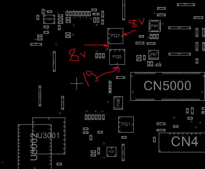

    HP 15-au057cl
    dag34amb6d0 rev d
    hi
    the power led is lit
    when pressing the power button, the 3.3v on the pin goes to zero
    on pq5: the volta are:
    +vin charger= 19v
    pins 1-2-3 : (islphase)= 8.72v
    pin 4 (islugate= 8.72v

    Re: HP 15-au057cl
    i think the problem is pu1 = ISL88750HRZ
    but cannot find alternative

      Re: HP 15-au057cl
      check the mosfets again. If mosfets are good, order the chip from ebay or aliexpress
