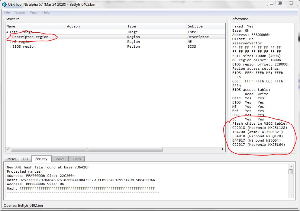

          I'm a little confused. The Macronix 25L6406E was the original chip installed at U50/U51 when I got the machine. Is it safe to assume the machine doesn't need quad SPI mode if 25L6406E was previously working ok?
          Is the VSCC table contained within the bios update to show which chips are compatible?
          EDIT: have I got that wrong about the VSCC table? Is this contained in the ME descriptor region? Sorry still trying to learn so this VSCC table will state which chips are compatible with the system?
          When you say 'a known good dump' do you mean of the ME firmware or the bios itself?

            The bios chip you bought is ok,provided it does have the correct bios written to it. Both bios chips are in the VSCC table.
            Winbond cross reference - https://www.winbond.com/hq/support/r...earch=25L6406E

                Re: Razer Blade RZ09-01953 suspect faulty bios, ordered chip but not the same
                To update.
                I got the chip programmer through and attached the Winbond eBay chip to it. I took a dump of the bios and compared this to the known good RZ09-01953 bios on here in notepad++ viewing in hex. I could immediately see there was an difference on line 8 of the Winbond eBay bios dump.
                I also soldered the original Micronix chip to the programmer and took a bios dump of that and found it to have a very different bios to that of the other two dumps.
                I cleared the micronix and wrote + verified the known good rz09... bios from here then reinstalled it into the machine.
