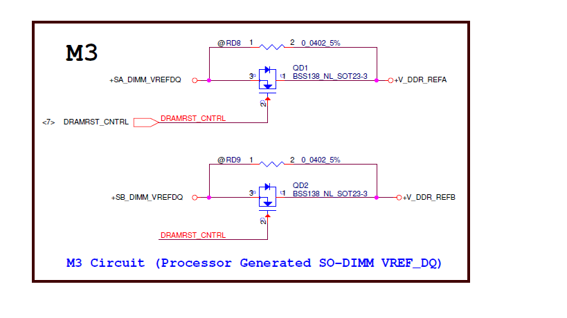

    dell 15 3521 4 Bips
    Hi guys. pls. dell 15 3521 4 Bips
    id mainboard : vaw00 la-9104p rev 1.0 a00
    i check all points PJP on mainboard all present. but Except point +vccp on GND
    So i check Ram voltage on slot DIMM
    - Pin N° 1 Ram vtt_ref_G voltage 0.72 v
    - Pin N° 76 Ram core voltage 1.5 v
    - Pin N° 199 Ram spdvdd voltage 3.3 v
    - Pin N° 203 Ram vtt2 voltage 0.72 v
    - Pin N° 204 Ram vtt1 voltage 0.72 v
    i Changed Rams & Battery RTC no result

    Re: dell 15 3521 4 Bips
    What about Pin30-Dramrst??
      thank u sir. i check
      On QD1 G=3.3v D=0.75 S=0.75
      QD2 G=3.3v D=0.75 S=0.75
        karim just to be more sure , pin 30 of JDIMM1/2 as mcplslg ask to .
        and voltage on all pins of QC2
