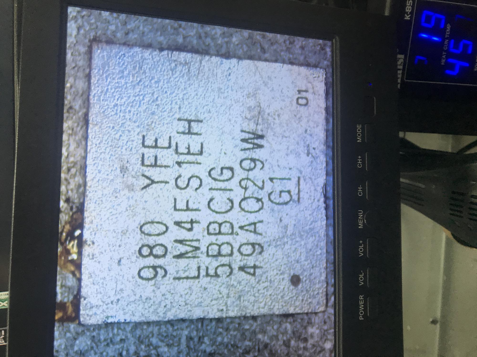

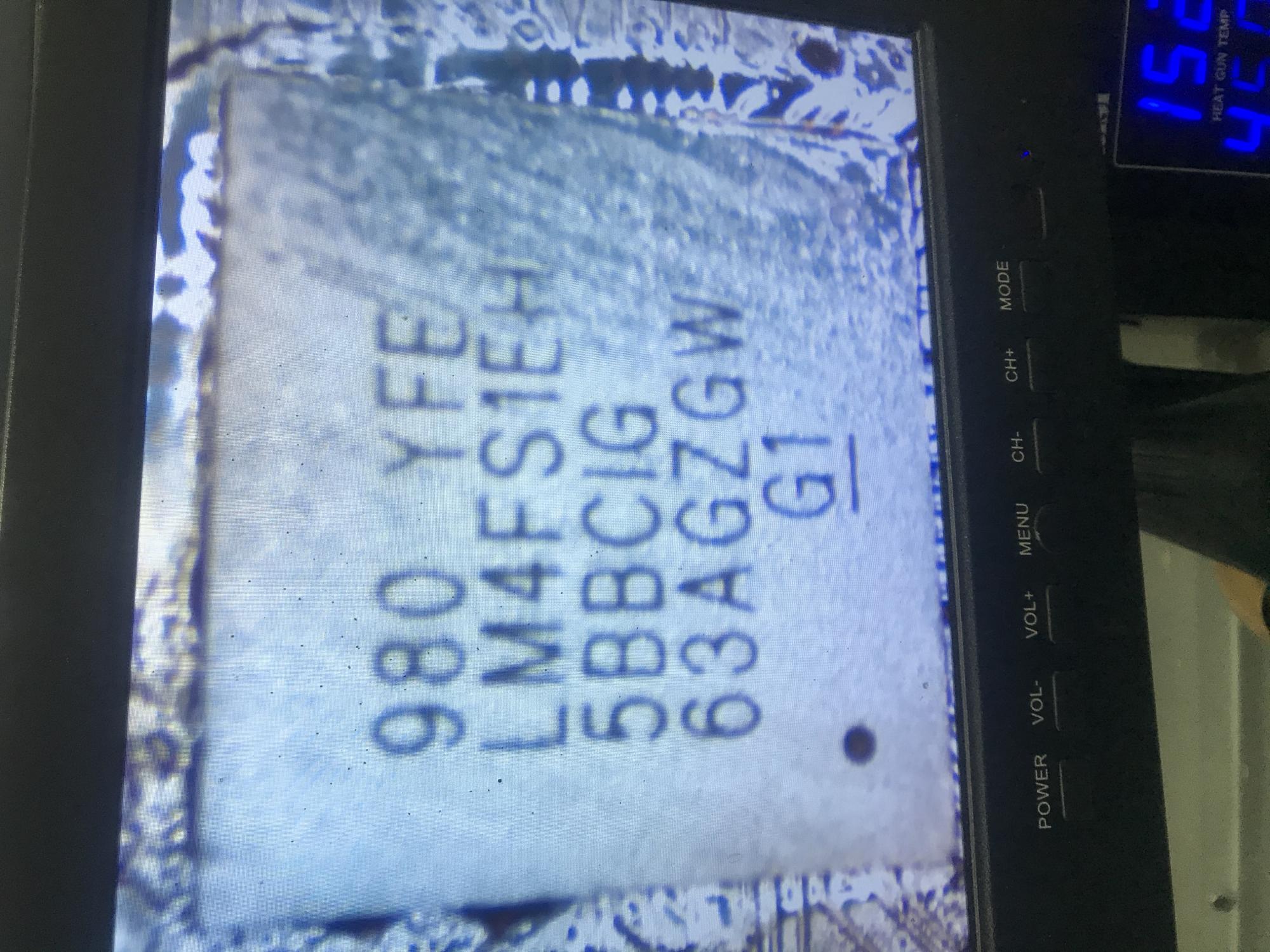

    Good day. Please help me:
    Its posible replace 820-00165 mac air SMC with 820-3476 mac pro SMC?

    No you have to use an SMC from the same model donor board. SMC from different model has different firmware.
