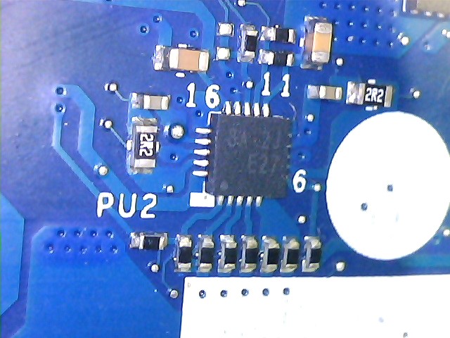

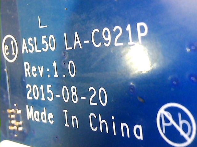

very hot ic
  • salmanzeiad
    • May 2016
    • 68
    • world
    very hot ic
    hp 250 G4
    this ic in pic when i plug charger become very hot
  • classicandy
    • Apr 2018
    • 309
    • Nigeria
    Re: very hot ic
    Originally posted by salmanzeiad
    hp 250 G4
    Check if there is a short to ground on PL9 or Pin 15 of PU2.
    If there is a short on Pin 15 of PU2, Super I/O (KBC) might be faulty.
