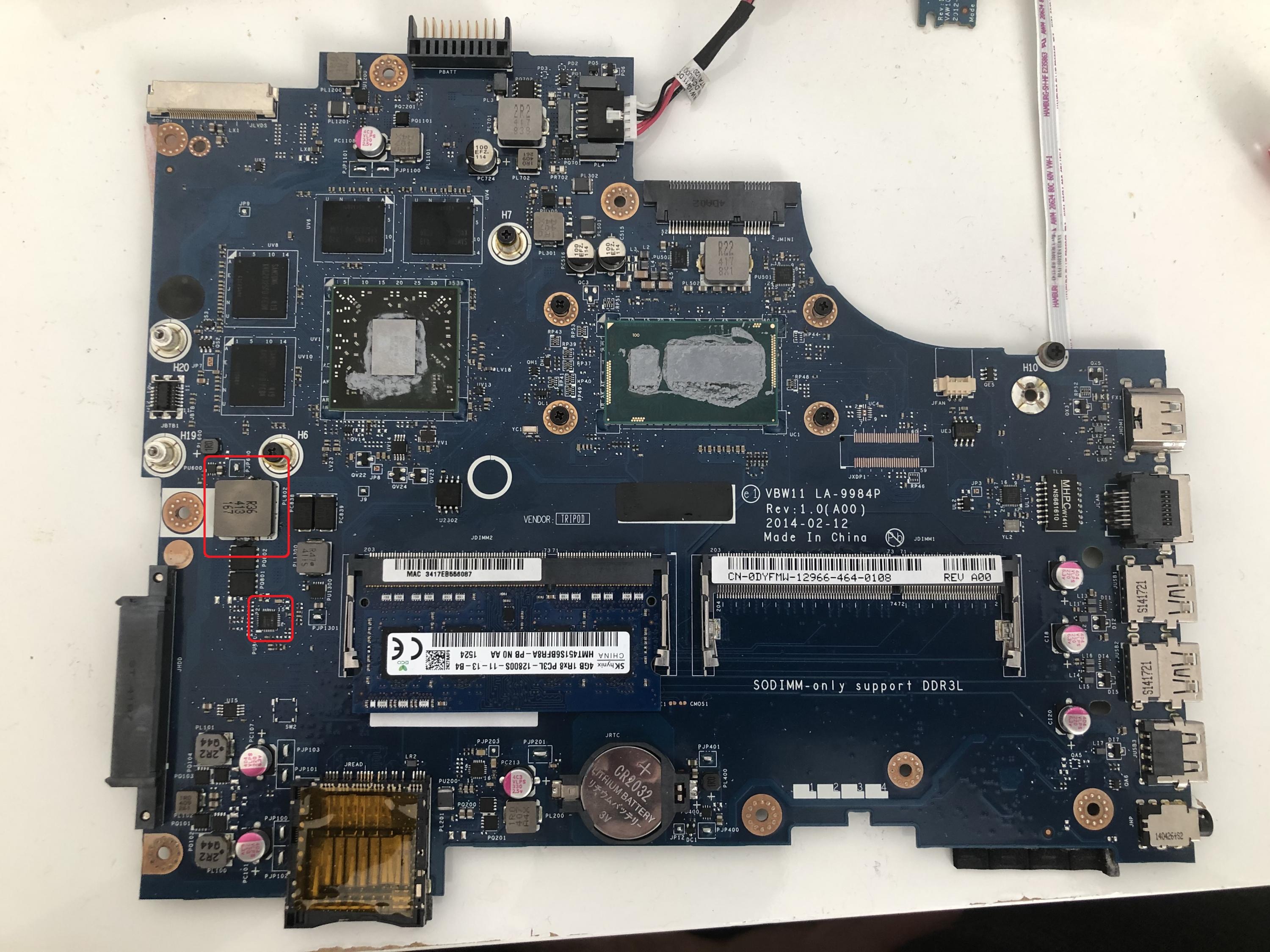

    Dell LA-9984P
    i have this motherboard.it can start and after 4-5 second automatically turn off, i tested all voltage.
    I doubted to Graphic chip. i remove PL802 , and now working. in fact without dedicated graphic chip ,motherboard working .
    i tested PU800 (Digital chip for VGA line) ,Power good pin(No,2) have 3,3v after start .and also graphic chip in this time (4-5 second) is normal warm .
    any person have idea ? i think graphic chip is ok
