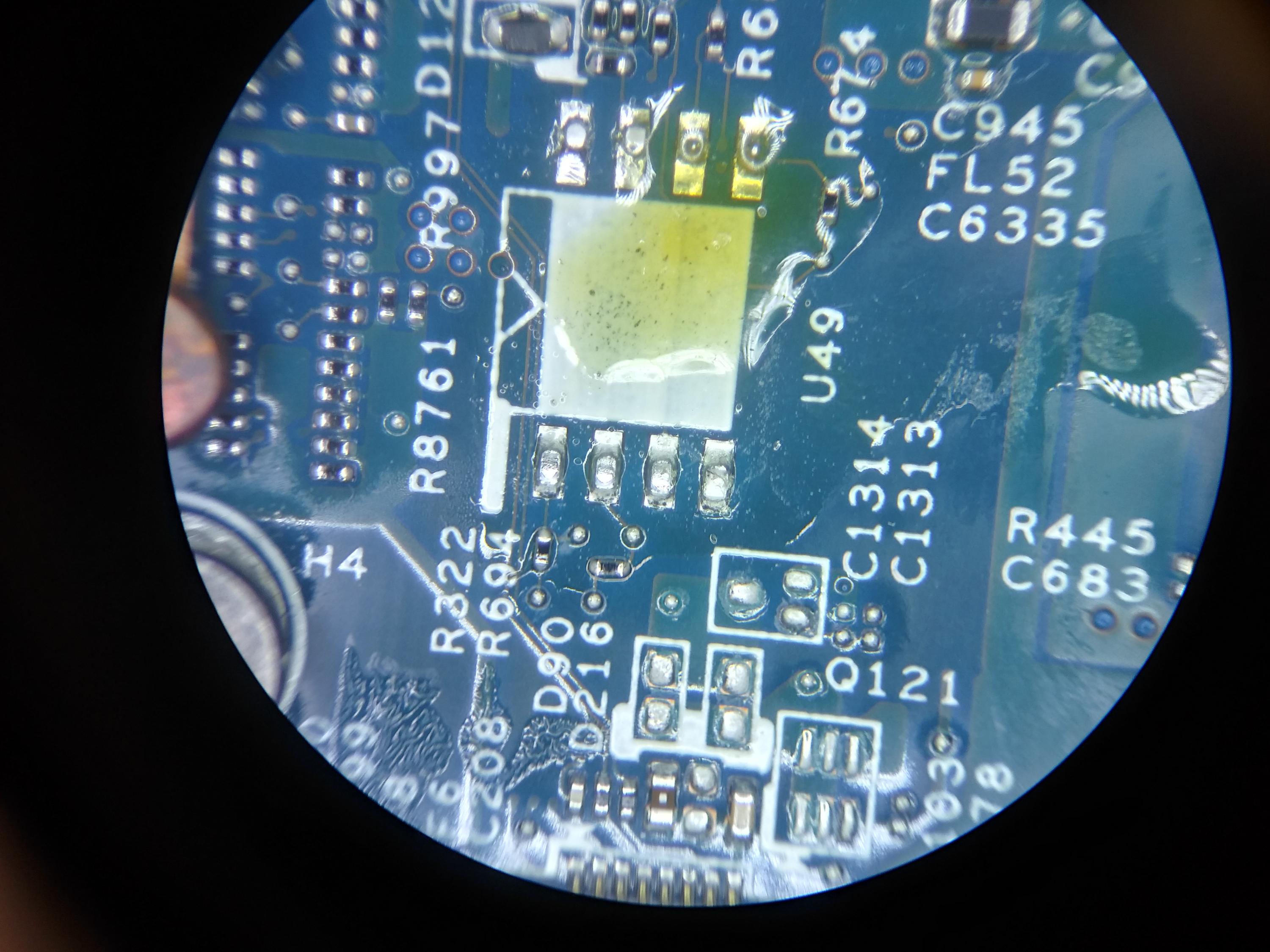

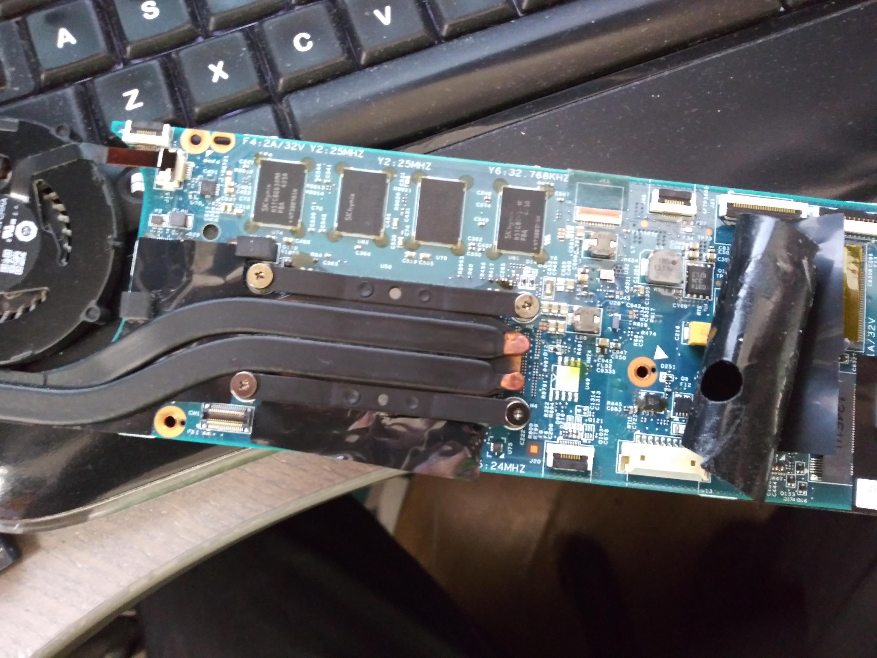

    I don't know the history of this. I bought it from someone as parts. His story was that it just quit one day and it put it away in the closet and now he is selling (I guess I paid too much.)
    Pushing the power button would light up and backlight on the touchbar (I don't remember now if the lcd backlight comes on)
    LMQ-1 12298-2
    CPU is i7-4600U
    I pull out the board and notice there is no bios chip! Schematic has two bios chips 8mb and 4mb.
    How do I figure out which one?

    what u need to figure?
    it is u49 and in your schem it is 8MB chip W25Q64FVSSIQ-GP

      Ok Thanks.
      I wrote 8mb or 4mb but it is actually 8MB or 16MB in the schematic.
      I don't know what "vpro" is, so was unsure if the board needed it.
