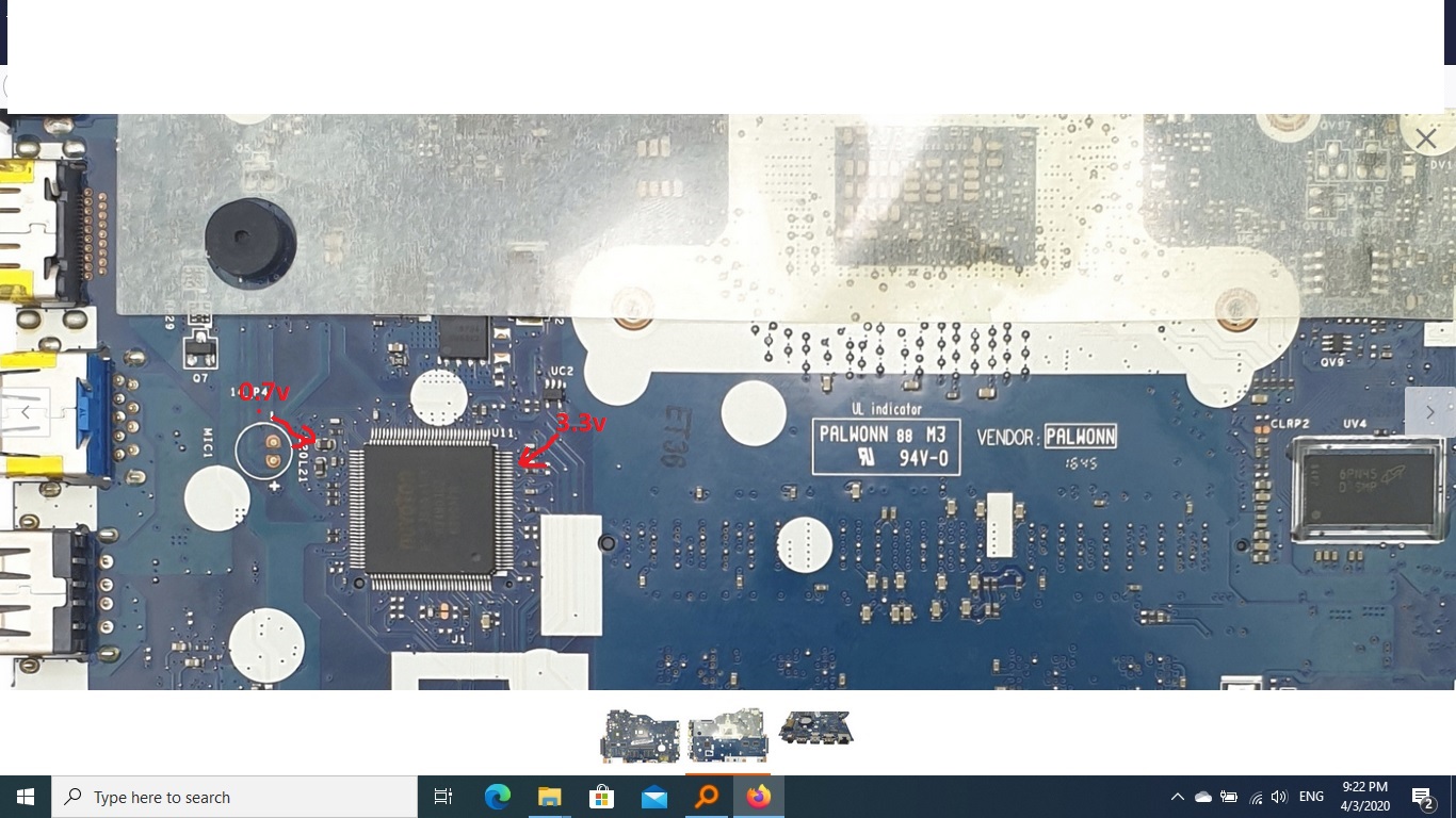

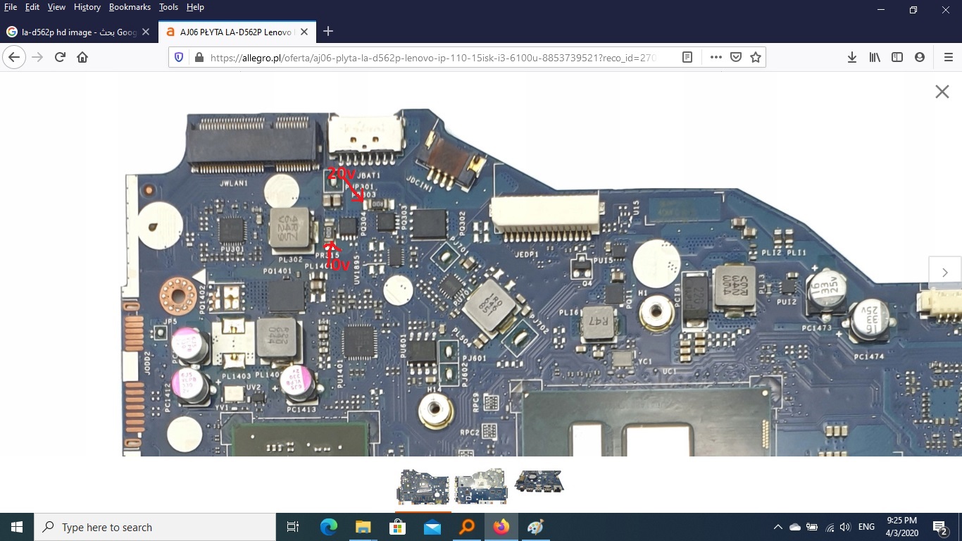

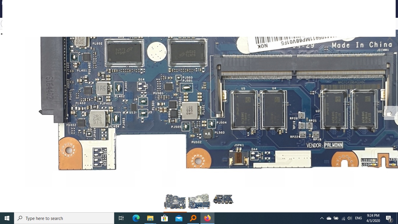

    hi all friends
    i have lenovo ideapad 110 with no power problem
    mb BIWP4/P5 .LA-D562P ddr4
    i dont have any schematics for this MB
    but i have 3 pics for the voltages on mb
    1st pic
    PR303 20V OK
    PR315/PL302 0V
    2nd pic
    pl402/pj401 0v
    pjp402 3.3v ok
    pl404/pj403 0v
    pjp404 5.06v ok
    PL402/PL404 is not shorted with GND
    3rd pic
    L20 0.7V not shorted with GND
    u11 nuvoton pin 29 3.1 v
    POWER BUTTON 0.7v
    can any one help me plz ?
    thanks for all
