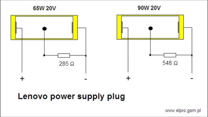

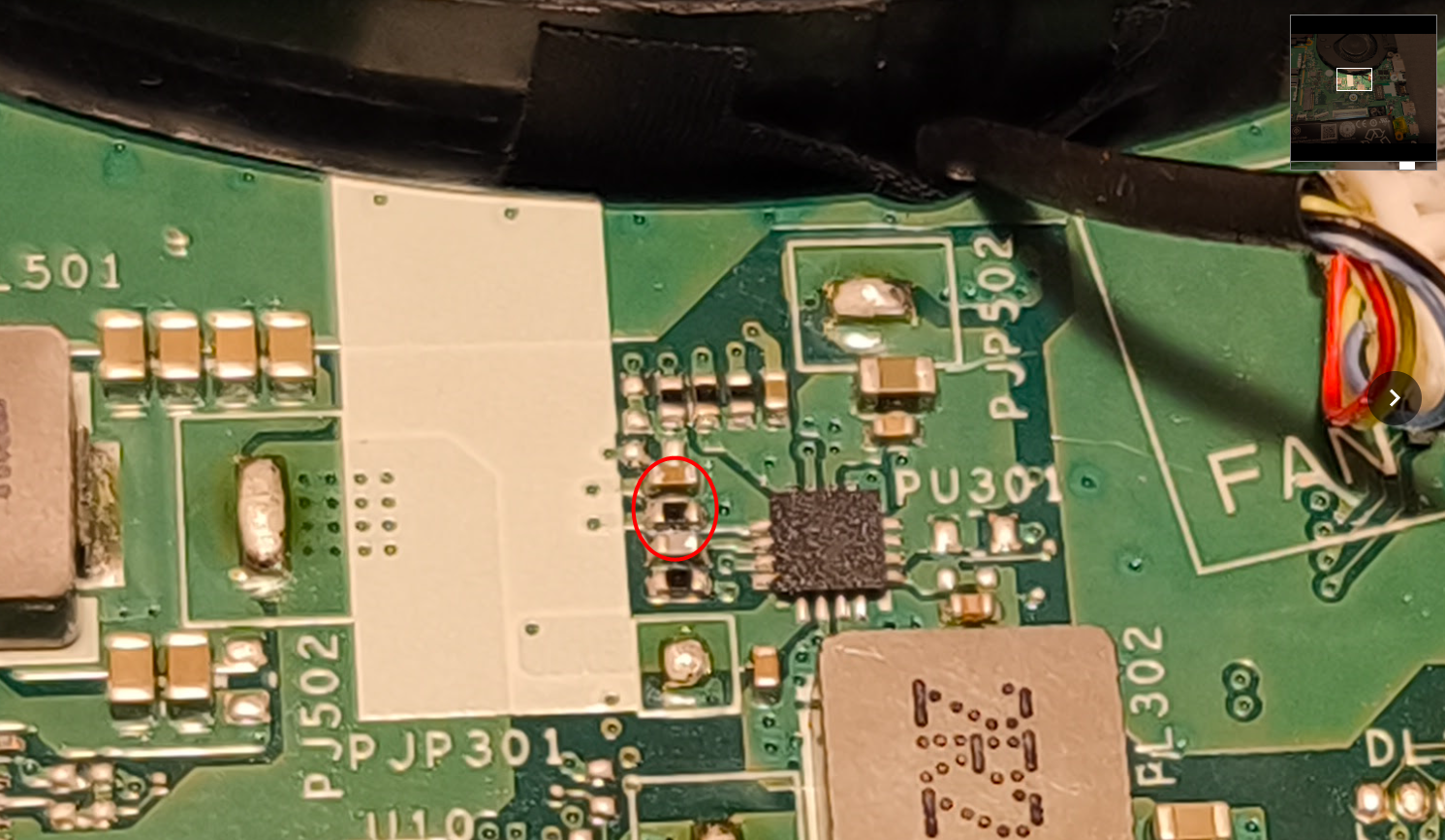

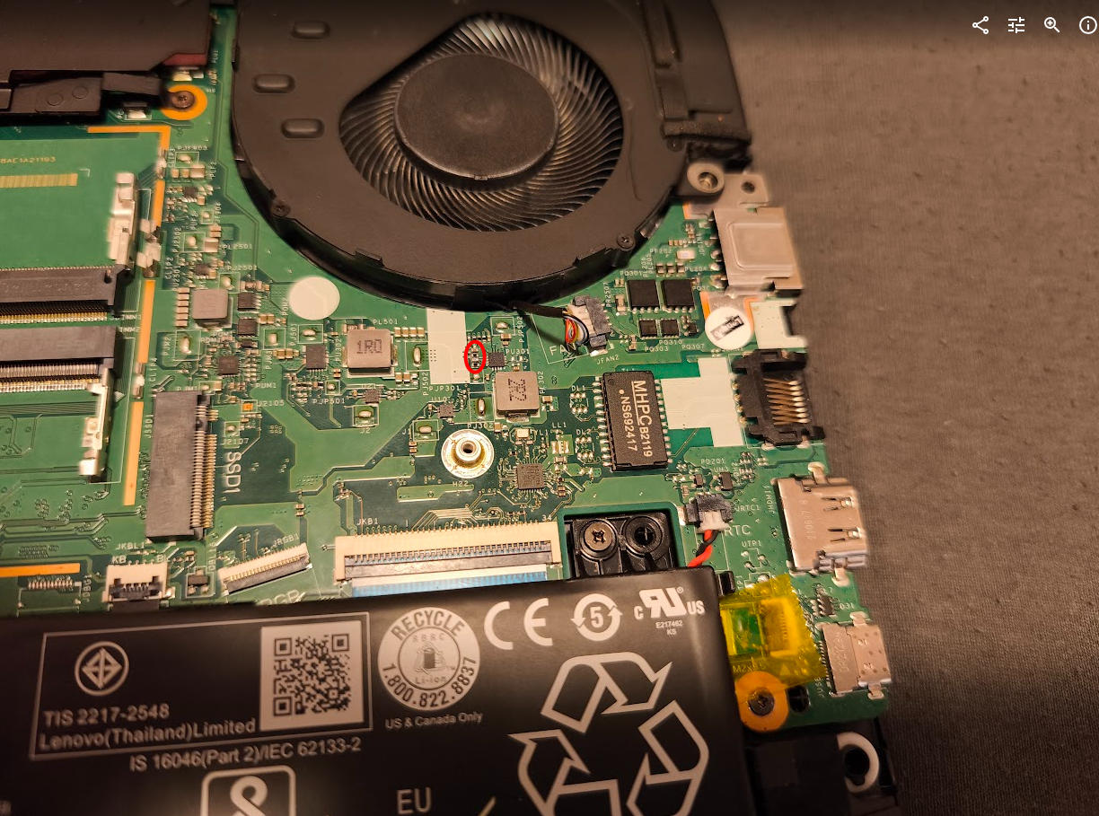

What's strange is that the charger protection doesn't kick in now — when I connect it to the laptop, it constantly outputs voltage, and there is voltage on the correct pins in the charging port. There is no short circuit at the charging port itself. I've noticed that when the charger is plugged in, some small components – and due to my limited electronics knowledge I’m not sure what they are... capacitors? resistors? – get very hot (I’m attaching a photo pointing out these components).
