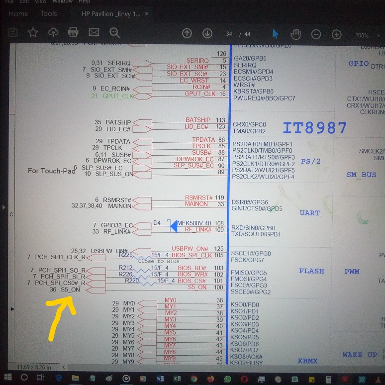

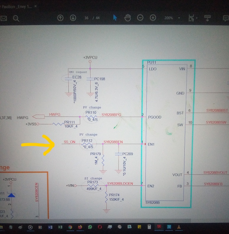

    I have this HP Pavilion 15-P (Y11A) with no power either through Battery or AC adapter. S5_ON is not present.
    Initially, there was a partial short on PD10. After replacing PD10, short was gone. Now, 5VS5 is present, but 3VS5 is not present.
    Please, what can be done?

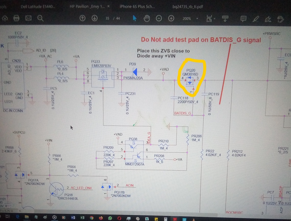

    Also, no voltage at Pin 1 and Pin 3 of PQ20.
    I have replaced PQ20 with a known working one, while the one i removed is working on another board too.

        Re: HP Pavilion 15-P (Y11A) no power, S5_ON not present
        first check the voltage of PU1 pin 20 5 4 6 ? Gate of PQ20 need 24V to by pass voltage to PR211

            Originally posted by ktmmotocross
            must i search for schematic or u upload it here?
            I'm sorry, here it is
                  Originally posted by classicandy
                  PU1
                  Pin 20 = 20.0v
                  Pin 5 = 2.95v
                  Pin 6 = 2.68v
                  Pin 4 = 0.00
                  BQ24738 pin 4 ACDRV is 0V means PQ20 Voltage will not flowit shoud be 24V, pin 4 of PU1 impedance ? PQ20 Gate & Drain impedance ?

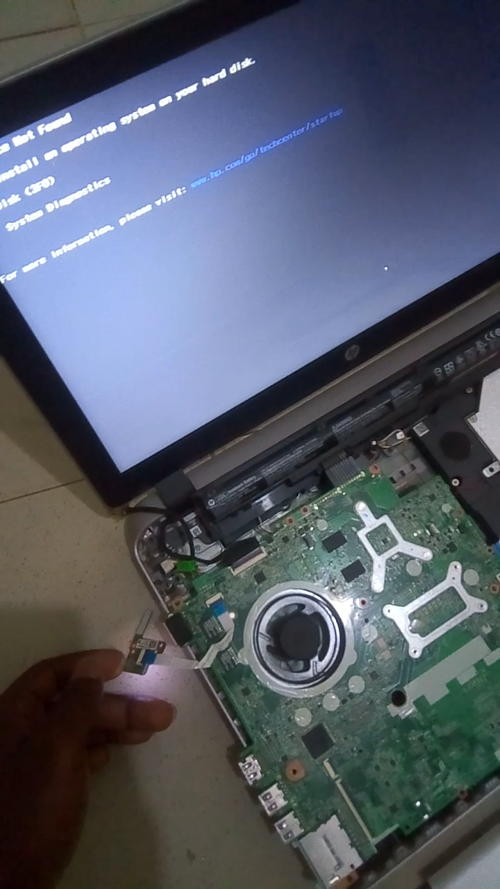

                                        After working on the system with Battery only, I've been able to get the system to power On successfully. I haven't gotten the required 90W adapter yet. It's still not powering On with the 45W adapter.
                                        It turns out two resistors were missing PR128 and PR134. After replacing those resistors, it powered On with Battery.
