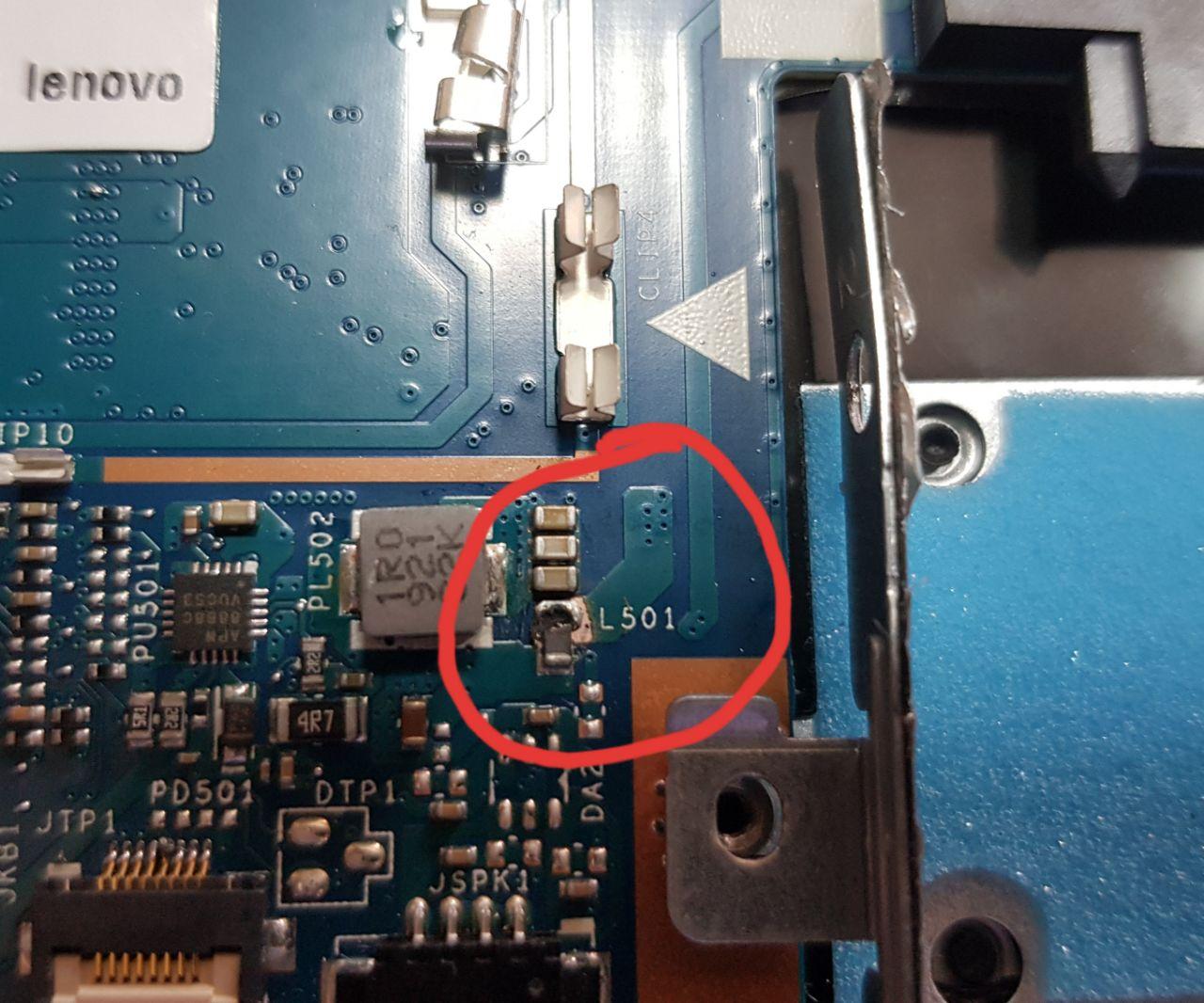

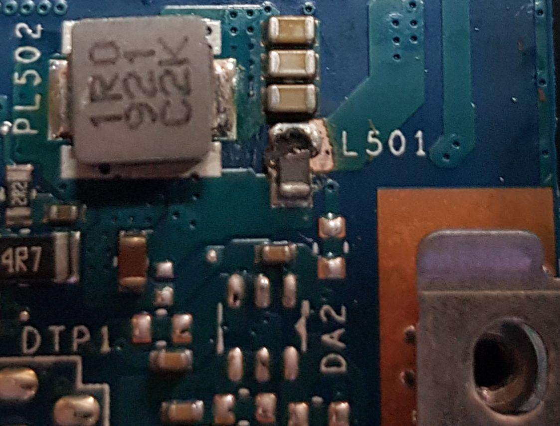

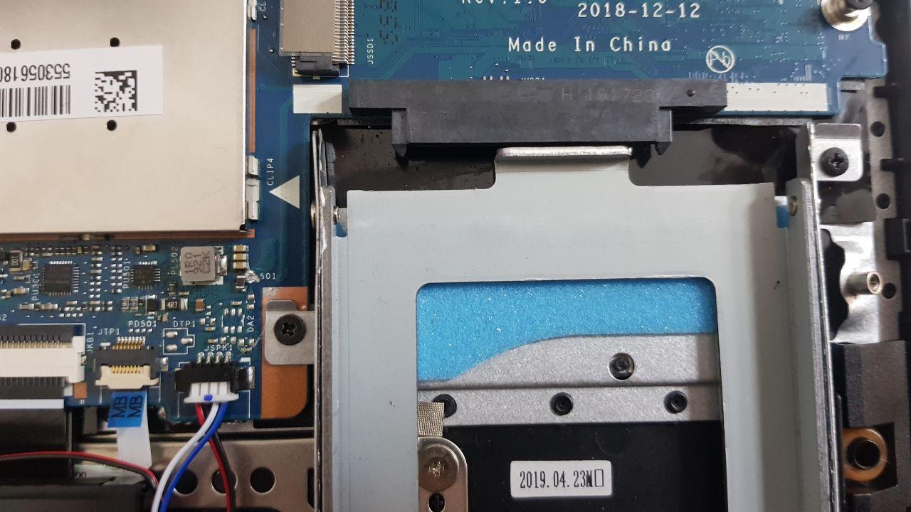

    Hi guys, i have a big problem with a probably burned motherboard (Lenovo IdeaPad s340 )...
    I accidentally forgot to remove the battery while installing an SSD and a small screw fell on the motherboard.
    I think that only one component is burnt but i don't know what is it (i can read L501 but i'm sure it's PL501 because i see another motherboard on ebay)....
    Can someone help me understand what it is?
    I can't find anywhere what PL501 is....
    This laptop is basically new and i want to repair it .
    Here some photos:
    PS: I'm not very good at English, I apologize if there are grammatical errors XD

    Re: Lenovo IdeaPad s340 burned motherboard ?
    in this case I think it is L501, make a comparison with other similar parts on the motherboard.

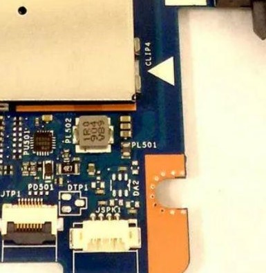

      Thanks for your reply!
      I just found the same motherboard for sale on ebay (attached) and the component is PL501.
      I would like to know what it is so i can buy this piece or replace it with something equivalent.
      • ktmmotocross
        Boardkiller
        • Feb 2014
        • 3628
        • slovakia
        oh god. it is COIL u can use any coil of same size. u can even make bridge for testing
        but first check both side of board pads for short

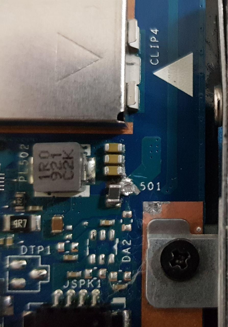

                    And.... nothing, the motherboard is definitly dead.
                    I used the component from another motherboard and it turn on for some seconds then turn off (and some weird noise from the speakers).
                    In the end it didn't toun on again and it is dead...
                    I think it's the end of this sad story
                      as i see, i think you made a short between the l501 and the first capacitor next ... check .. i hope to cheat ..
                      • ktmmotocross
                        Boardkiller
                        • Feb 2014
                        • 3628
                        • slovakia
                        damn dude. u cannot even solder? u shorted that rail to gnd like peste wrote
                        offcourse no flux

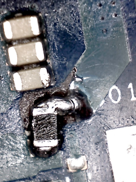

                          I checked and there is no short between the component and the first capacitor.
                          In the photo you can't see it well...
                              for me it looks 100% shorted. u did not use flux
                              • String2016
                                • Nov 2015
                                • 2238
                                • philippines
                                its shorted you soldered the coil not clean because other side touches the side of caps

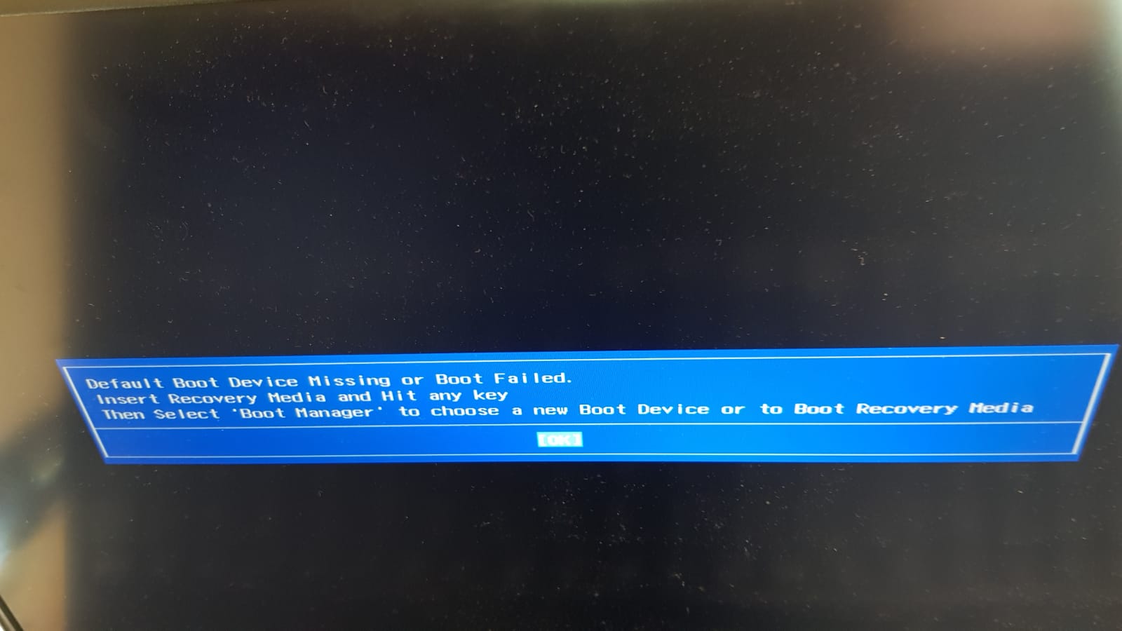

                                      A little update:
                                      ---I solder it again: i know that the result is a bit ugly (i can't go out from home because of coronavirus, so i can't buy flux paste) but the conductive rail under the component is practically destroyed, so i solder it with the rail on the top right side of the component (IMG 1).
                                      ---I measured the voltage between the PL501 and gnd and it is 12.5V (as schematics says)
                                      ---I try to turn on the pc without ram and ssd: it worked the first time (IMG 2), than i try to insert ram and ssd and it turn on (black display, only light from the power switch and nothing else)
                                      What can i do now?
                                      PS: how can i check if the three capacitors above the component are ok? maybe there is some problem there...
                                      • ktmmotocross
                                        Boardkiller
                                        • Feb 2014
                                        • 3628
                                        • slovakia
                                        just measure rezistance on both side of capacitors to ground.
                                        if u dont have ram inserted and laptor start, than u must have ram on board, so try to remove inserted ram
                                        check if u have 1.2V on pl502
