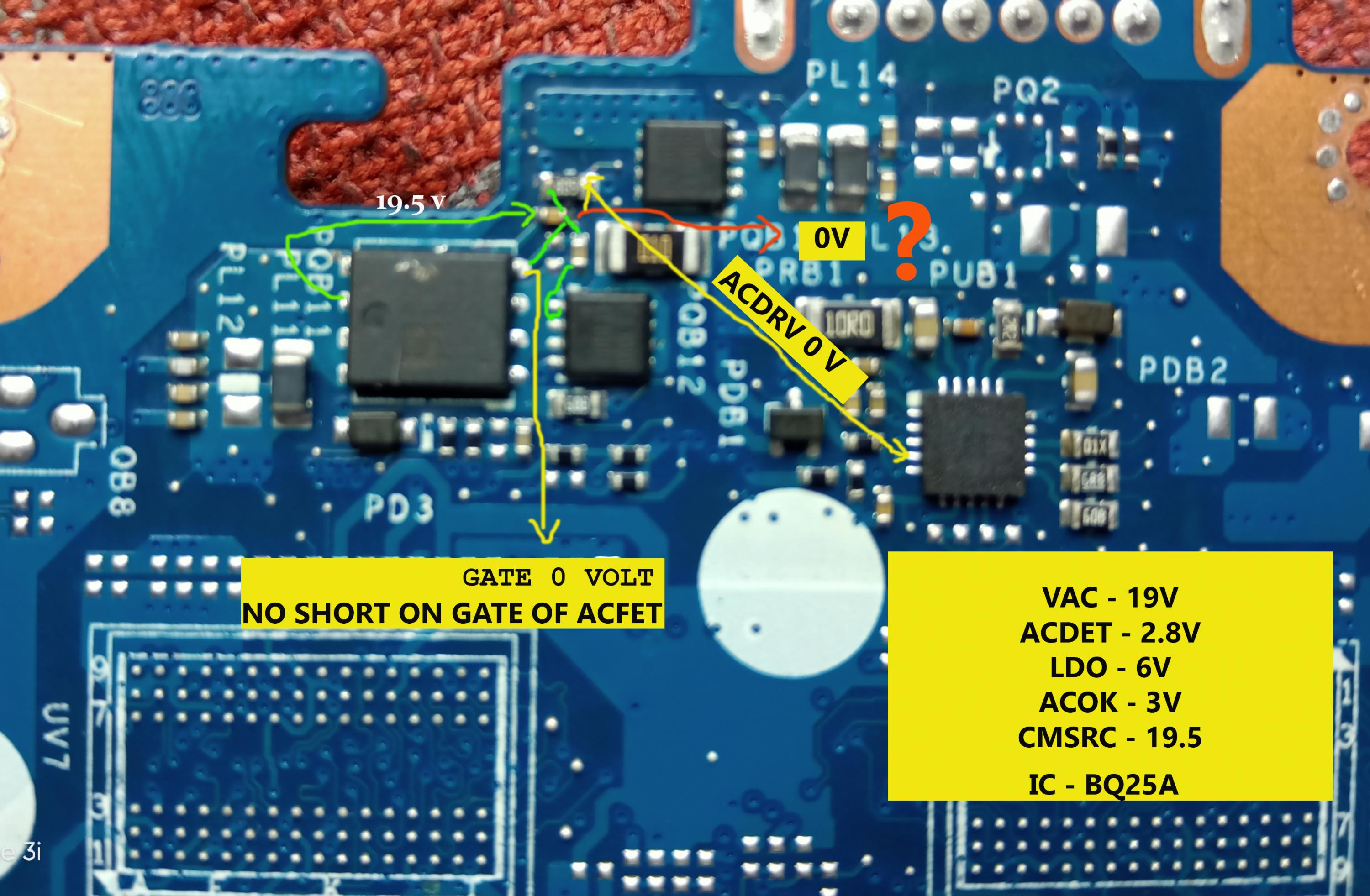

No ACDRV - Possible faulty capacitor - Pls advise
  • IamPritesh
    • Aug 2017
    • 356
    • India
    Please refer to the image . The board came with no charging ..I have replaced the charging IC Bq25A but symptoms are same. There is no schematic or boardview for the same. If the capacitor is faulty, how do I know which value capacitor should I use. Can I use a jumper ?
    Also is ACDRV an output voltage from the Charging IC? I think it should be around 25V
    If any information is missing pls let me know.
    MB : CSL50/CSL52 LA-E791P

    Re: No ACDRV - Possible faulty capacitor - Pls advise
    Check second DC-in MOSFET for short between drain/source/gate, and for short to ground.
    ACDRV is indeed a volatge generated by a charge pump inside charger IC and should be around 25V (DC-in voltagr +6V).
      Actually the ACFET [ MTB04N03] is short between drain and source .
      so which alternative mosfet can I use..? I have the following N channel mosfet in similar package
      MDU2657
      K03B9
      FDMS0312AS
      FDMS7698
        Anything that has same or higher max Vds (30V), and same or higher current rating Id.
          Replaced both the mosfet still unable to resolve ACDRV voltage is only 18.5 V
            Measure exact voltage on both DC-in MOSFETs drain/source/gate.
            Measure resistance to ground after second DC-in MOSFET.
              Check current sensing resistor if its short to ground
                18.5V at ACDRV means there is still a shorted DC-IN Mosfet present. I didn't noticed any other reason so far.
                  No doubt about it. Bang on.
