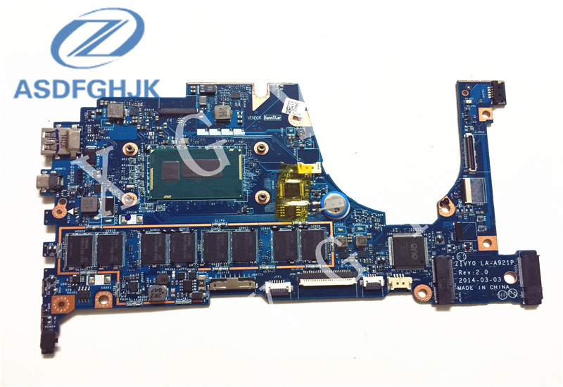

Lenovo Yoga2 13 (Boot Problem )
  • kokono
    • Jun 2018
    • 203
    Have a nice time
    i receive this Laptop by a defect usb port but laptop can start to bios . i change defect usb port but it dont can boot of USB or HDD .when i force it to boot of a usb windows 10, Reset quickly and again this process. Also HDD
    i have DDR3 onboard in motherboard, anyone have experience with this?
    PCH onboard in cpu ist problem or Ram ?
  • mcplslg123
    • Jun 2015
    • 7262
    • india
    Re: Lenovo Yoga2 13 (Boot Problem )
    What is the resistance on D+ and D- on usb port??
    • kokono
      • Jun 2018
      • 203
      About 1M ohm
      • Vesko356
        VIP Moderator
        • Aug 2018
        • 4386
        • Bulgaria 🇧🇬
        Disconnect the ribbon cable from the main board to the small (usb, audio, card reader) board, and try again. Also check 5V on the main board usb port.
