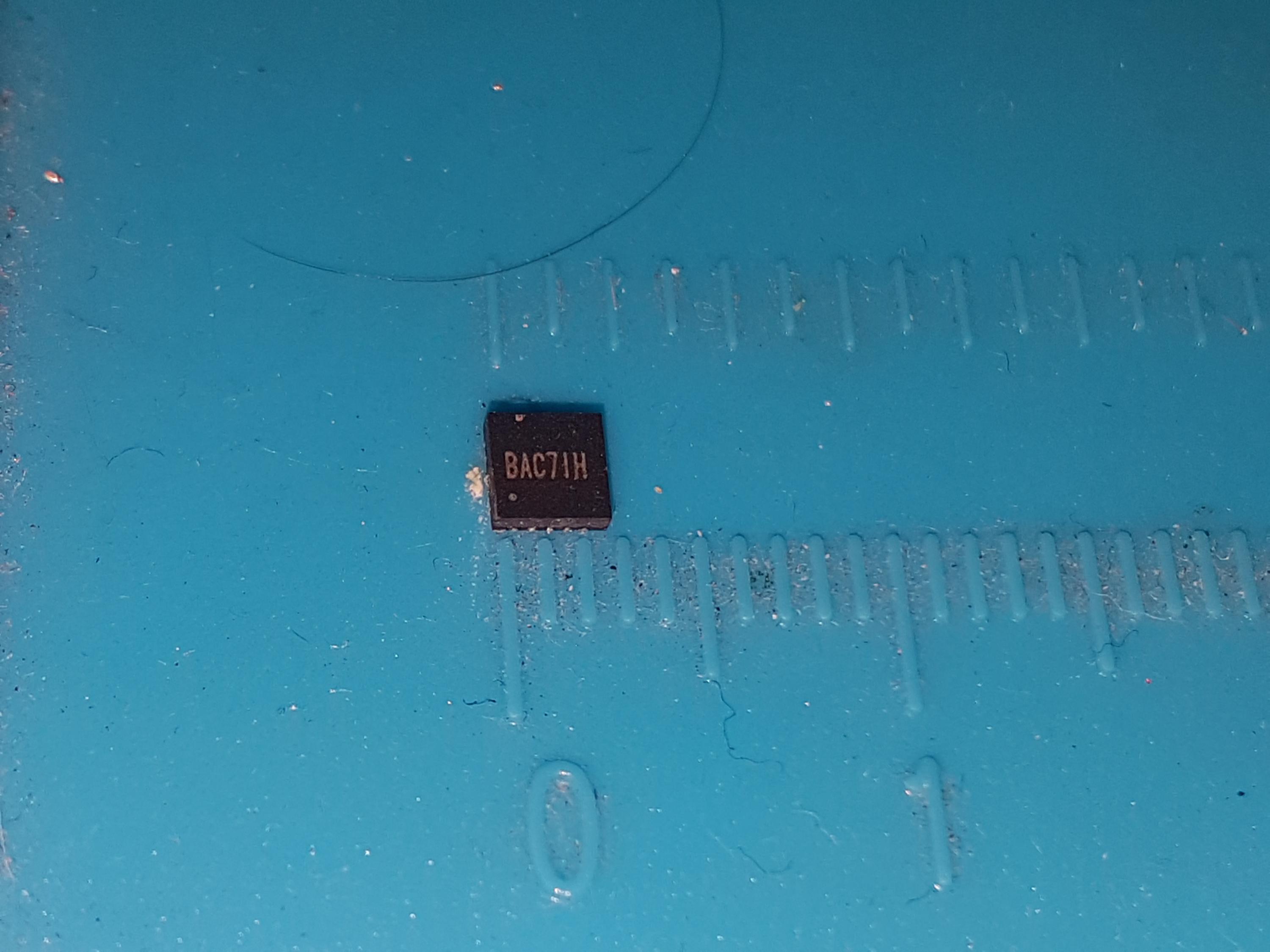

    Hi guys, grateful if anyone can help with identifying part number of the following IC.
    Laptop: HP pavilion X360 convertible
    Motherboard: Bucks_NVDIS_MB; 16871-1; 448.0BZ03.0011
    IC marking: BAC71H
    Location on board: PU4502
    I can't seem to find schematic for this motherboard but reversing the tracks I am fairly confident its the IC responsible to produce 5V.

    Re: Help with Component identification.
    Its a Silergy SY8288CRAC i think .

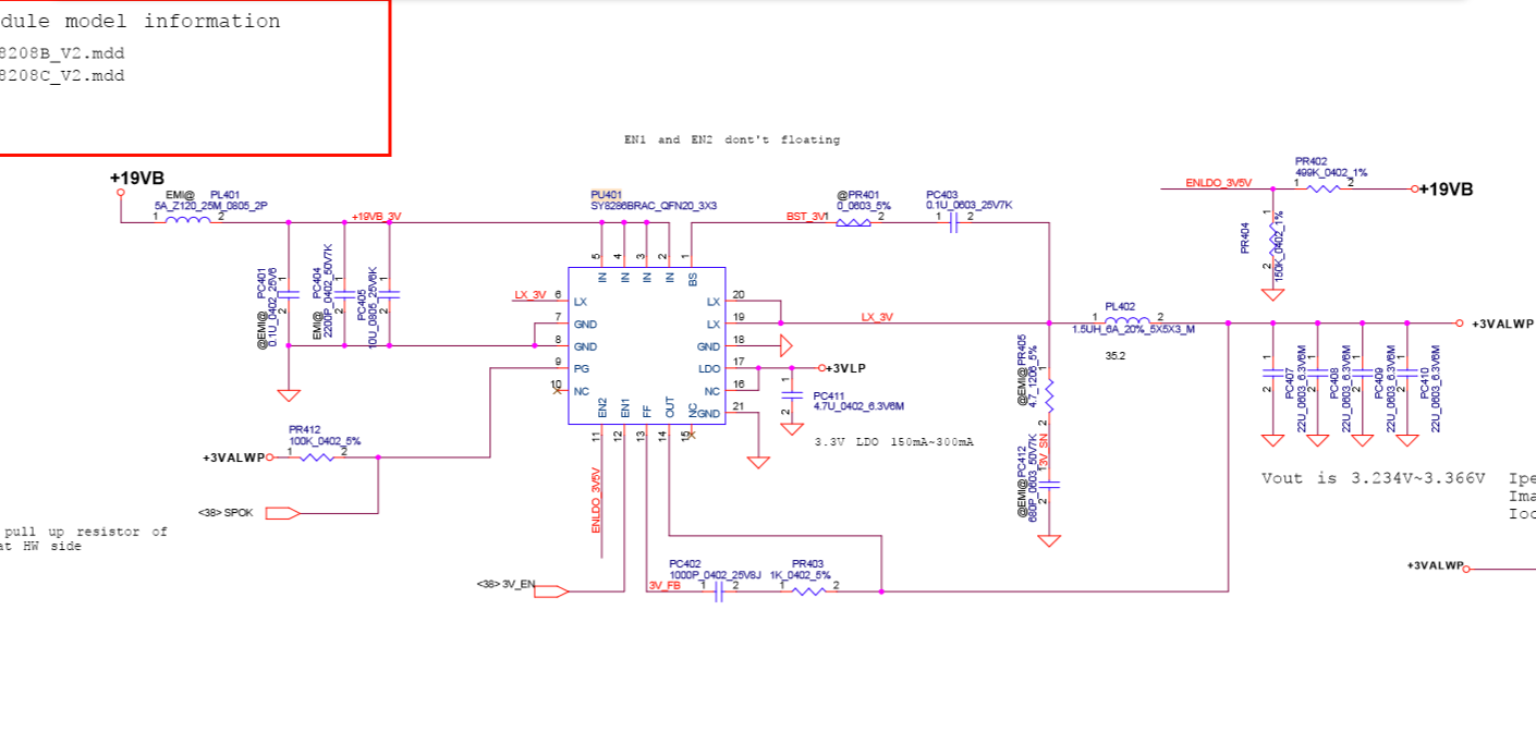

      Thank you!!! Pin mapping looks to be same. Any idea about the other IC? Most likely it'll be the 3.3V.
      Attached is the connection diagram of the SY8288CRAC if anyone needs it.
        It seems the AWV7EE could be SY8286BRAC. Grateful if anyone can confirm same.
          • 20498
          SY8286BRAC maybe.
          Edit: yes i agree its a SY8286BRAC
            Great! Attached is connection diagram for SY8286BRAC if anyone needs it.
