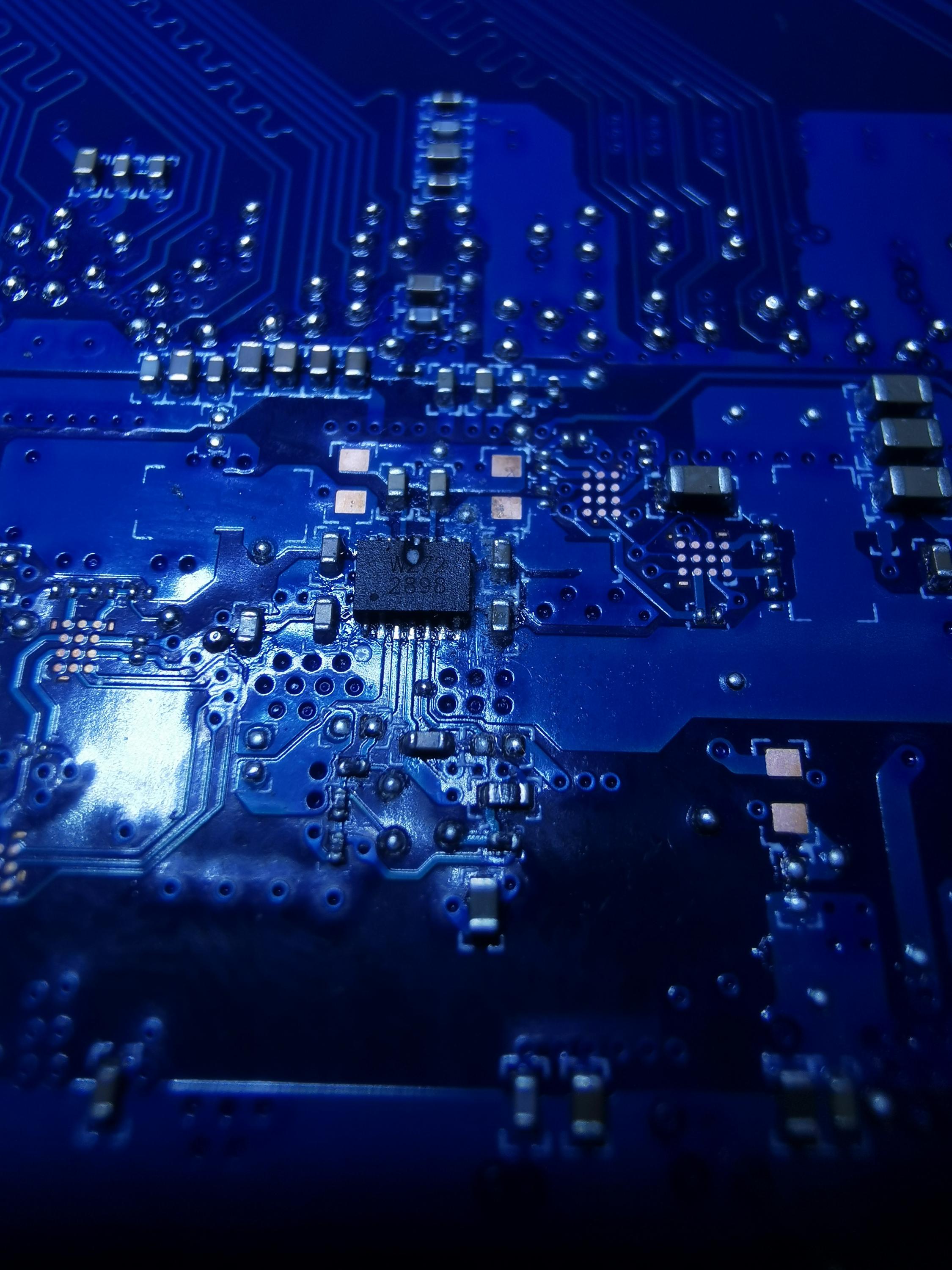

    Hi Guys
    I ahev a HP with motherboard X9M
    Heating a lot under thermal camera, i found burn component with 14 legs with markinn W272 2898
    I cant schematic or any related number on the google
    Can anybody help ,please

    Re: Component identification
    Post a clear and close up pic of the top side of this component for a review.

      Re: Component identification with marking W272 2898
      there you guys , any help appreciated
        Share any silk screen markings from the logic board.
          what u mean ?
            • 21853
            Originally posted by CZAJOSEK
            what u mean ?
            Quanta X9M DA0X9MMB8F0
              Rev.F
                It could be a GMT G2898KD1U load switch
                Datasheet -> https://cdn.badcaps-static.com/pdfs/...818973bb1c.pdf
                The Quanta X9M schematic is available on some paid sites, if you request it in the Schmeatic requests section someone might post it
