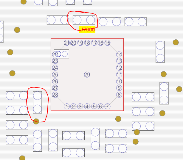

    MacBook Pro 2010 820-2879-B won't start
    I got a broken MBP here. The PSU-LED is on green when connected and the orange when the battery is connected. So it is charging. Now when I press the power button or shortage the Power-On-Pads on the logicboard, the fan starts to rotate for a split second. Looks like the power immediately breaking down.
    I just downloaded the schematics and the brd-file of the board.
    Are there some known issues whit that board? This behaviour look familiar, the 17" 2008 and 2009 had this also whit the C7771 Cap which powered the GPU, but the 13" does not have a dedicated GPU.
    What could it be? What to measure next?

        Re: MacBook Pro 2010 820-2879-B won't start
        Sounds strange. Look closely on the board for any liquid damage, damaged or knocked of component.
        You don't need a battery to troubleshoot it. Not even RAM if it's shutting down right away.
        If there is no hint at all, first measure resistance to ground on PP3V42_G3H (board cold, all power drained from it, can give a clue about a dead MCP).
        Then check charging circuit current sensing (resistance between pins 17/18 and 27/28 of U7000).
          So here am i again, and finally had some time to experiment a little.
          So PP3V42_G3H to ground resistance is kind of rising. Stated with 160 Ohm and now after some minutes it is on 1.25KOhm.
          But what do you mean with the last measuring?
          The 2 resistors are those two in the red circle.
          On point CHGR_CSI_P (pin 28) I have 16V and on CHGR_CSO_P (Pin 18) i have 12V.
          Battery is charging. It is just not turning on.
            Measuring resistance between the 2 sets of mentioned pins of U7000.
            Anyway resistance to ground for PP3V42_G3H doesn't look good. Make sure all power is disconnected and let the board sit for a short while to be sure it is fully discharged and cold then check again.
              OK. after some time without any power on it i get 17,3KOhm at the PP3V42_G3H.
              And between pin 18 and 28 on the U7000 i got 60 KOhm
                17.3 kohm to ground on PP3V42_G3H sounds more reasonable. Should be a bit higher but probably still ok.
                It is between pins 17 and 18 on the one hand, and between pins 27 and 28 on the other hand.
                  Ah, ok. I got those 2 now.
                  17-18 = 3.2 Ohm
                  27-28 = 20.7 Ohm
